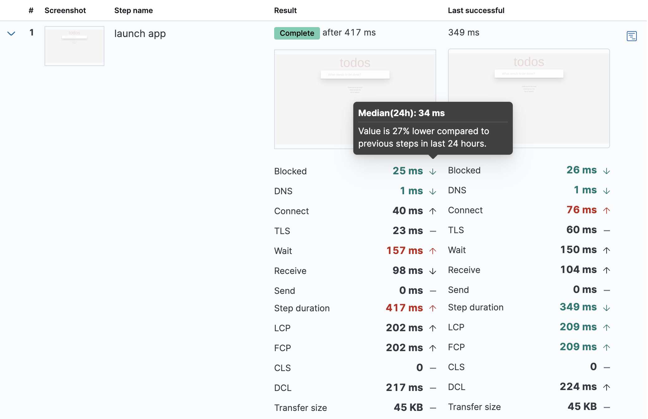

Click the icon next to the step number to show details.
The details include metrics for the step in the current run and the step in the last successful run.
Read more about step-level metrics below in Timing and
Metrics.
This is particularly useful to compare the metrics for a failed step to the last time it completed successfully when trying to diagnose the reason it failed.

Timingedit
The Timing visualization shows a breakdown of the time spent in each part of the resource loading process for the step including:
- Blocked: The request was initiated but is blocked or queued.
- DNS: The DNS lookup to convert the hostname to an IP Address.
- Connect: The time it took the request to connect to the server. Lengthy connections could indicate network issues, connection errors, or an overloaded server.
- TLS: If your page is loading resources securely over TLS, this is the time it took to set up that connection.
- Wait: The time it took for the response generated by the server to be received by the browser. A lengthy Waiting (TTFB) time could indicate server-side issues.
- Receive: The time it took to receive the response from the server, which can be impacted by the size of the response.
- Send: The time spent sending the request data to the server.
Next to each network timing metric, there’s an icon that indicates whether the value is
higher (),
lower (
or the same (
compared to the median of all runs in the last 24 hours.
Hover over the icon to see more details in a tooltip.
This gives you an overview of how much time is spent (and how that time is spent) loading resources. This high-level information may not help you diagnose a problem on its own, but it could act as a signal to look at more granular information in the Network requests section.
![Network timing visualization for one step in a browser monitor in the Synthetics app](images/synthetics-analyze-one-step-timing.png)
