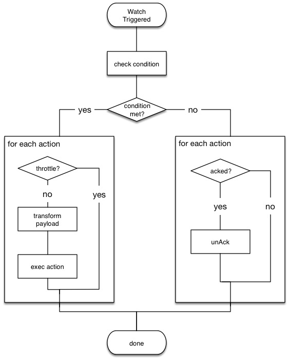

When a watch is triggered, Watcher queues it up for execution. A watch_record
document is created and added to the watch history and the watch’s status is set
to awaits_execution.
When execution starts, Watcher creates a watch execution context for the watch. The execution context provides scripts and templates with access to the watch metadata, payload, watch ID, execution time, and trigger information. For more information, see Watch Execution Context.
During the execution process, Watcher:
- Loads the input data as the payload in the watch execution context. This makes the data available to all subsequent steps in the execution process. This step is controlled by the input of the watch.
Evaluates the watch condition to determine whether or not to continue processing
the watch. If the condition is met (evaluates to
true), processing advances to the next step. If it is not met (evaluates tofalse), execution of the watch stops. - Applies transforms to the watch payload (if needed).
- Executes the watch actions granted the condition is met and the watch is not throttled.
When the watch execution finishes, the execution result is recorded as a Watch Record in the watch history. The watch record includes the execution time and duration, whether the watch condition was met, and the status of each action that was executed.
The following diagram shows the watch execution process:
