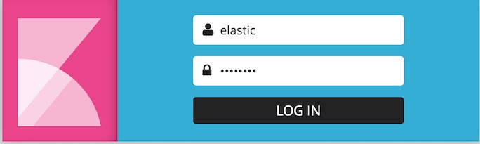

  3. Restart Kibana and verify that you can log in as a user. If you are running Kibana locally, go to https://localhost:5601 and enter the credentials for a user you’ve assigned a Kibana user role. For example, you could log in as the jacknich user created above.
    Kibana Login
    This must be a user who has been assigned the kibana_user role. Kibana server credentials should only be used internally by the Kibana server.
