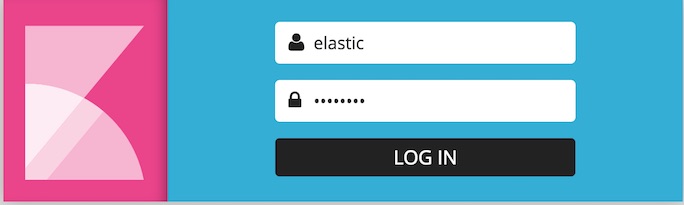

Restart Kibana and verify that you can log in as a user. If you are running Kibana locally, go to
https://localhost:5601
and enter the credentials for a user you’ve assigned a Kibana user role. For example, you could log in as thejacknich
user created above.This must be a user who has been assigned the
kibana_user
role. Kibana server credentials should only be used internally by the Kibana server.
