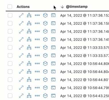

Animation of adding an alert to a case
Add alerts to a new case
To add alerts to a new case:
  1. Do one of the following:
    • To add a single alert to a case, select the More actions menu (…​) in the Alerts table or Take action in the alert details flyout, then select Add to a new case.
    • To add multiple alerts, select the alerts, then select Add to a new case from the Bulk actions menu.
