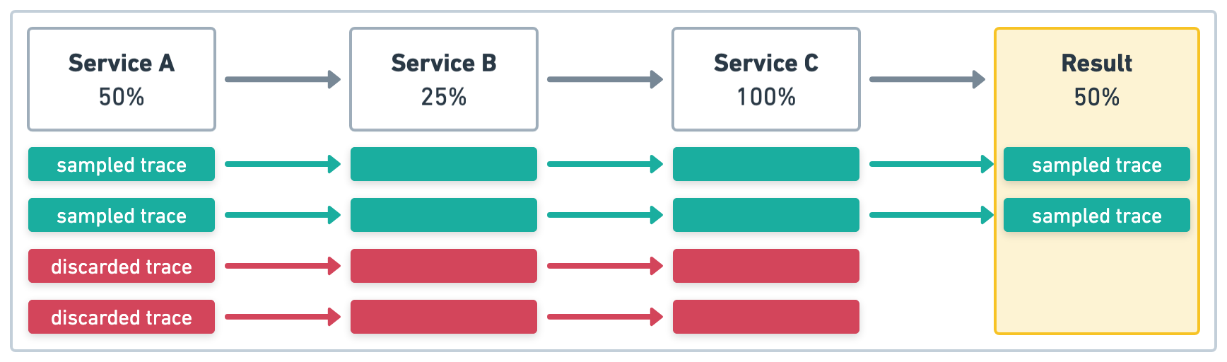

In the example in Figure 1, Service A initiates four transactions and has a sample rate of .5 (50%). The upstream sampling decision is respected, so even if the sample rate is defined and is a different value in Service B and Service C, the sample rate will be .5 (50%) for all services.
Figure 1. Upstream sampling decision is respected

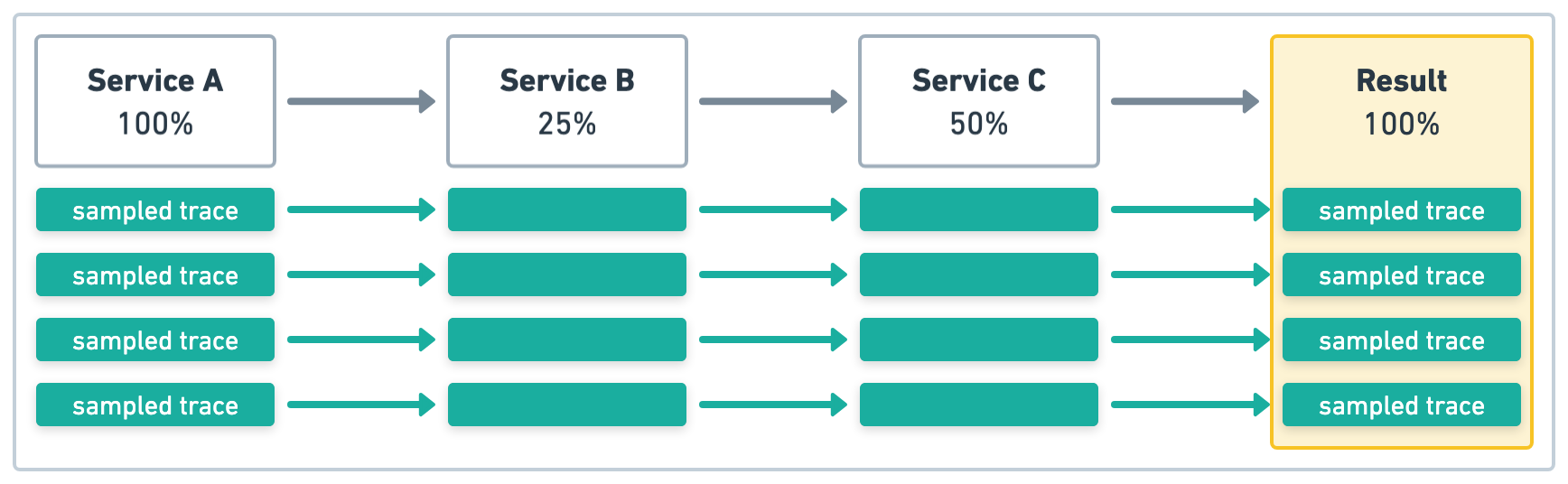

In the example in Figure 2, Service A initiates four transactions and has a sample rate of 1 (100%). Again, the upstream sampling decision is respected, so the sample rate for all services will be 1 (100%).
Figure 2. Upstream sampling decision is respected

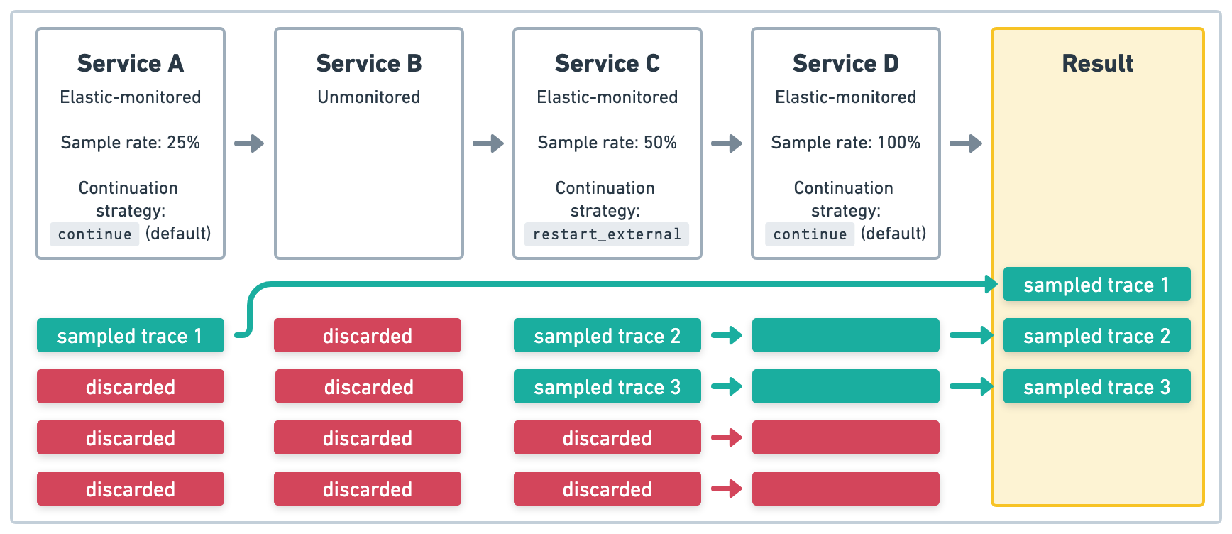

Use the restart_external trace continuation strategy on an Elastic-monitored service to start a new trace if the previous service did not have a traceparent header with es vendor data. This can be helpful if a transaction includes an Elastic-monitored service that is receiving requests from an unmonitored service.
In the example in Figure 3, Service A is an Elastic-monitored service that initiates four transactions with a sample rate of .25 (25%). Because Service B is unmonitored, the traces started in Service A will end there. Service C is an Elastic-monitored service that initiates four transactions that start new traces with a new sample rate of .5 (50%). Because Service D is also Elastic-monitored service, the upstream sampling decision defined in Service C is respected. The end result will be three sampled traces.
Figure 3. Using the restart_external trace continuation strategy

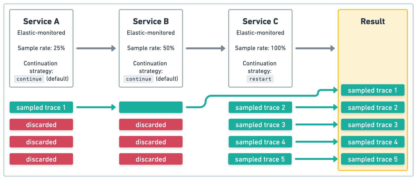

Use the restart trace continuation strategy on an Elastic-monitored service to start a new trace regardless of whether the previous service had a traceparent header. This can be helpful if an Elastic-monitored service is publicly exposed, and you do not want tracing data to possibly be spoofed by user requests.
In the example in Figure 4, Service A and Service B are Elastic-monitored services that use the default trace continuation strategy. Service A has a sample rate of .25 (25%), and that sampling decision is respected in Service B. Service C is an Elastic-monitored service that uses the restart trace continuation strategy and has a sample rate of 1 (100%). Because it uses restart, the upstream sample rate is not respected in Service C and all four traces will be sampled as new traces in Service C. The end result will be five sampled traces.
Figure 4. Using the restart trace continuation strategy
