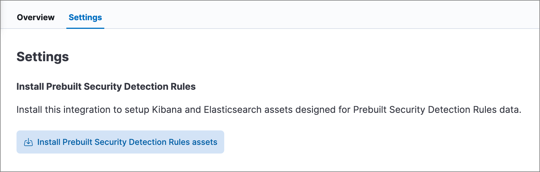

  1. In Kibana, go to Management → Integrations.
  2. Search for "Prebuilt Security Detection Rules."
  3. Select the integration, then select the Settings tab. The integration settings page is displayed.
    install prebuilt settings

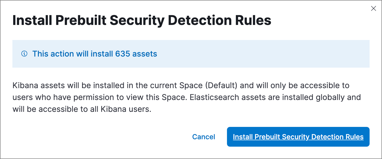

  4. Click Install Prebuilt Security Detection Rules assets.
  5. Click Install Prebuilt Security Detection Rules to confirm the installation.
    install prebuilt rules

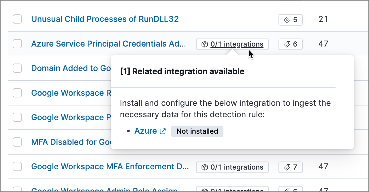

Many Elastic prebuilt rules are designed to work with specific Elastic integrations and data fields. These prerequisites are identified in the Related integrations and Required fields fields on a rule’s details page (Detect → Rules, then click a rule’s name). Related integrations also displays each integration’s installation status and includes links for installing and configuring the listed integrations.
Additionally, the Setup guide section provides guidance on setting up the rule’s requirements.
Rule details page with Related integrations
You can also check rules' related integrations in the Rules and Rule Monitoring tables. Click the integrations badge to display the related integrations in a popup.
Rules table with related integrations popup
You can hide the integrations badge in the Rules tables. Go to Kibana → Stack Management → Advanced Settings, then turn off securitySolution:showRelatedIntegrations.
