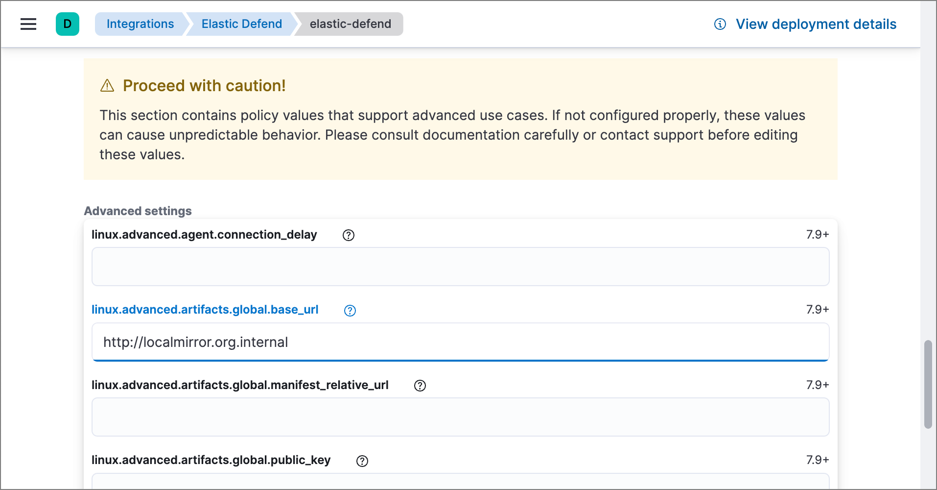

editSet the advanced.artifacts.global.base_url advanced setting for each Elastic Defend integration policy that needs to use the mirror. Note that there’s a separate setting for each operating system:
linux.advanced.artifacts.global.base_url -
mac.advanced.artifacts.global.base_url -
windows.advanced.artifacts.global.base_url

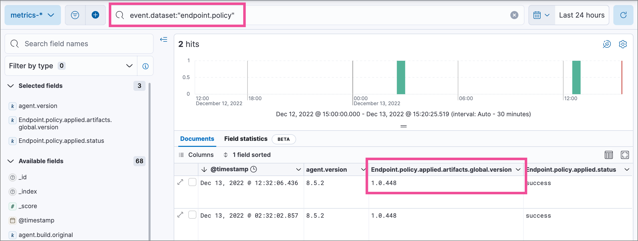

editEach new global artifact update release increments a version identifier that you can check to ensure that Elastic Endpoint has received and installed the latest version.
To confirm the latest version of the artifacts for a given Elastic Endpoint version, check the published version. This example script checks the version:
curl -s https://artifacts.security.elastic.co/downloads/endpoint/manifest/artifacts-8.10.4.zip | zcat -q | jq -r .manifest_version
Replace https://artifacts.security.elastic.co in the command above with your local mirror server to validate that the artifacts are served correctly.
After updating the Elastic Endpoint configuration to read from the mirror server, use Kibana’s Discover view to search the metrics-* data view for endpoint.policy response documents, then check the installed version (Endpoint.policy.applied.artifacts.global.version) and compare with the output from the command above:
