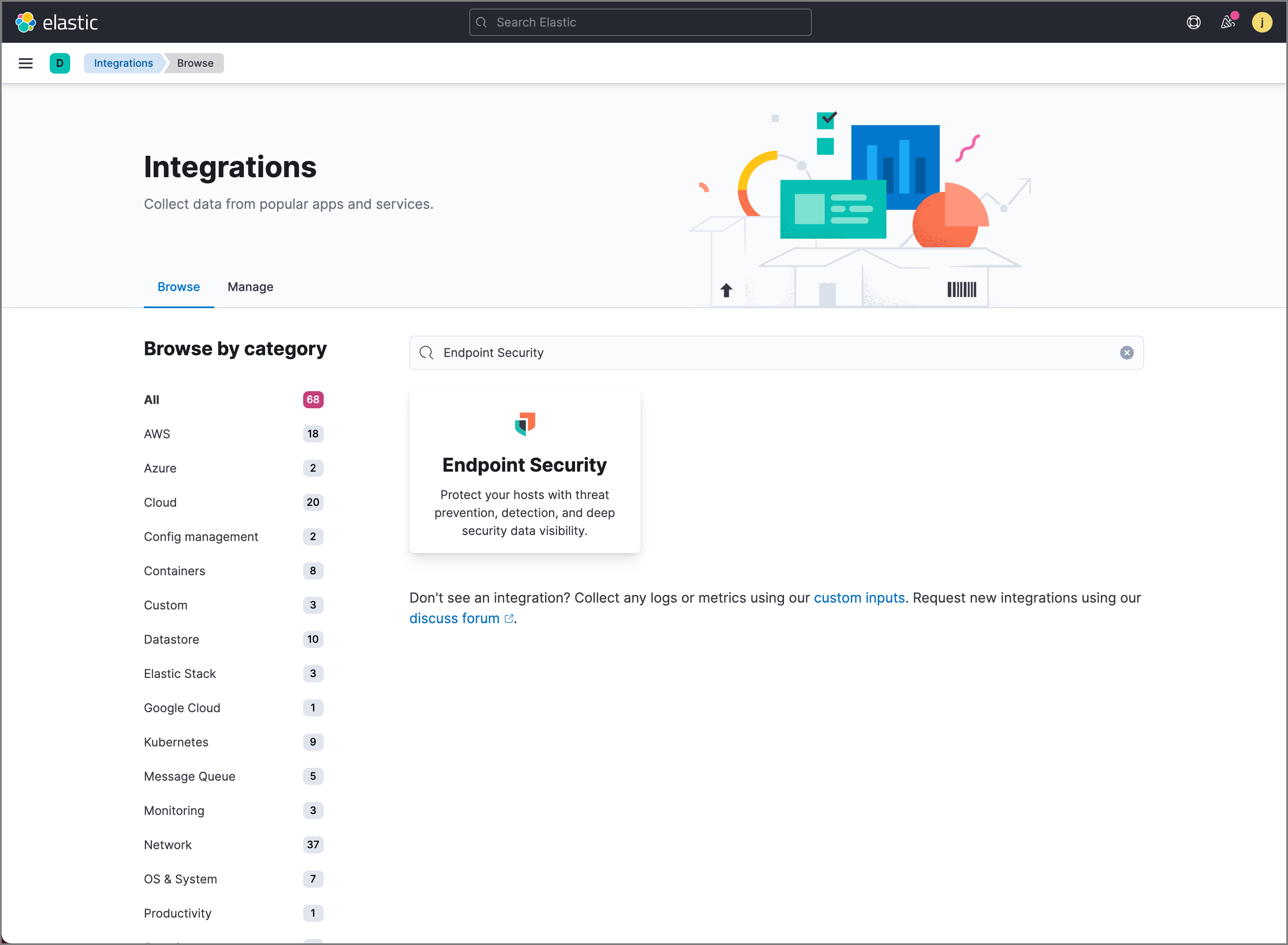

  1. In Kibana, select SecurityEndpoints. If this is not your first time using Elastic Security, select ManagementIntegrations and search for "Endpoint Security."
    Search result for "Endpoint Security" on the Integrations page.

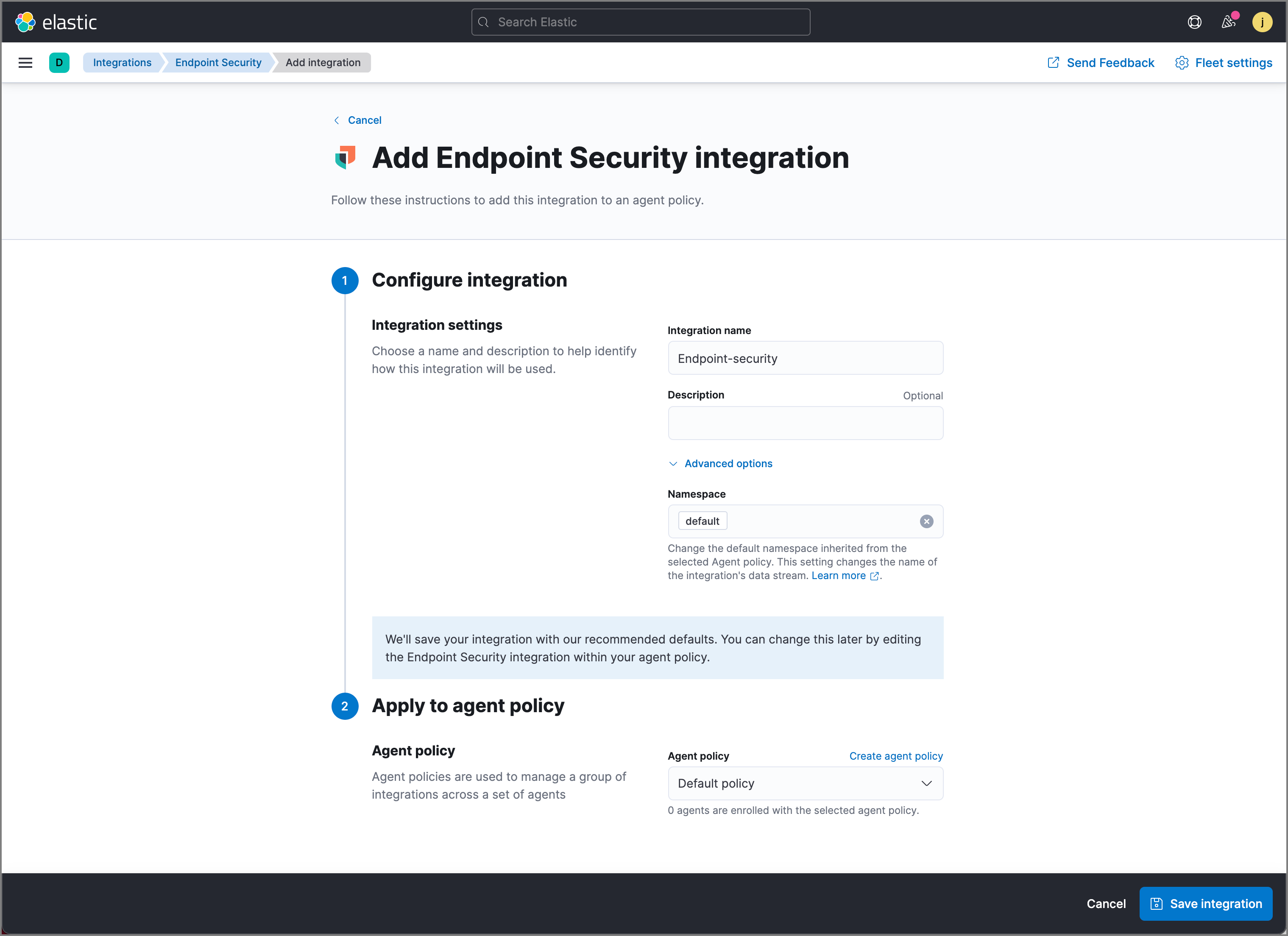

  4. Configure the Endpoint Security integration with a name and optional description. When the configuration is complete, click Save integration in the lower right corner.
    Add Endpoint Security integration page.

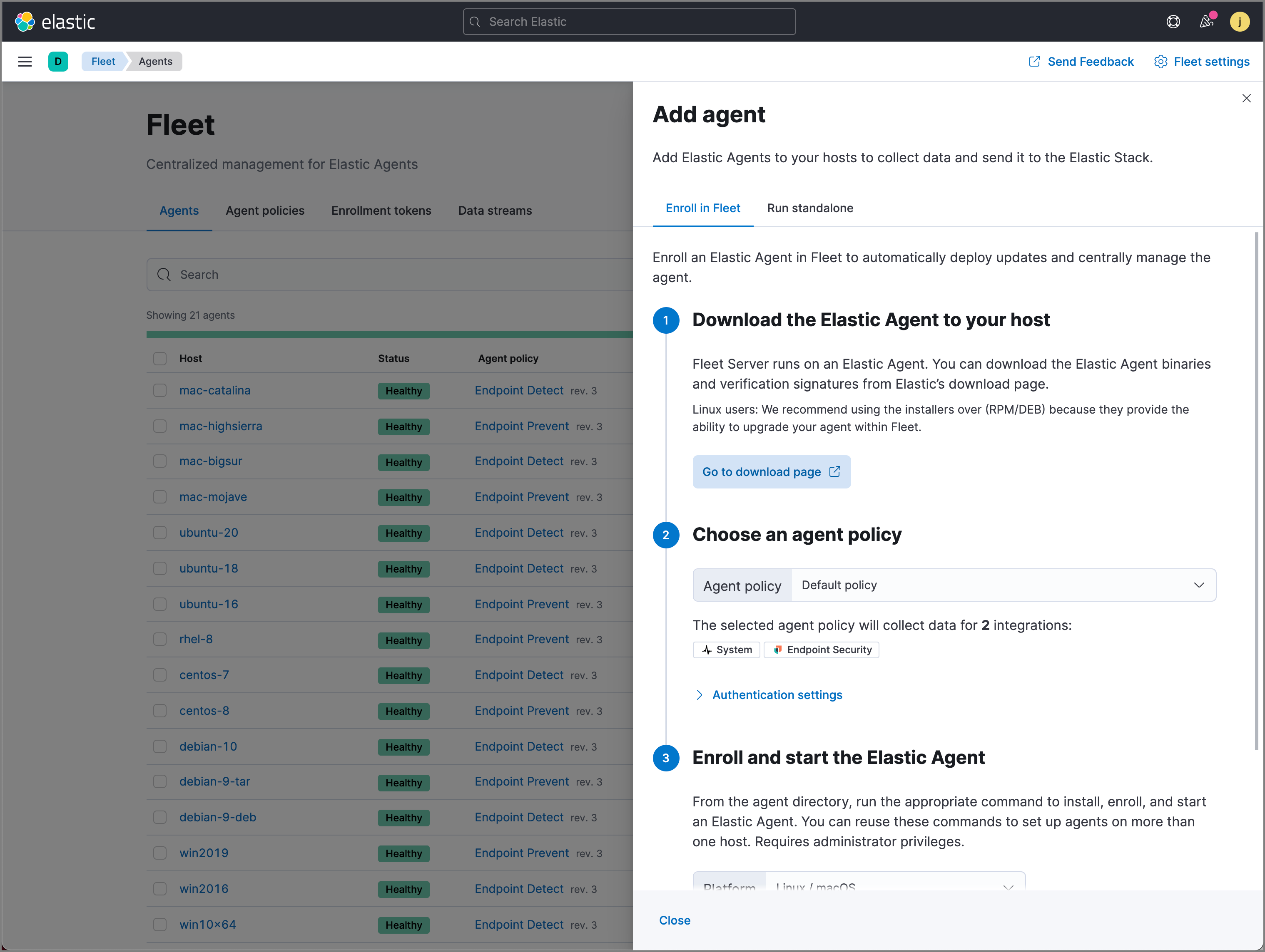

  1. Go to FleetAgentsAdd agent.
    Add agent flyout on the Fleet page.

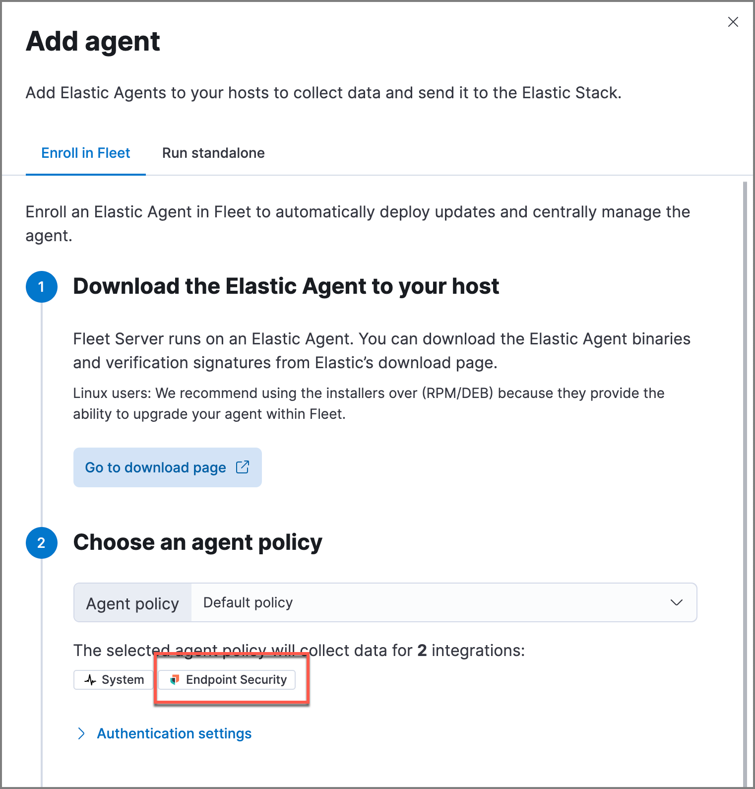

  2. In the Add agent pane, download the Elastic Agent on your host’s machine.
  3. After the download is complete, select the Endpoint Security integration.
    Detail of Add agent flyout with Endpoint Security integration highlighted.
  4. After the Elastic Agent is installed on your host machine, open a command-line interface and navigate to the directory where the agent is located. Copy the commands from Fleet for your OS to enroll and run the agent.
  5. After you have enrolled the Elastic Agent on your host, select Continue. The host now appears on the Endpoints page in the Elastic Security app.

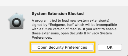

If you are running the Elastic Agent with the Elastic Endpoint integrated on macOS 10.13, 10.14 and 10.15, you will be prompted to approve a kernel extension from "Endgame, Inc". To approve the extension:
  1. Select Open Security Preferences. The Security and Privacy pane opens.
    macOS notification with Open Security Preferences button highlighted.

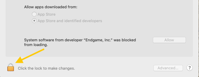

  2. Select the Lock icon at the bottom left of the window to make changes to your security settings.
    Detail of Security and Privacy pane with Lock icon highlighted.

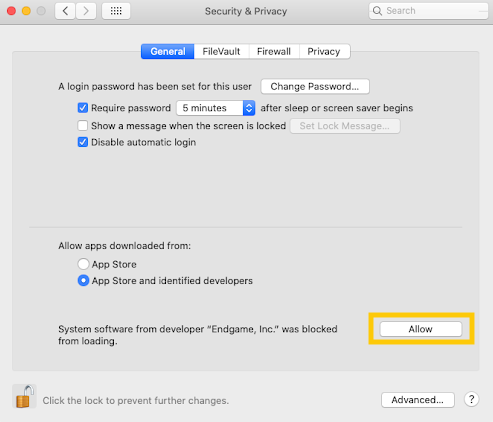

  3. Allow "Endgame, Inc" by clicking the Allow button.
    Security and Privacy pane with Allow button highlighted.
