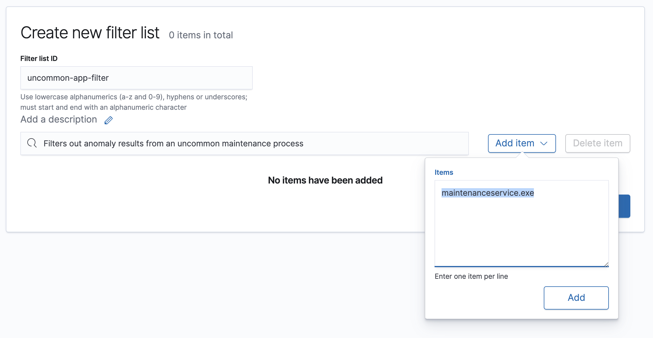

  2. Click Filter Lists and then New.
    The Create new filter list pane is displayed.
  3. Enter a filter list ID.
  4. Enter a description for the filter list (optional).
  5. Click Add item.
  6. In the Items textbox, enter the name of the process for which you want to filter out anomaly results (maintenanceservice.exe in our example).
    filter add item
  7. Click Add and then Save.

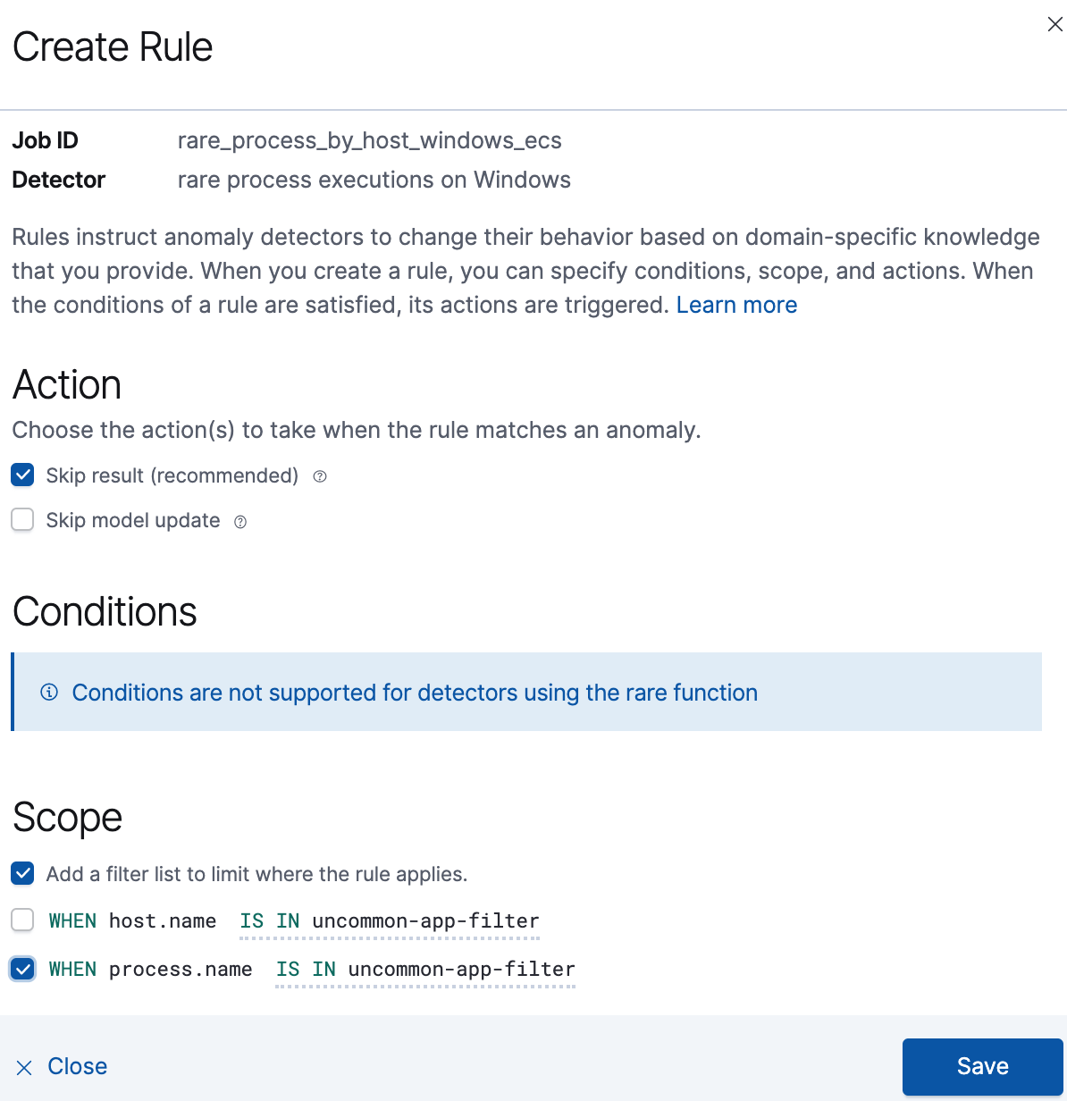

  3. In the actions column, click the gear icon and then select Configure rules.
    The Create Rule window is displayed.
    rule scope
  4. Select:
    1. Add a filter list to limit where the rule applies.
    2. The WHEN statement for the relevant detector (process.name in our example).
    3. The IS IN statement.
    4. The filter you created as part of the Create a filter list procedure.
      For more information about detectors, see Anomaly detection jobs.
  5. Click Save.

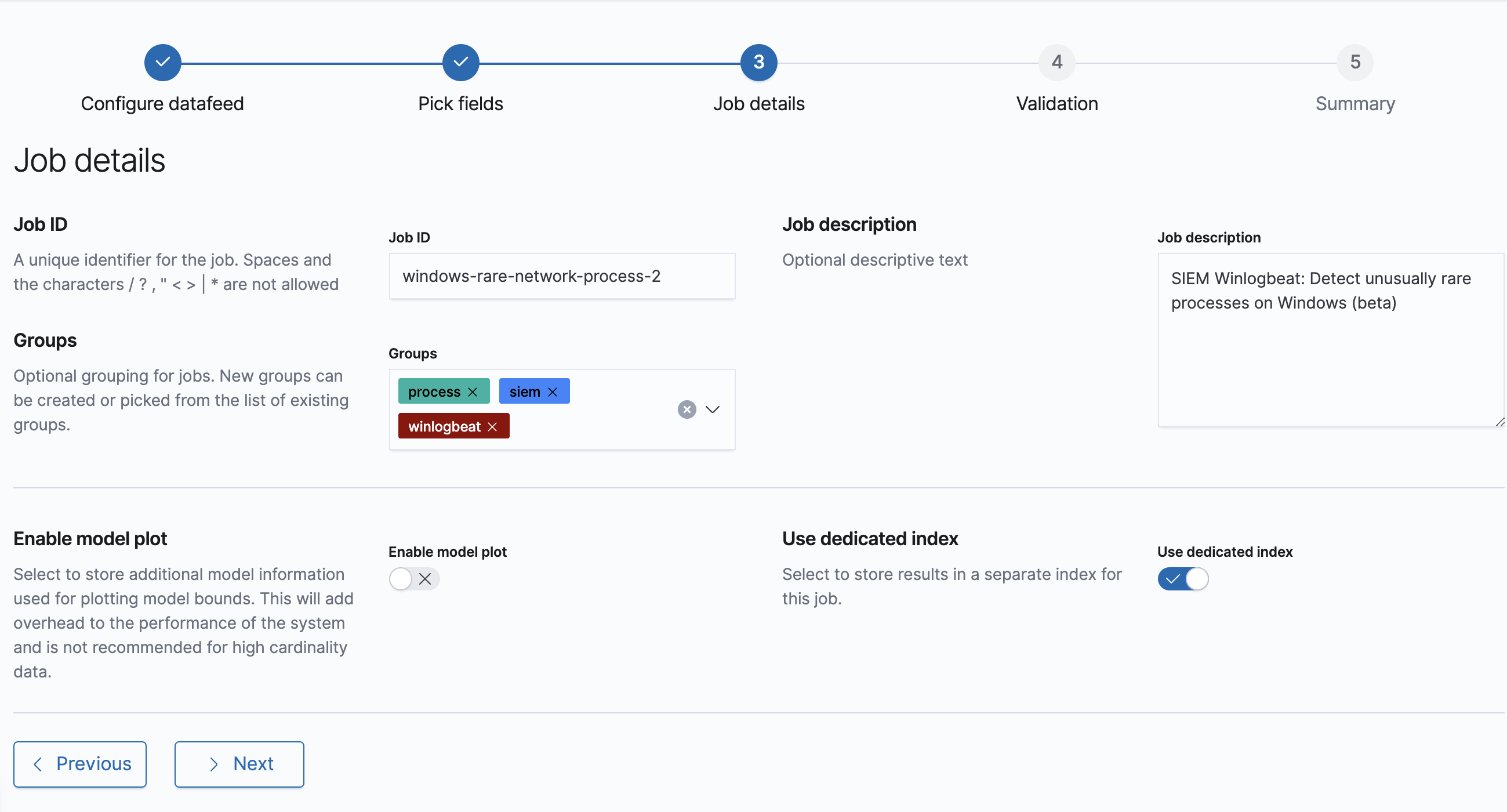

  7. Enter a Job ID for the cloned job that indicates it is an iteration of the original one. For example, append a number or a username to the original job name, such as windows-rare-network-process-2.
    cloned job details
  8. Click Next and check the job validates without errors. You can ignore warnings about multiple influencers.

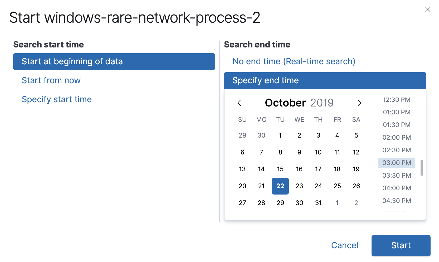

    The Start <job name> window is displayed.
    start job window
  10. Select the point of time from which the job will analyze anomalies.
  11. Click Start.

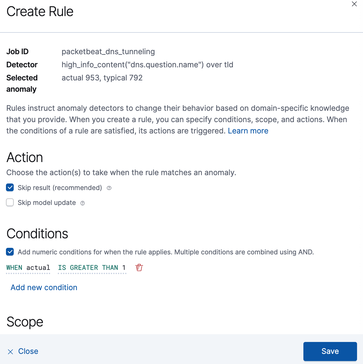

    ml rule threshold
  4. Select Add numeric conditions for when the rule applies and the following when statement:
    WHEN actual IS GREATER THAN <X>
    Where <X> is the threshold above which anomalies are detected.
  5. Click Save.
