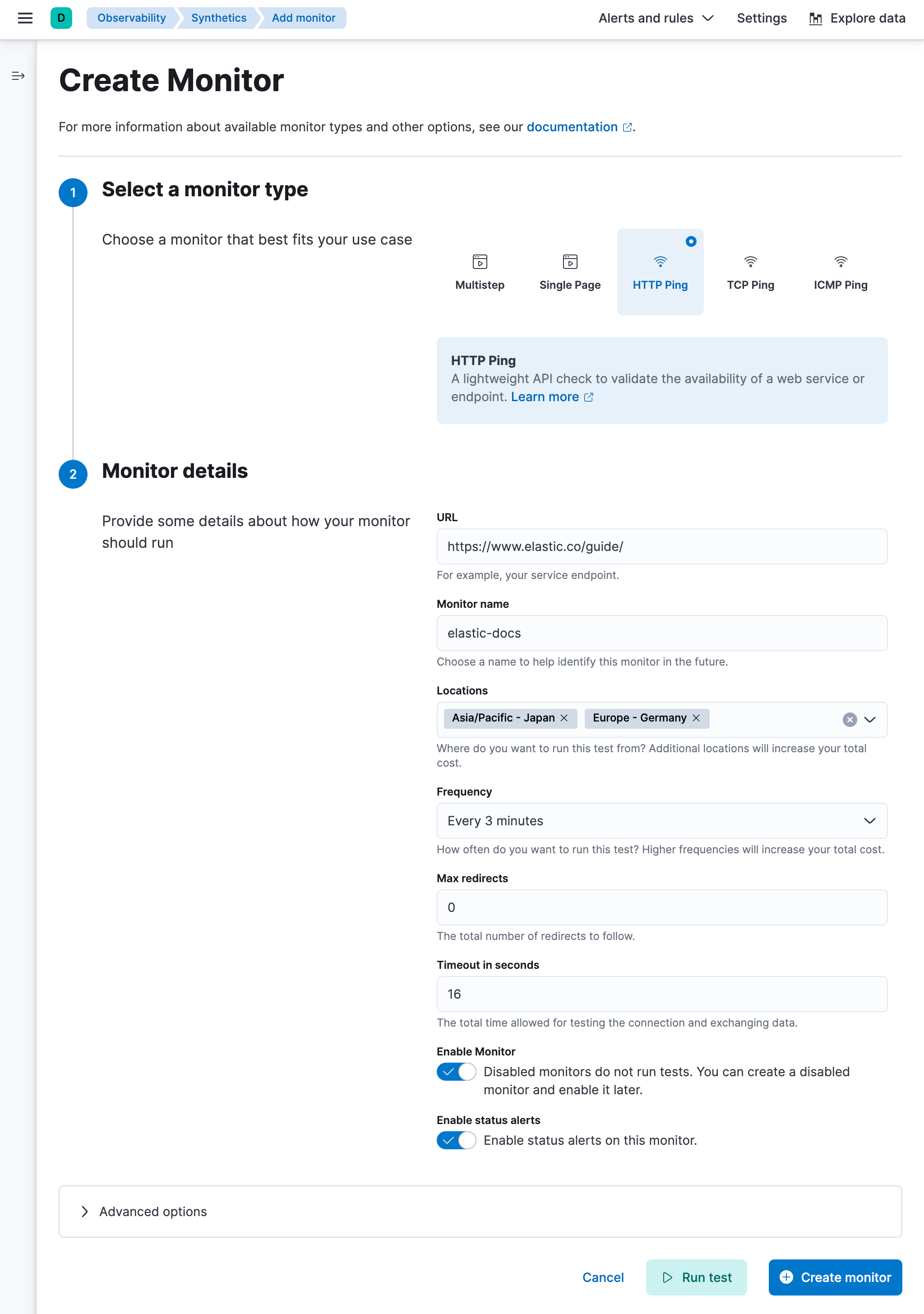

Add a lightweight monitoredit
To use the Synthetics app to add a lightweight monitor:
  1. Go to Synthetics (beta) in Kibana.
  2. Click Create monitor.
  3. Set the monitor type to HTTP Ping, TCP Ping, or ICMP Ping.
  4. In Locations, select one or more locations.
  5. Set the Frequency, and configure the monitor as needed.
  6. Click Advanced options to see more ways to configure your monitor.
  7. (Optional) Click Run test to verify that the test is valid.
  8. Click Create monitor.
    Synthetics Create monitor UI
If you’ve added a Private Location, you’ll see your new Private Location in the list of Locations.
Screenshot of Monitor locations options including a Private Location

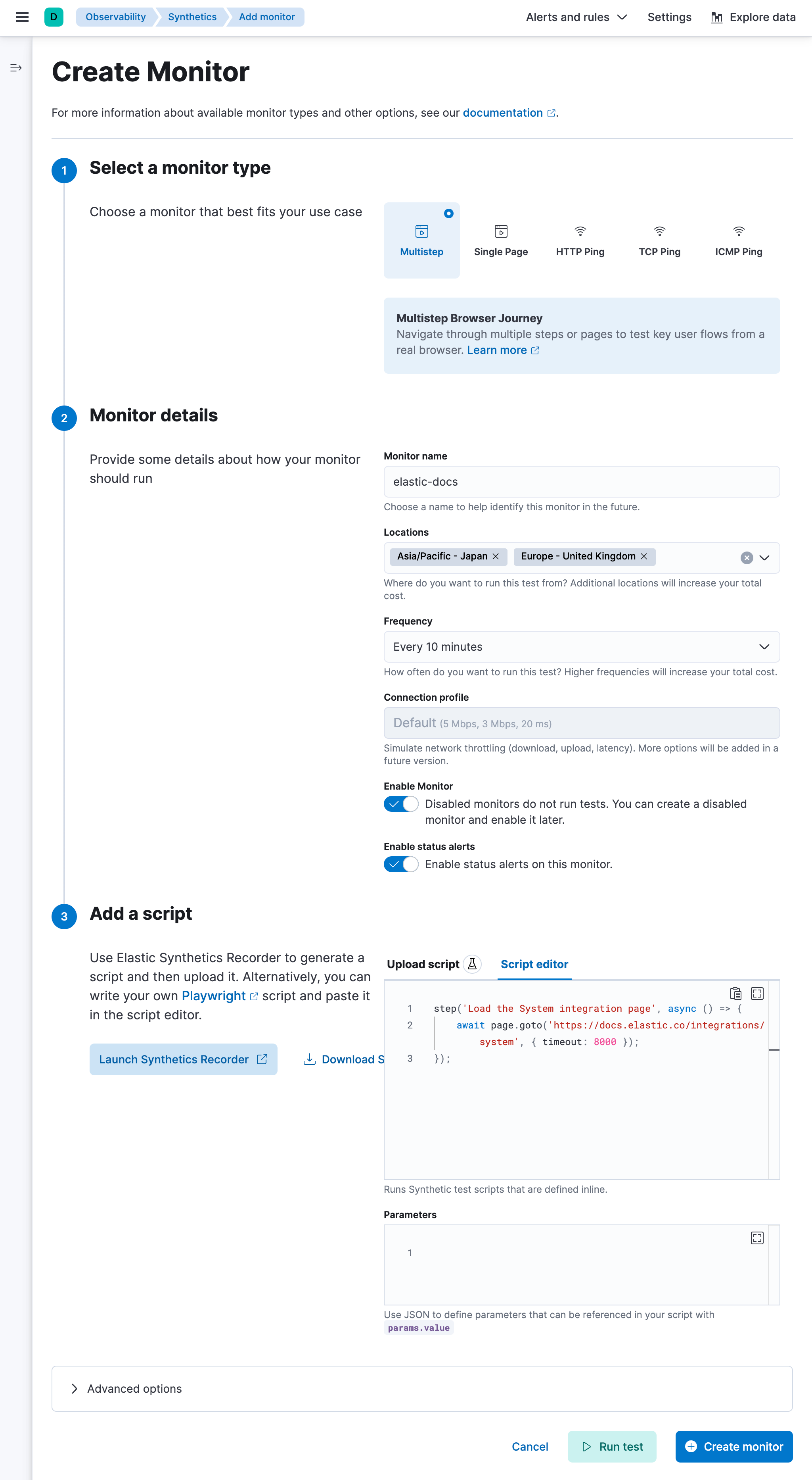

Add a browser monitoredit
You can also create a browser monitor in the Synthetics app using an Inline script.
An inline script contains a single journey that you manage individually. Inline scripts can be quick to set up, but can also be more difficult to manage. Each browser monitor configured using an inline script can contain only one journey, which must be maintained directly in Kibana.
If you depend on external packages, have your journeys next to your code repository, or want to embed and manage more than one journey from a single monitor configuration, use project monitors instead.
To use the Synthetics app to add a browser monitor:
  1. Click Create monitor.
  2. Set the monitor type to Multistep.
  3. In Locations, select one or more locations.
  4. Set the Frequency.
  5. Add steps to the Script editor code block directly. The journey keyword isn’t required, and variables like page and params will be part of your script’s scope. You cannot import any dependencies when using inline browser monitors.
    Configure a synthetic monitor using an inline script in Elastic Fleet
    Alternatively, you can use the Script recorder option. You can use the Elastic Synthetics Recorder to interact with a web page, export journey code that reflects all the actions you took, and upload the results to Synthetics app. For more information, refer to Use the Synthetics Recorder.
    • Use Data options to add context to the data coming from your monitors.
    • Use the Synthetics agent options to provide fine-tuned configuration for the synthetics agent. Read more about available options in Use the CLI.
