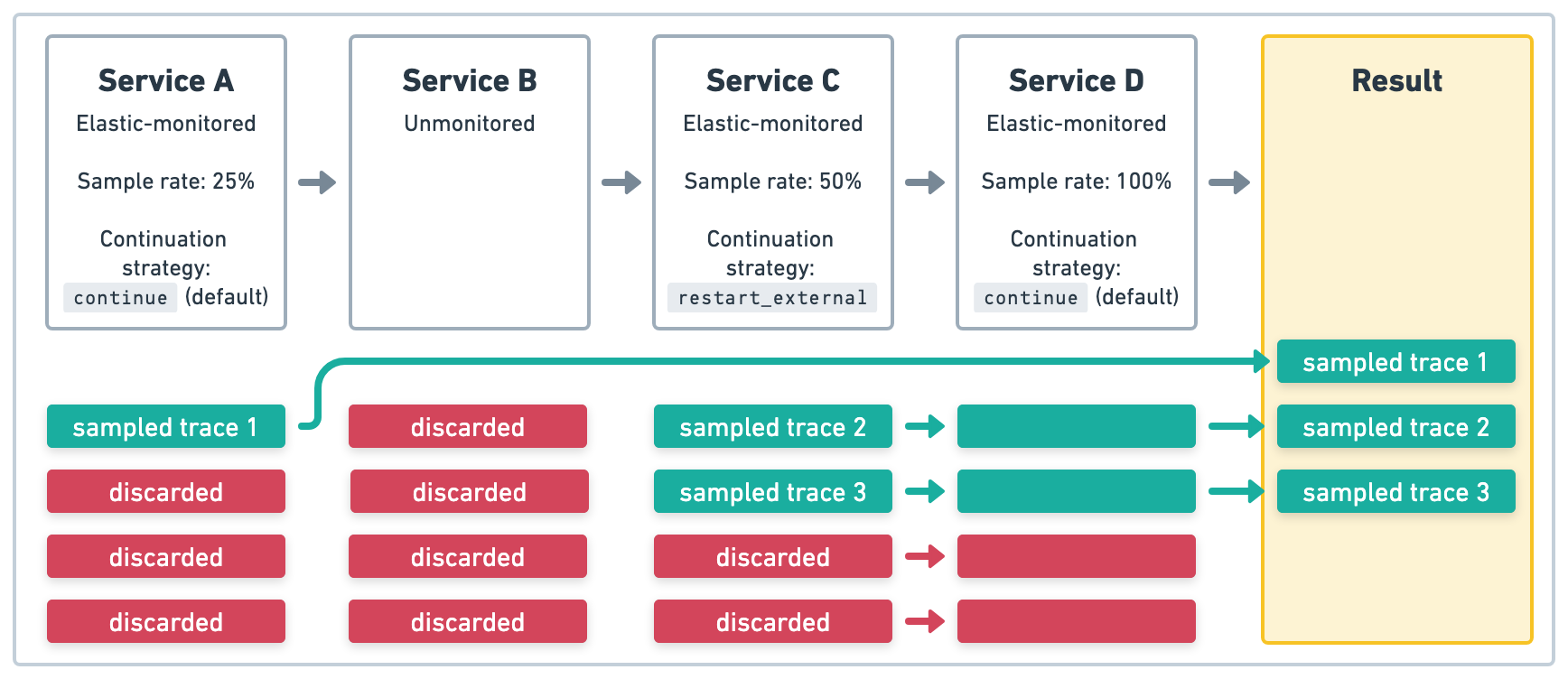

In the example in Figure 3, Service A is an Elastic-monitored service that initiates four transactions
with a sample rate of .25 (25%). Because Service B is unmonitored, the traces started in
Service A will end there. Service C is an Elastic-monitored service that initiates four transactions
that start new traces with a new sample rate of .5 (50%). Because Service D is also
Elastic-monitored service, the upstream sampling decision defined in Service C is respected.
The end result will be three sampled traces.
