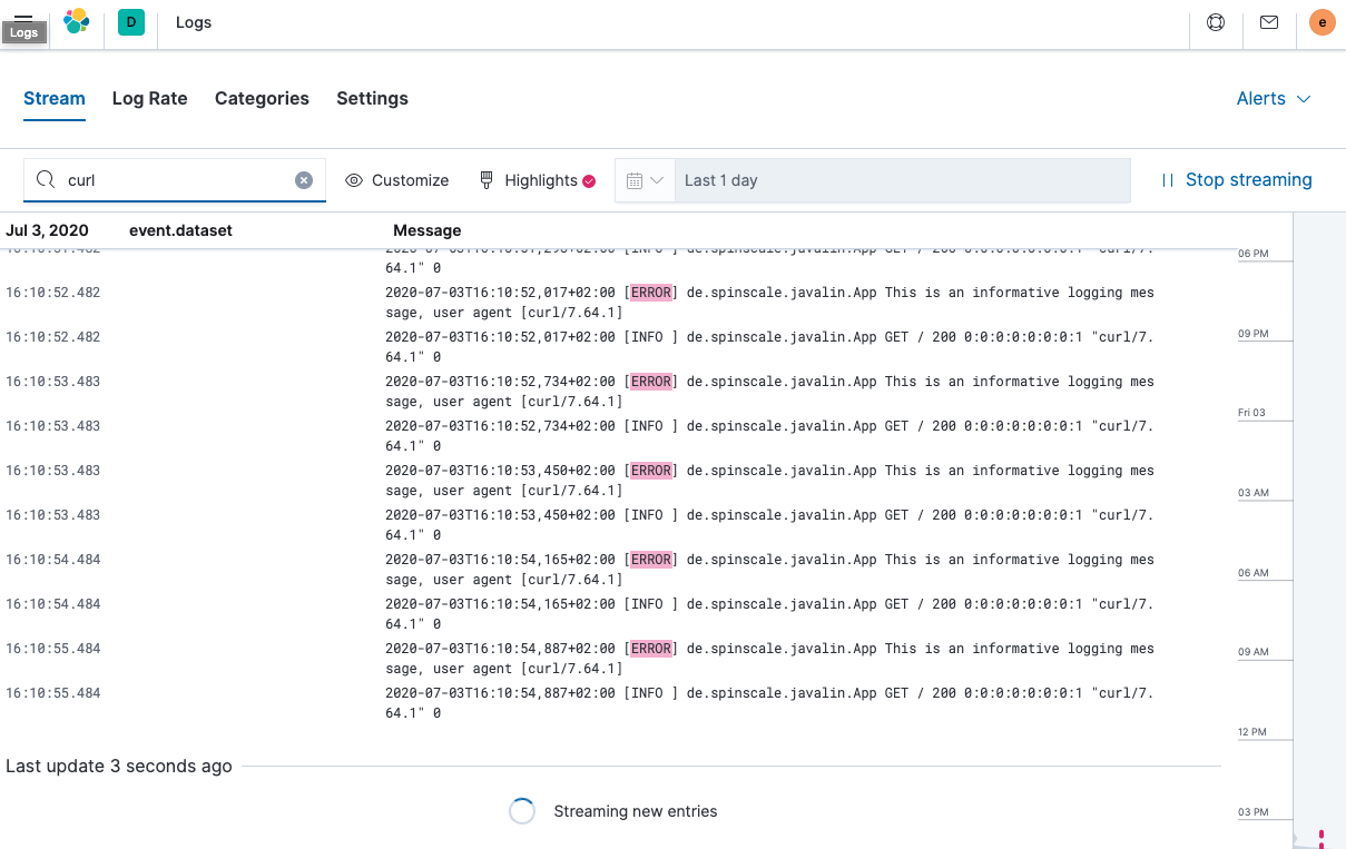

    10:43:50.066 [INFO ] de.spinscale.javalin.App - GET / 200 0:0:0:0:0:0:0:1 "curl/7.64.1" 7
Create an ISO8601 timestamp
Before ingesting logs into Elasticsearch Service, create an ISO8601 timestamp by editing the log4j2.xml file.
Creating an ISO8601 timestamp removes the need to do any calculation for timestamps when ingesting logs, as this is a unique point in time, including the timezone. Having a timezone becomes more important once you are running across data centers while trying to follow data streams.
<PatternLayout pattern="%d{ISO8601_OFFSET_DATE_TIME_HHCMM} [%-5level] %logger{36} %msg%n"/>
The log entries are ingested containing timestamps like the following.
2020-07-03T14:25:40,378+02:00 [INFO ] de.spinscale.javalin.App GET / 200 0:0:0:0:0:0:0:1 "curl/7.64.1" 0

  2. Restart the application and send a request. The logs will be sent to /tmp/javalin/app.log.

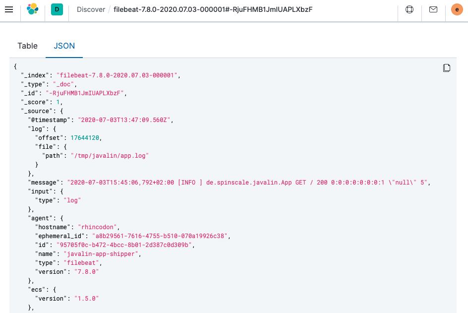

Install and configure Filebeat
To read the log file and send it to Elasticsearch, Filebeat is required. To download and install Filebeat, use the commands that work with your system:
curl -L -O https://artifacts.elastic.co/downloads/beats/filebeat/filebeat-8.17.10-amd64.deb
sudo dpkg -i filebeat-8.17.10-amd64.deb
  1. Use the Filebeat keystore to store secure settings. Let’s store the Cloud ID in the keystore.
    Substitute the Cloud ID from your deployment in the following command. To find your Cloud ID Click on your deployment in https://cloud.elastic.co/deployments
    ./filebeat keystore create
    echo -n "<Your Cloud ID>" | ./filebeat keystore add CLOUD_ID --stdin
    To store logs in Elasticsearch with minimal permissions, create an API key to send data from Filebeat to Elasticsearch Service.
  2. Log into Kibana user (you can do so from the Cloud Console without typing in any permissions) and select Management → Dev Tools. Send the following request:
    POST /_security/api_key
      "name": "filebeat_javalin-app",
      "role_descriptors": {
        "filebeat_writer": {
          "cluster": ["monitor", "read_ilm"],
          "index": [
              "names": ["filebeat-*"],
              "privileges": ["view_index_metadata", "create_doc"]
    The response contains an api_key and an id field, which can be stored in the Filebeat keystore in the following format: id:api_key.
    echo -n "IhrJJHMB4JmIUAPLuM35:1GbfxhkMT8COBB4JWY3pvQ" | ./filebeat keystore add ES_API_KEY --stdin
    Make sure you specify the -n parameter; otherwise, you will have painful debugging sessions, because of adding a newline at the end of your API key.
    To see if both settings have been stored, run ./filebeat keystore list.
  3. To load the Filebeat dashboards, use the elastic super user.
    ./filebeat setup -e -E 'cloud.id=${CLOUD_ID}' -E 'cloud.auth=elastic:YOUR_SUPER_SECRET_PASS'
    If you prefer not to store credentials in your shell’s .history file, add a space at the beginning of the line. Depending on the shell configuration, these commands are not added to the history.
  4. Configure Filebeat, so it knows where to read data from and where to send it to. Create a filebeat.yml file.
    filebeat.inputs:
    - type: log
      paths:
        - /tmp/javalin/*.log
    cloud.id: ${CLOUD_ID}
    output.elasticsearch:
      api_key: ${ES_API_KEY}
Send data to Elasticsearch
To send data to Elasticsearch, start Filebeat.
sudo service filebeat start
If you use an init.d script to start Filebeat, you can’t specify command line flags (see Command reference). To specify flags, start Filebeat in the foreground.
Also see Filebeat and systemd.

  1. Log into Kibana and select the Discover app.
    There is a summary of the documents at the top, but let’s take a look at a single document.
    Kibana single document view
    You can see that a lot more data is indexed than just the event. There is information about the offset in the file, information about the component shipping the logs, the name of the shipper’s name in the output, and there is a message field containing log line contents.
    You can see there is a flaw in the request logging. If the user agent is null, something other than null is returned. Reading our logs is crucial; however, just indexing them gains us nothing. To fix this, here is a new request logger.

  2. Now let’s have a look at the Logs app in Kibana. Select Observability → Logs.
    If you want to see the streaming feature at work, run the following curl request in a loop while sleeping.
    while $(sleep 0.7) ; do curl localhost:7000 ; done
  3. To view a continuous stream of log messages, click Stream live. You can also highlight specific terms, as shown here.
    Kibana Logs UI Streaming
    Looking at one of the documents being indexed, you can see that the log message is contained in a single field. Verify this by looking at one of those documents.

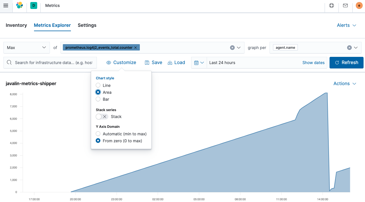

Step 5: Ingest metrics
A metric is considered a point in time value that can change anytime. The number of current requests can change any millisecond. You could have a spike of 1000 requests, and then everything goes back to one request. This also means that these kinds of metrics may not be accurate, and you also want to pull min/max values to get some more indication. Furthermore, this implies that you need to think about the duration of those metrics as well. Do you need those once per minute or every 10 seconds?
To get a different angled view of your application, let’s ingest some metrics. In this example, we will use the Metricbeat Prometheus Module to send data to Elasticsearch.
The underlying library used in our app is micrometer.io, a vendor-neutral application metrics facade in combination with its Prometheus support to implement a pull-based model. You could use the elastic support to achieve a push-based model. This would require users to store credential data of the Elasticsearch cluster in our app. This example keeps this data in the surrounding tools.

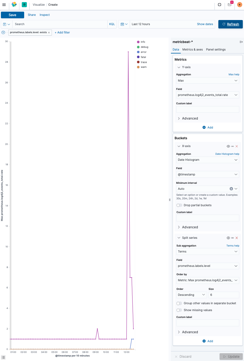

Visualize the number of log messages over time, split by the log level. Since the Elastic Stack 7.7, there is a new way of creating a visualization called Lens.
  1. Log into Kibana and select Visualize → Create Visualization.
  2. Create a line chart and select metricbeat-* as the source.
    The basic idea is to have a max aggregation on the y-axis on the prometheus.log4j2_events_total.rate field, whereas the x-axis, is split by date using a date_histogram aggregation on the @timestamp field.
    There is one more split within each date histogram bucket, split by log level, using a terms aggregation on the prometheus.labels.level, which contains the log level. Also, increase the size of the log level to six to display every log level.
    The final result looks like this.
    Date Histogram of the log rate per log level

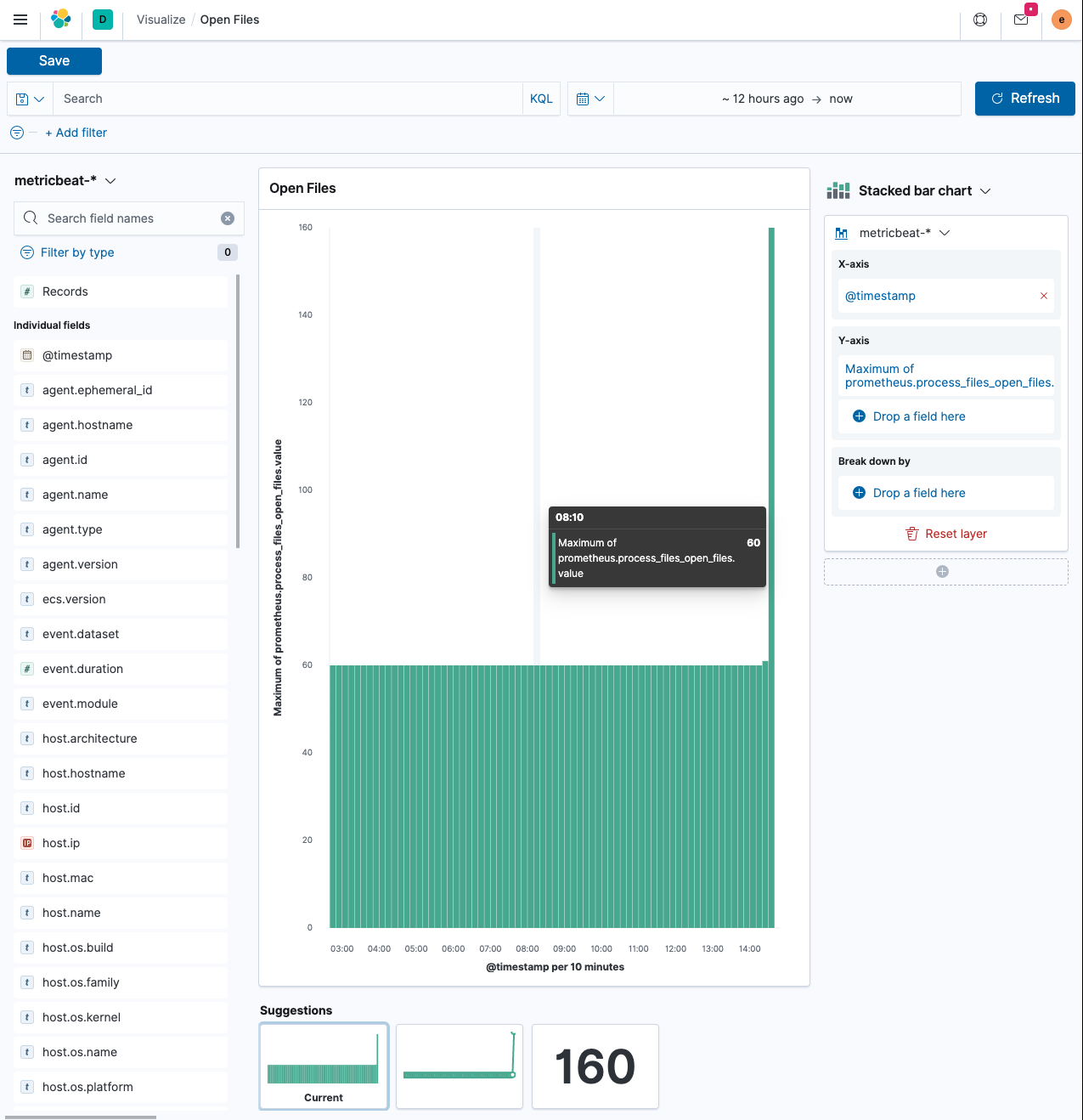

The second visualization is to be a check for the number of open files in our application.
As no one can remember all the field names, let’s again look at the metrics output again first.
curl -s localhost:7000/metrics -u metrics:secret | grep ^process
process_files_max_files 10240.0
process_cpu_usage 1.8120711232436825E-4
process_uptime_seconds 72903.726
process_start_time_seconds 1.594048883317E9
process_files_open_files 61.0
Let’s look at the process_files_open_files metric. This should be a rather static value that rarely changes. If you run an application which stores data within the JVM or opens and closes network sockets, this metric increases and decreases depending on the load. With a web application, this is rather static. Let’s figure out why there are 60 files open on our small web application.

  3. Add an endpoint to increase the number of open files by having long-running HTTP connections (each connection is also considered an open file as it requires a file descriptor), and then run wrk against it.
    import java.util.concurrent.CompletableFuture;
    import java.util.concurrent.Executor;
    import java.util.concurrent.TimeUnit;
    public static void main(String[] args) {
        final Executor executor = CompletableFuture.delayedExecutor(20, TimeUnit.SECONDS);
        app.get("/wait", ctx -> {
            CompletableFuture<String> future = CompletableFuture.supplyAsync(() -> "done", executor);
            ctx.result(future);
    Every future gets delayed by 20 seconds, which means that a single HTTP request stays open for 20 seconds.
  4. Let’s run a wrk workload.
    wrk -c 100 -t 20 -d 5m http://localhost:7000/wait
    Results show that only twenty requests were sent, which makes sense given the processing time.

  5. Below Add filter, select the metricbeat-* index pattern. This will likely use filebeat-* as the default.
    The x-axis uses the @timestamp field - which in turn will create a date_histogram aggregation again. The y-axis should not be the document count, as that one will always be stable, but the maximum value of the documents in the buckets. Click on the right of the field name on the y-axis and select Max. This gives you a similar visualization than shown, with a peak where you ran the wrk command above.
  6. Now let’s have a look at the Infrastructure app in Kibana. Select Observability → Infrastructure.
    You will only see data from a single shipper. Still, the moment you are running several services and the ability to group this per Kubernetes pod or host enables you to spot hosts with elevated CPU or memory consumption.
  7. Click Metrics Explorer, you can start exploring your data for specific hosts or the CPU usage across your nodes.
    Metrics UI Log Counter
    This is an area chart of the total events counter the Javalin app emits. It’s rising because there is a component polling an endpoint that, in turn, produces another log message. The steeper peek was due to sending more requests. But where is the sudden drop-off coming from? A JVM restart. As those metrics are not persisted, they reset on a JVM restart. With that in mind, it’s often better to log the rate instead of the counter field.

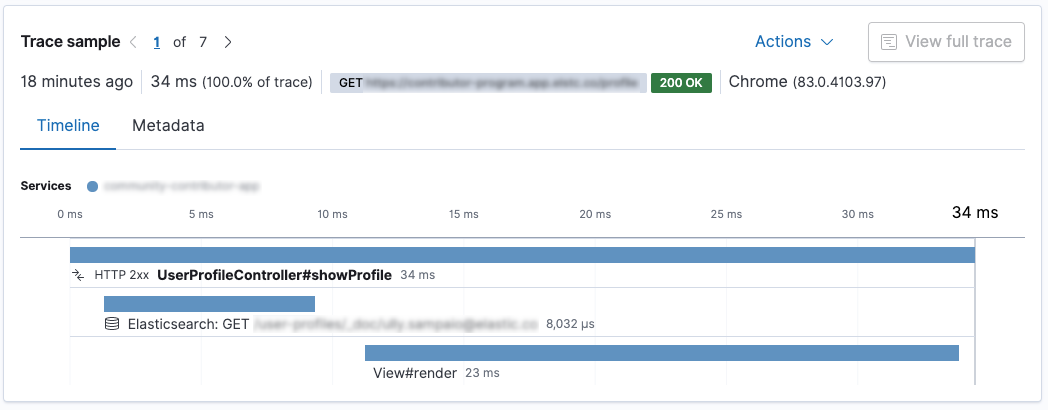

A transaction encapsulates a series of spans, which contain information about the execution of a piece of code. Let’s take a look at this screenshot from the Kibana Applications UI.
A transaction with spans
This is a Spring Boot application. The UserProfileController.showProfile() method is called, which is marked as the transaction. There are two spans within. First, a request is sent to Elasticsearch using the Elasticsearch REST client, and after the response is rendered using Thymeleaf. The request to Elasticsearch is faster than the rendering in this case.

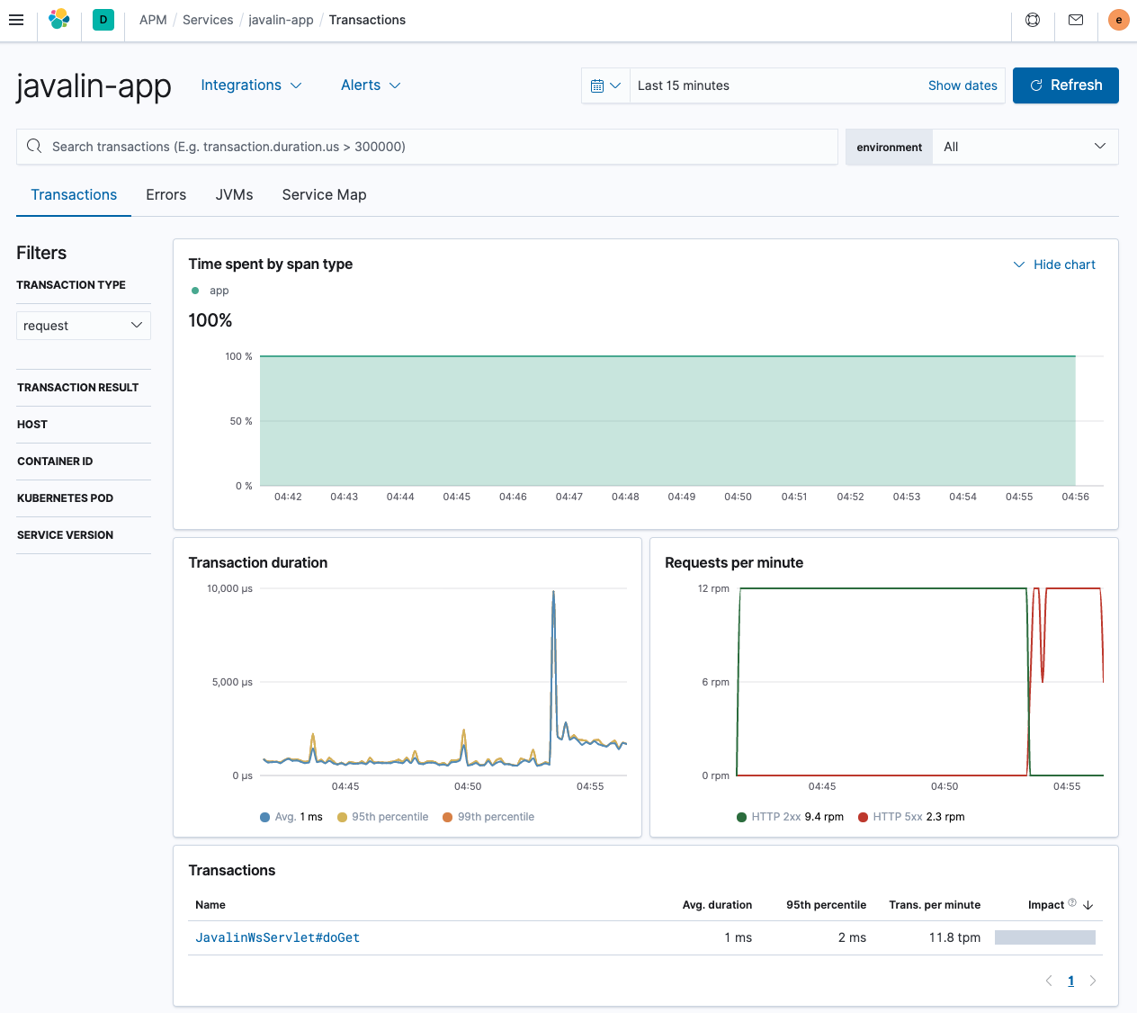

    Wait a few minutes and let’s finally take a look at the Applications UI.
    Javalin App Applications UI
    As you can see, this is quite the difference to the Spring Boot application shown earlier. The different endpoints are not listed; we can see the requests per minute though including errors.
    The only transaction comes from a single servlet, which is not too helpful. Let’s try to fix this by introducing custom programmatic transactions.

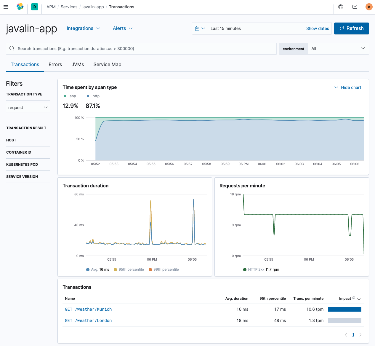

    app.before(ctx -> ElasticApm.currentTransaction()
      .setName(ctx.method() + " " + ctx.path()));

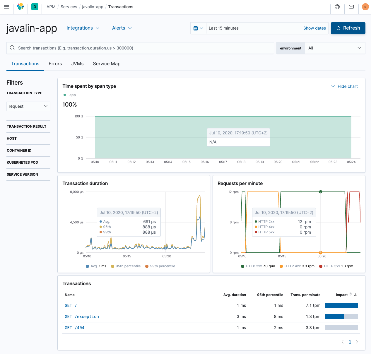

  3. Restart your app and see data flowing in. Test a few different endpoints, especially the one that throws exceptions and the one that triggers a 404.
    Applications UI with correct transaction names
    This looks much better, having differences between endpoints.

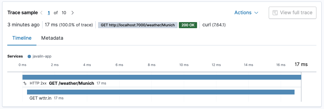

  5. Curl http://localhost:7000/weather/Munich and see a one-line response about the current weather. Let’s check the APM UI.
    In the overview, you can see that most time is spent in the HTTP client, which is not surprising.
    Overview
    Our transactions for the /weather/Munich now contain a span, showing how much time is spent on retrieving the weather data. Because the HTTP client is instrumented automatically, there is no need to do anything.
    Transaction with span
    If the city parameter if that URL is of high cardinality, this will result in a high amount of URLs mentioned instead of the generic endpoint. If you would like to prevent this, a possibility would be to use ctx.matchedPath() to log every call to the weather API as GET /weather/:city. This however requires some refactoring by removing the app.before() handler and replacing it with a app.after() handler.
    app.after(ctx -> ElasticApm.currentTransaction().setName(ctx.method()
      + " " + ctx.endpointHandlerPath()));

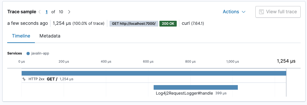

Instead of writing code to trace methods, you can also configure the agent to do this. Let’s try to figure out if logging is a bottleneck for our application and trace the request logger statements we added earlier.
The agent can trace methods based on their signature.
The interface to monitor would be the io.javalin.http.RequestLogger interface with the handle method. So let’s try io.javalin.http.RequestLogger#handle to identify the method to log and put this in your .env.
ELASTIC_APM_TRACE_METHODS="de.spinscale.javalin.Log4j2RequestLogger#handle"

    Logging caller trace
    The request logger takes roughly 400 microseconds. The whole request takes about 1.3 milliseconds. Approximately a third of the processing of our request goes into logging.
    If you are on the quest for a faster service, you may want to rethink logging. However, this logging happens after the result is written to the client, so while the total processing time increases with logging, responding to the client does not (closing the connection however might be). Also note that these tests were conducted without a proper warm-up. I assume that after appropriate JVM warm-up, you will have much faster processing of requests.

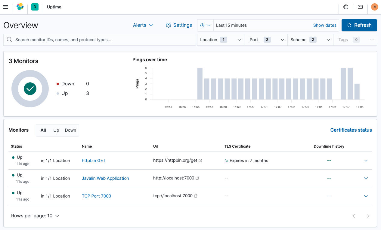

To view the Uptime app, select Observability → Uptime. The overview looks like this.
Uptime Overview
You can see the list of monitors and a global overview. Let’s see the details for one of those alerts. Click Javalin Web Application.
You can see the execution for the last scheduled checks, but the duration for each check might be more interesting. You can see if the latency for one of your checks is going up.
The interesting part is the world map at the top. You can specify in the configuration where the check originated, which in this case was in Munich in Europe. By configuring several Heartbeats running across the world, you can compare latencies and figure out which data center you need to run your application to be next to your users.
The duration of the monitor is in the low milliseconds, as it is really fast. Check the monitor for the httpbin.org endpoint, and you will see a much higher duration. In this case, it is about 400 milliseconds for each request. This is not too surprising because the endpoint is not nearby, and you need to initiate a TLS connection for every request, which is costly.
Do not underestimate the importance of this kind of monitoring. Also, consider this just the beginning as the next step is to have synthetics that monitor the correct behavior of your application, for example, to ensure that your checkout process works all the time.
