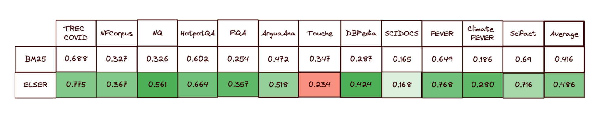

editThe metric that is used to evaluate ELSER’s ranking ability is the Normalized Discounted Cumulative Gain (NDCG) which can handle multiple relevant documents and fine-grained document ratings. The metric is applied to a fixed-sized list of retrieved documents which, in this case, is the top 10 documents (NDCG@10).
The table below shows the performance of ELSER compared to Elasticsearch BM25 with an English analyzer broken down by the 12 data sets used for the evaluation. ELSER has 10 wins, 1 draw, 1 loss and an average improvement in NDCG@10 of 17%.
NDCG@10 for BEIR data sets for BM25 and ELSER - higher values are better)

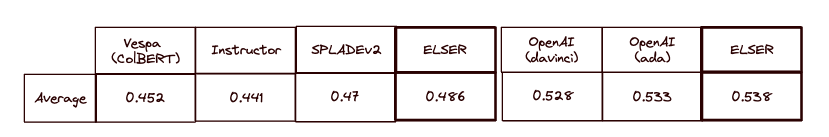

The following table compares the average performance of ELSER to some other strong baselines. The OpenAI results are separated out because they use a different subset of the BEIR suite.
Average NDCG@10 for BEIR data sets vs. various high quality baselines (higher is better). OpenAI chose a different subset, ELSER results on this set reported separately.
To read more about the evaluation details, refer to this blog post.

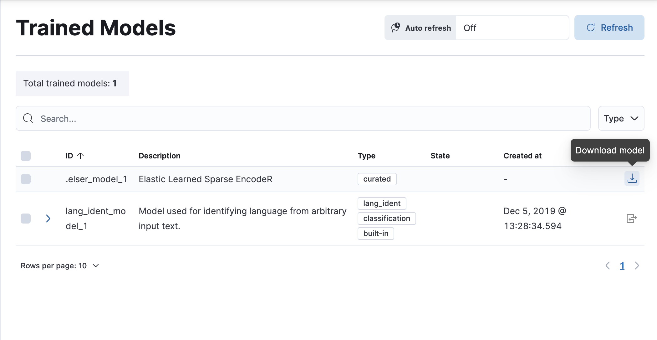

Using the Trained Models page
edit- In Kibana, navigate to Machine Learning > Trained Models. ELSER can be found in the list of trained models.
Click the Download model button under Actions. You can check the download status on the Notifications page.

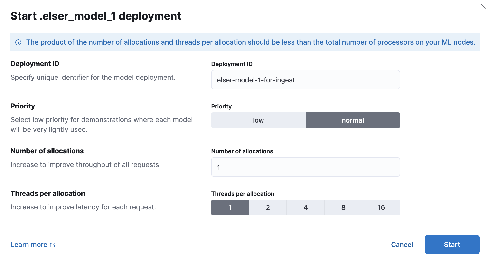

- After the download is finished, start the deployment by clicking the Start deployment button.
Provide a deployment ID, select the priority, and set the number of allocations and threads per allocation values.
- Click Start.

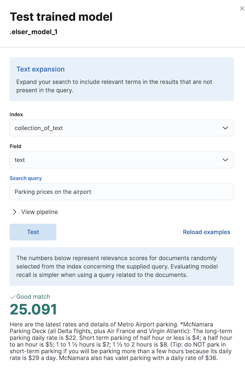

Testing ELSER
editYou can test the deployed model in Kibana. Navigate to Model Management > Trained Models, locate the deployed ELSER model in the list of trained models, then select Test model from the Actions menu.
You can use data from an existing index to test the model. Select the index, then a field of the index you want to test ELSER on. Provide a search query and click Test. Evaluating model recall is simpler when using a query related to the documents.
The results contain a list of ten random values for the selected field along with a score showing how relevant each document is to the query. The higher the score, the more relevant the document is.
