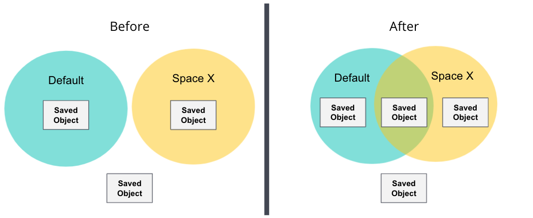

(NEW) Share-capable |
1 space |
Globally unique |
(NEW) Shareable |
1 or more spaces |
Globally unique |
Ideally, most types of objects in Kibana will eventually be shareable; however, we have also introduced share-capable objects as a stepping stone for plugin developers to fully support this feature.
Implementing a shareable saved object type is done in two phases:
- Phase 1: Convert an existing isolated object type into a share-capable one. Keep reading!
- Phase 2: Switch an existing share-capable object type into a shareable one, or create a new shareable object type. Jump to the Phase 2 developer flowchart!

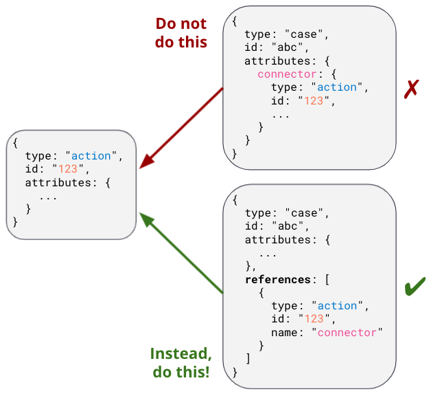

The image below shows two different examples of object links from a "case" object to an "action" object. The top shows the incorrect way to link to another object, and the bottom shows the correct way.
If your objects do not use the root-level references
field, you’ll need to add a migration
before the 8.0 release to fix that. Here’s a migration function for the example above:
function migrateCaseToV716( doc: SavedObjectUnsanitizedDoc<{ connector: { type: string; id: string } }> ): SavedObjectSanitizedDoc<unknown> { const { connector: { type: connectorType, id: connectorId, ...otherConnectorAttrs }, } = doc.attributes; const { references = [] } = doc; return { ...doc, attributes: { ...doc.attributes, connector: otherConnectorAttrs, }, references: [...references, { type: connectorType, id: connectorId, name: 'connector' }], }; } ... // Use this migration function where the "case" object type is registered migrations: { '7.16.0': migrateCaseToV716, },

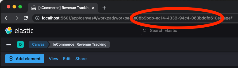

Are there any "deep links" to these objects?
A deep link is a URL to a page that shows a specific object. End-users may bookmark these URLs or schedule reports with them, so it is critical to ensure that these URLs continue working. The image below shows an example of a deep link to a Canvas workpad object:
Note that some URLs may contain deep links to multiple objects, for example, a Dashboard and a filter for an Index Pattern.

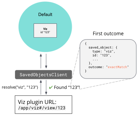

In a nutshell, if your deep link page had something like this before:
const savedObject = savedObjectsClient.get(objType, objId);
You’ll need to change it to this:
const resolveResult = savedObjectsClient.resolve(objType, objId); const savedObject = resolveResult.saved_object;
See an example of this in step 2 of the POC!

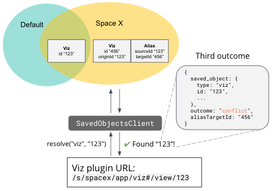

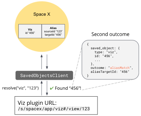

The SavedObjectsResolveResponse interface has four fields, summarized below:
saved_object
- The saved object that was found. -
outcome
- One of the following values:'exactMatch' | 'aliasMatch' | 'conflict'
alias_target_id
- This is defined if the outcome is'aliasMatch'
or'conflict'
. It means that a legacy URL alias with this ID points to an object with a different ID. -
alias_purpose
or'conflict'
. It describes why the legacy URL alis was created.
The SavedObjectsClient is available both on the server-side and the client-side. You may be fetching the object on the server-side via a
custom HTTP route, or you may be fetching it on the client-side directly. Either way, the outcome
and alias_target_id
fields need to be
passed to your client-side code, and you should update your UI accordingly in the next step.

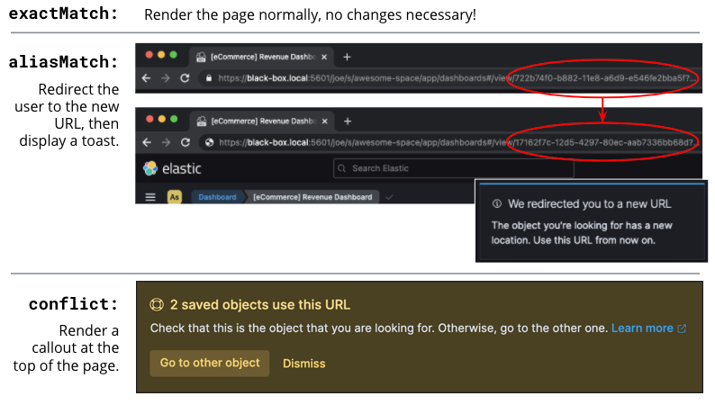

Update your client-side code to correctly handle the three different
resolve()
outcomes
The Spaces plugin API exposes React components and functions that you should use to render your UI in a consistent manner for end-users. Your UI will need to use the Core HTTP service and the Spaces plugin API to do this.
Your page should change according to the outcome:
See an example of this in step 3 of the POC!

In your deep link page, add a check for the
'aliasMatch'
outcome:if (spacesApi && resolveResult.outcome === 'aliasMatch') { // We found this object by a legacy URL alias from its old ID; redirect the user to the page with its new ID, preserving any URL hash const newObjectId = resolveResult.alias_target_id!; // This is always defined if outcome === 'aliasMatch' const newPath = `/this/page/${newObjectId}${window.location.hash}`; // Use the *local* path within this app (do not include the "/app/appId" prefix) await spacesApi.ui.redirectLegacyUrl({ path: newPath, aliasPurpose: resolveResult.alias_purpose, objectNoun: OBJECT_NOUN }); return; }
The
aliasPurpose
field is required as of 8.2, because the API response now includes the reason the alias was created to inform the client whether a toast should be shown or not.The
objectNoun
field is optional. It just changes "object" in the toast to whatever you specify — you may want the toast to say "dashboard" or "data view" instead. -
And finally, in your deep link page, add a function that will create a callout in the case of a
'conflict'
outcome:const getLegacyUrlConflictCallout = () => { // This function returns a callout component *if* we have encountered a "legacy URL conflict" scenario if (spacesApi && resolveResult.outcome === 'conflict') { // We have resolved to one object, but another object has a legacy URL alias associated with this ID/page. We should display a // callout with a warning for the user, and provide a way for them to navigate to the other object. const currentObjectId = savedObject.id; const otherObjectId = resolveResult.alias_target_id!; // This is always defined if outcome === 'conflict' const otherObjectPath = `/this/page/${otherObjectId}${window.location.hash}`; // Use the *local* path within this app (do not include the "/app/appId" prefix) return ( <> {spacesApi.ui.components.getLegacyUrlConflict({ objectNoun: OBJECT_NOUN, currentObjectId, otherObjectId, otherObjectPath, })} <EuiSpacer /> </> ); } return null; }; ... return ( <EuiPage> <EuiPageBody> <EuiPageSection> {/* If we have a legacy URL conflict callout to display, show it at the top of the page */} {getLegacyUrlConflictCallout()} <EuiPageHeader> ... );

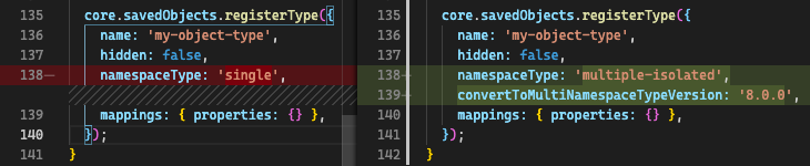

Update your server-side code to convert these objects to become "share-capable"
After Step 3 is complete, you can add the code to convert your objects.
The previous steps can be backported to the 7.x branch, but this step — the conversion itself — can only take place in 8.0! You should use a separate pull request for this.
When you register your object, you need to change the namespaceType
and also add a convertToMultiNamespaceTypeVersion
field. This
special field will trigger the actual conversion that will take place during the Core migration upgrade process when a user installs the
Kibana 8.0 release:
See an example of this in step 4 of the POC!
Reminder, don’t forget to add integration tests!

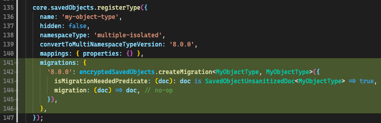

Step 5edit
⚠️ This step must be completed in the 8.0 release (no earlier and no later). ⚠️
Update your server-side code to add an Encrypted Saved Object (ESO) migration for these objects
If you answered "Yes" to Question 3, you need to take additional steps to make sure that your objects can still be decrypted after the conversion process. Encrypted saved objects use some fields as part of "additionally authenticated data" (AAD) to defend against different types of cryptographic attacks. The object ID is part of this AAD, and so it follows that the after the object’s ID is changed, the object will not be able to be decrypted with the standard process.
To mitigate this, you need to add a "no-op" ESO migration that will be applied immediately after the object is converted during the 8.0 upgrade process. This will decrypt the object using its old ID and then re-encrypt it using its new ID:
Reminder, don’t forget to add unit tests and integration tests!

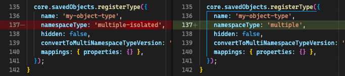

Step 6edit
Update your server-side code to mark these objects as "shareable"
When you register your object, you need to set the proper namespaceType
. If you have an existing object type that is "share-capable", you
can simply change it:

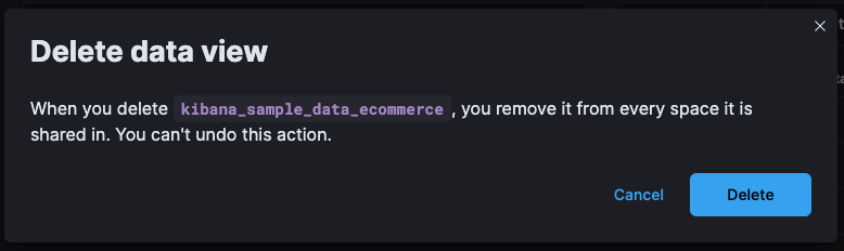

Update saved object delete API usage to handle multiple spaces
If an object is shared to multiple spaces, it cannot be deleted without using the
force
delete option. You should always be aware when a saved object exists in multiple spaces, and you should warn users in that case.
If your UI allows users to delete your objects, you can define a warning message like this:
const { namespaces, id } = savedObject; const warningMessage = namespaces.length > 1 || namespaces.includes('*') ? ( <FormattedMessage id="myPlugin.deleteObjectWarning" defaultMessage="When you delete this object, you remove it from every space it is shared in. You can't undo this action." /> ) : null;
The Data Views page in Stack Management uses a similar approach to show a warning in its delete confirmation modal:

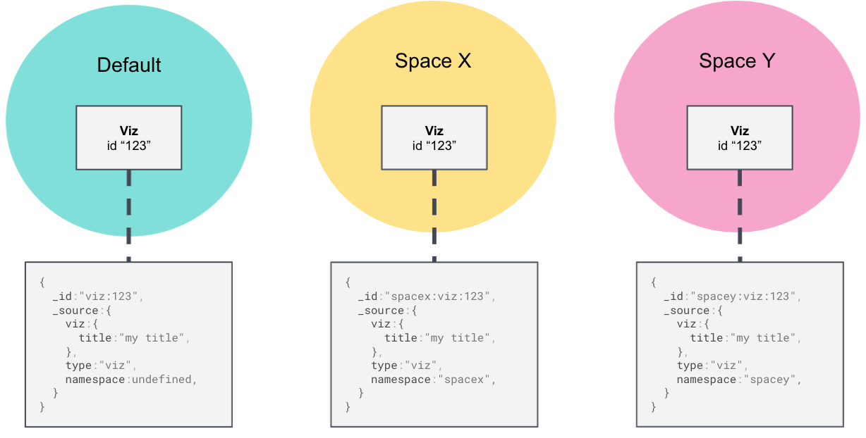

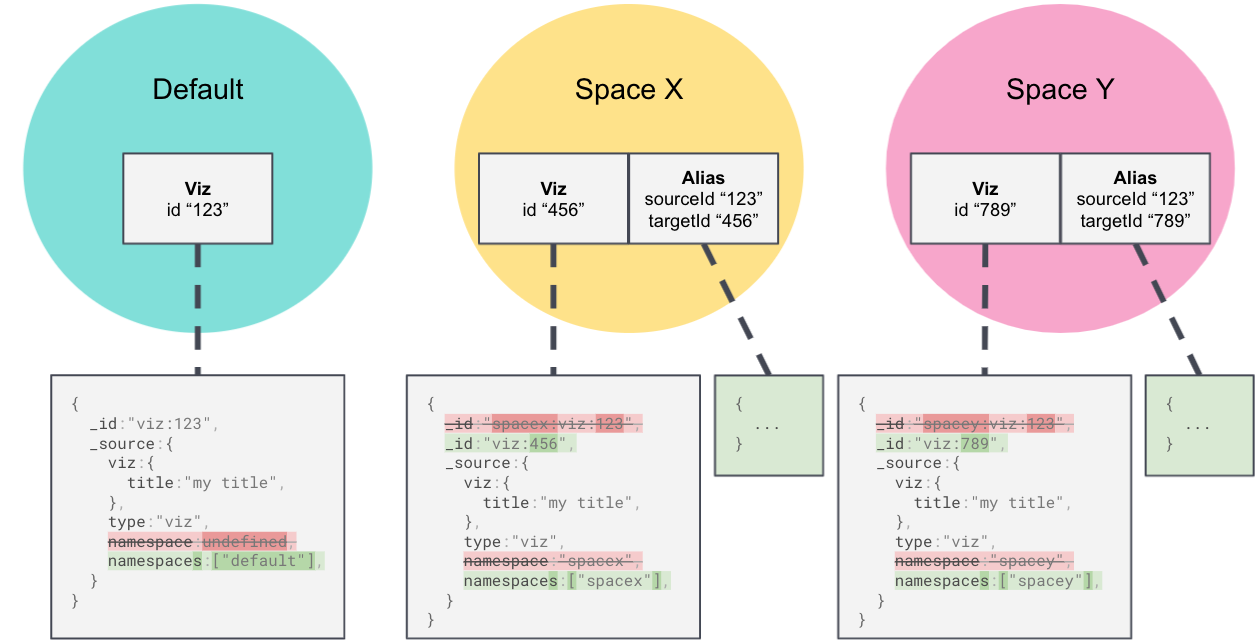

2. Why do object IDs need to be changed?edit
This is because of how isolated objects are serialized to raw Elasticsearch documents. Each raw document ID today contains its space ID (namespace) as a prefix. When objects are copied or imported to other spaces, they keep the same object ID, they just have a different prefix when they are serialized to Elasticsearch. This has resulted in a situation where many Kibana installations have saved objects in different spaces with the same object ID:
Once an object is converted, we need to remove this prefix. Because of limitations with our migration process, we cannot actively check if this would result in a conflict. Therefore, we decided to pre-emptively regenerate the object ID for every object in a non-Default space to ensure that every object ID becomes globally unique:

'conflict'
outcome is encountered.-
Embeddables should use
spacesApi.ui.components.getEmbeddableLegacyUrlConflict
to render conflict errors:Viewing details shows the user how to disable the alias and fix the problem using the _disable_legacy_url_aliases API:
- If the secondary object is resolved by an external service (such as the index pattern service), the service should simply make the full outcome available to consumers.
Ideally, if a secondary object on a deep link page resolves to an 'aliasMatch'
outcome, the consumer should redirect the user to a URL
with the new ID and display a toast message. The reason for this is that we don’t want users relying on legacy URL aliases more often than
necessary. However, such handling of secondary objects is not considered critical for the 8.0 release.
4. What is a "legacy URL alias"?edit
As depicted above, when an object is converted to become share-capable, if it exists in a non-Default space, its ID gets changed. To preserve its old ID, we also create a special object called a legacy URL alias ("alias" for short); this alias retains the target object’s old ID (sourceId), and it contains a pointer to the target object’s new ID (targetId).
Aliases are meant to be mostly invisible to end-users by design. There is no UI to manage them directly. Our vision is that aliases will be used as a stop-gap to help us through the 8.0 upgrade process, but we will nudge users away from relying on aliases so we can eventually deprecate and remove them.
5. Why are there three different resolve outcomes?edit
The resolve()
function checks both if an object with the given ID exists, and if an object has an alias with the given ID.
If only the former is true, the outcome is an
'exactMatch'
— we found the exact object we were looking for. -
If only the latter is true, the outcome is an
'aliasMatch'
— we found an alias with this ID, that pointed us to an object with a different ID. -
Finally, if both conditions are true, the outcome is a
'conflict'
— we found two objects using this ID. Instead of returning an error in this situation, in the interest of usability, we decided to return the most correct match, which is the exact match. By informing the consumer that this is a conflict, the consumer can render an appropriate UI to the end-user explaining that this might not be the object they are actually looking for.
Outcome 1
When you resolve an object with its current ID, the outcome is an 'exactMatch'
This can happen in the Default space and in non-Default spaces.
Outcome 2
When you resolve an object with its old ID (the ID of its alias), the outcome is an 'aliasMatch'
This outcome can only happen in non-Default spaces.
Outcome 3
The third outcome is an edge case that is a combination of the others. If you resolve an object ID and two objects are found — one as an
exact match, the other as an alias match — the outcome is a 'conflict'
We actually have controls in place to prevent this scenario from happening when you share, import, or copy objects. However, this scenario could still happen in a few different situations, if objects are created a certain way or if a user tampers with an object’s raw ES document. Since we can’t 100% rule out this scenario, we must handle it gracefully, but we do expect this will be a rare occurrence.
It is important to note that when a 'conflict'
occurs, the object that is returned is the "most correct" match — the one with the ID that
exactly matches.
