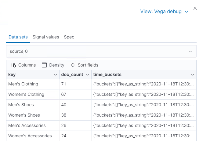

Debug the warning
To generate the data, Vega-Lite uses the source_0 and data_0. source_0 contains the results from the Elasticsearch query, and data_0 contains the visually encoded results that are shown on the chart. To debug the warning, compare source_0 and data_0.
  1. In the toolbar, click Inspect.
  2. From the View dropdown, select Vega debug.
  3. From the dropdown, select source_0.
    Table for data_0 with columns key
  4. To compare to the visually encoded data, select data_0 from the dropdown.
    Table for data_0 where the key is NaN instead of a string
    key is unable to convert because the property is category (Men's Clothing, Women's Clothing, etc.) instead of a timestamp.

Vega debugging
With the Vega debug view, you can inspect the Data sets and Signal Values runtime data.
The runtime data is read from the runtime scope.
vega tutorial inspect data sets
