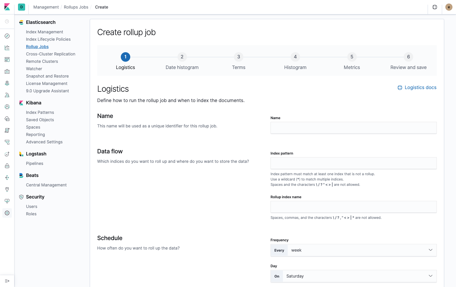

Create a rollup job
editKibana makes it easy for you to create a rollup job by walking you through the process. You fill in the name, data flow, and how often you want to roll up the data. Then you define a date histogram aggregation for the rollup job and optionally terms, histogram, and metrics aggregations.
When defining the index pattern, you must enter a name that is different than
the output rollup index. Otherwise, the job
will attempt to capture the data in the rollup index. For example, if your index pattern is metricbeat-*,
you can name your rollup index rollup-metricbeat, but not metricbeat-rollup.

Create the rollup job
editAs you walk through the Create rollup job UI, enter the data:
| Field | Value |
Name |
logs_job |
Index pattern |
Rollup index name |
Frequency |
Every day at midnight |
Page size |
1000 |
Delay (latency buffer) |
7d |
Date field |
@timestamp |
Time bucket size |
60m |
Time zone |
UTC |
Terms |
geo.src, machine.os.keyword |
Histogram |
bytes, memory |
Histogram interval |
1000 |
Metrics |
bytes (average) |
The terms, histogram, and metrics fields reflect the key information to retain in the rolled up data: where visitors are from (geo.src), what operating system they are using (machine.os.keyword), and how much data is being sent (bytes).
