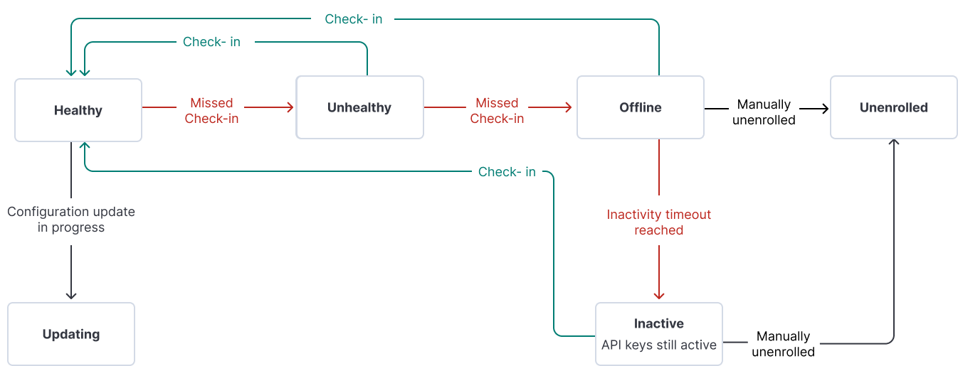

The following diagram shows the flow of Elastic Agent statuses:
Diagram showing the flow of Fleet Agent statuses

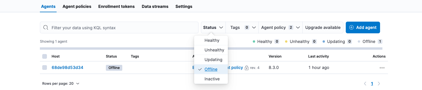

To filter the list of agents by status, click the Status dropdown and select one or more statuses.
Agent Status dropdown with multiple statuses selected

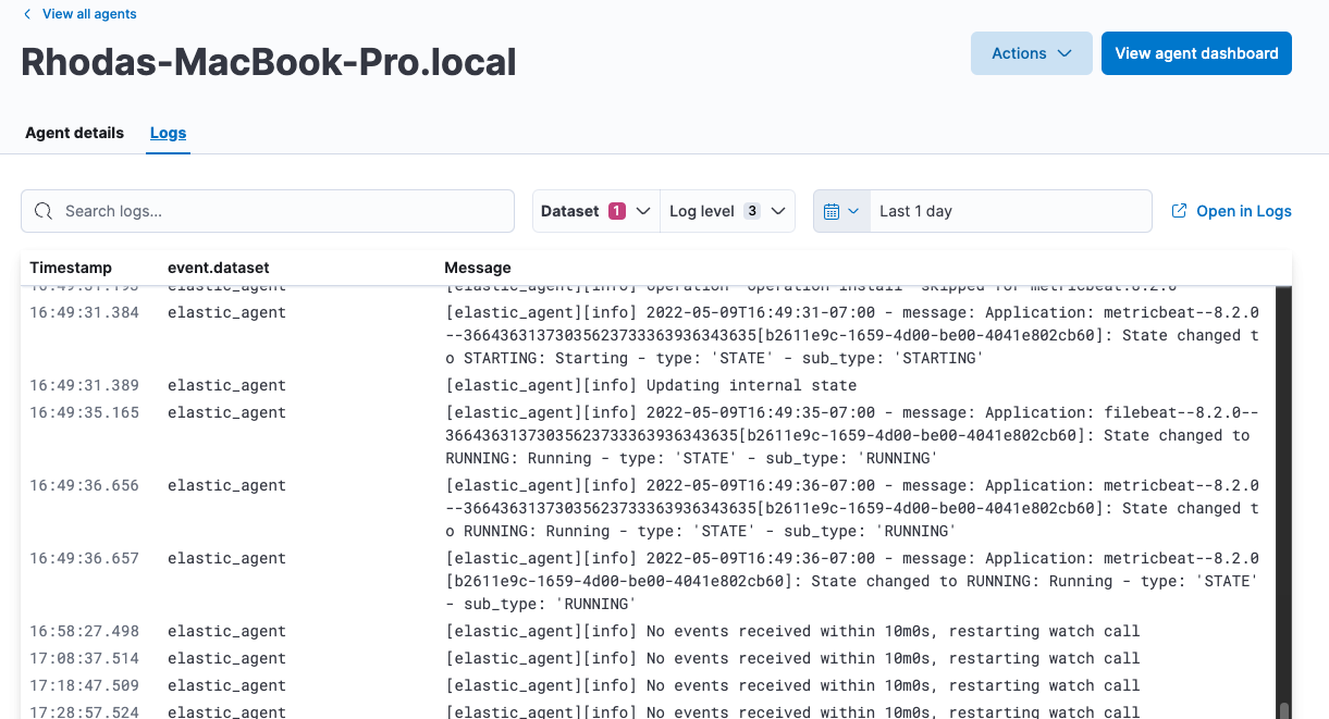

  4. Click the Logs tab.
    View agent logs under agent details
On the Logs tab you can filter, search, and explore the agent logs:
  • Use the search bar to create structured queries using Kibana Query Language.
  • Choose one or more datasets to show logs for specific programs, such as Filebeat or Fleet Server.
    Fleet showing datasets for logging
  • Change the log level to filter the view by log levels. Want to see debugging logs? Refer to Change the logging level.
  • Change the time range to view historical logs.
  • Click Open in Logs to tail agent log files in real time. For more information about logging, refer to Tail log files.

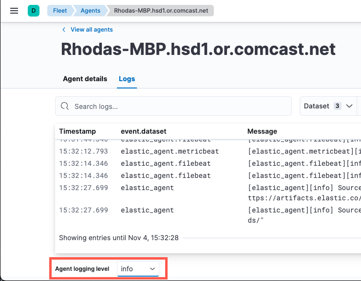

The logging level for monitored agents is set to info by default. You can change the agent logging level, for example, to turn on debug logging remotely:
  1. After navigating to the Logs tab as described in View agent logs, scroll down to find the Agent logging level setting.
    {Logs} tab showing the agent logging level setting
  2. Select an Agent logging level:
    error
    Logs errors and critical errors.
    warning
    Logs warnings, errors, and critical errors.
    info
    Logs informational messages, including the number of events that are published. Also logs any warnings, errors, or critical errors.
    debug
    Logs debug messages, including a detailed printout of all events flushed. Also logs informational messages, warnings, errors, and critical errors.
  3. Click Apply changes to apply the updated logging level to the agent.

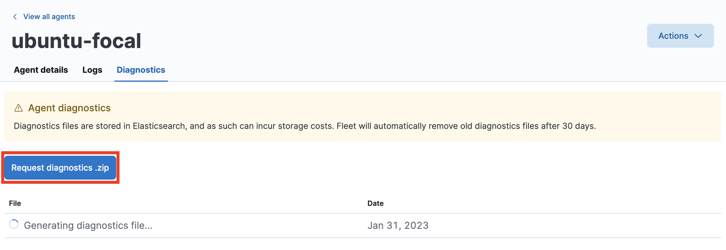

Fleet provides the ability to remotely generate and gather an Elastic Agent’s diagnostics bundle. An agent can gather and upload diagnostics if it is online in a Healthy or Unhealthy state. To download the diagnostics bundle for local viewing:
  1. In Kibana, go to Management → Fleet → Agents.
  2. In the Host column, click the agent’s name.
  3. Click the Diagnostics tab.
  4. Click the Request diagnostics .zip button.
    Collect agent diagnostics under agent details
Any in-progress or previously collected bundles for the Elastic Agent will be listed on this page.
Note that the bundles are stored in Elasticsearch and will be removed after 30 days.

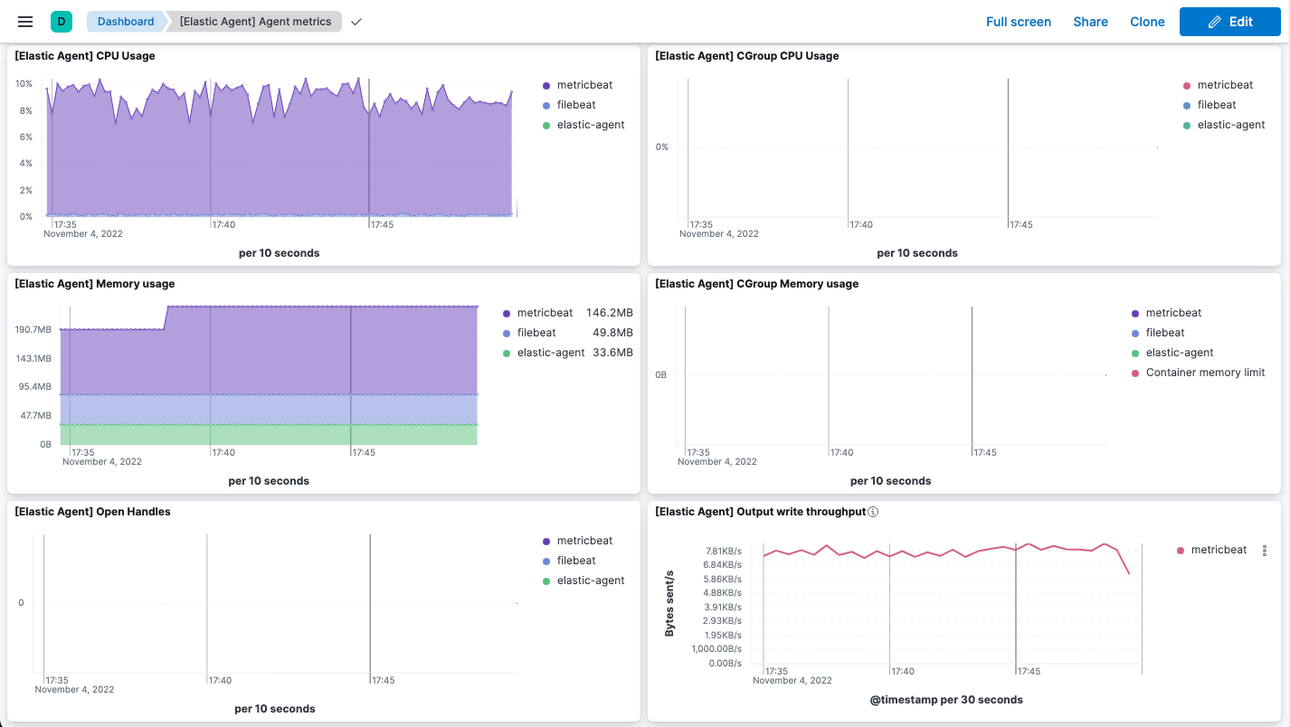

When agent monitoring is configured to collect metrics (the default), you can use the [Elastic Agent] Agent metrics dashboard in Kibana to view details about Elastic Agent resource usage, event throughput, and errors. This information can help you identify problems and make decisions about scaling your deployment.
To view agent metrics:
  3. On the Agent details tab, verify that Monitor metrics is enabled. If it’s not, refer to Change Elastic Agent monitoring settings.
  4. Click View more agent metrics to navigate to the [Elastic Agent] Agent metrics dashboard.
    Screen capture showing Elastic Agent metrics
The dashboard uses standard Kibana visualizations that you can extend to meet your needs.
