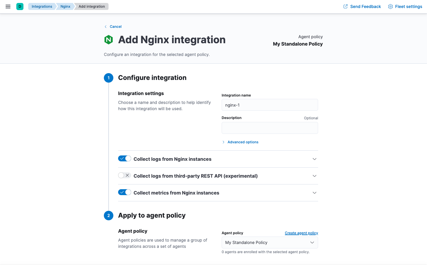

  2. Click the integration to see more details about it, then click Add <Integration>.
    Add Nginx integration screen with agent policy selected

  3. Under Configure integration, enter a name and description for the integration.
  4. Click the down arrow next to enabled streams and make sure the settings are correct for your host.
  5. Under Apply to agent policy, select an existing policy, or click Create agent policy and create a new one.
  6. When you’re done, save and continue.

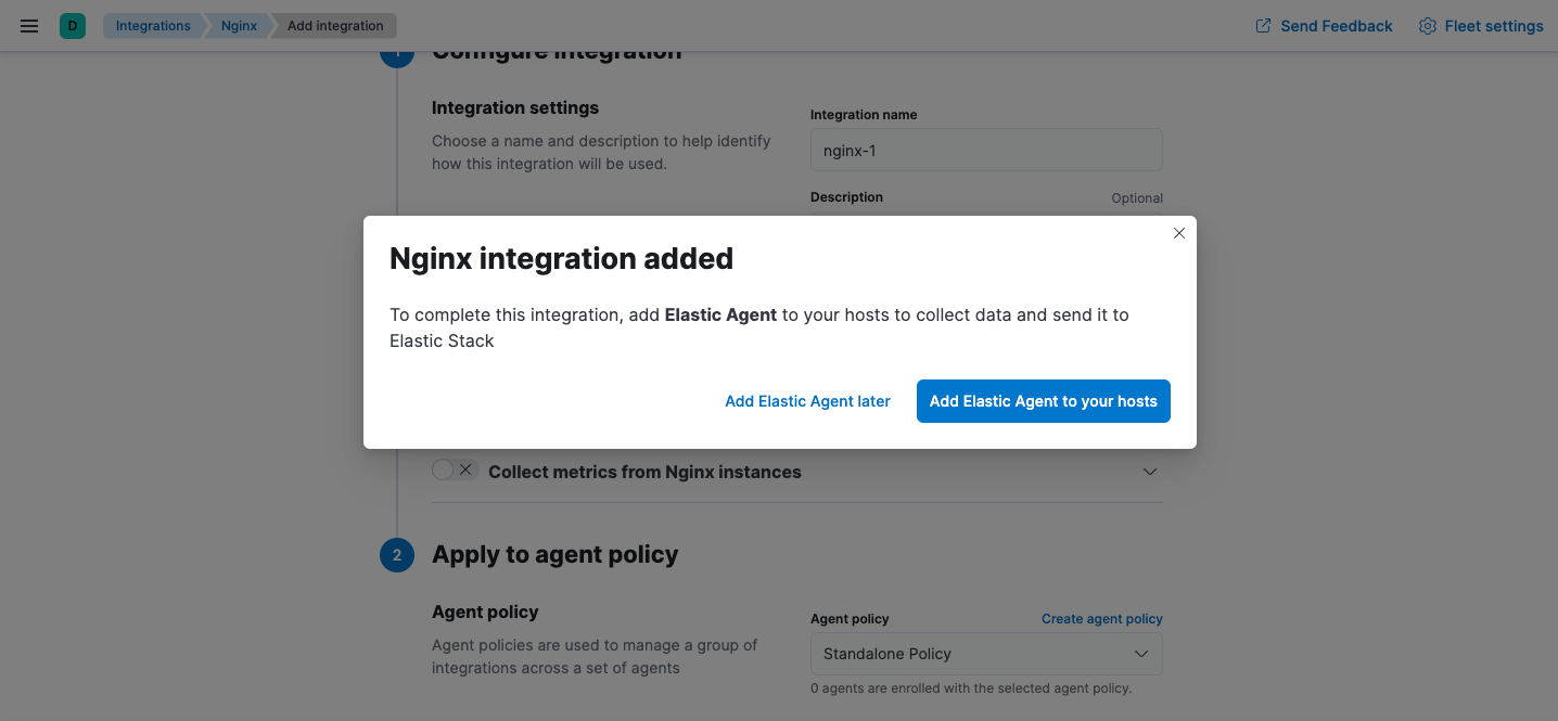

    A popup window gives you the option to add Elastic Agent to your hosts.
    Popup window showing the option to add Elastic Agent to your hosts
  7. (Optional) To add more integrations to the agent policy, click Add Elastic Agent later and go back to the Integrations page. Repeat the previous steps for each integration.
  8. When you’re done adding integrations, in the popup window, click Add Elastic Agent to your hosts to open the Add agent flyout.

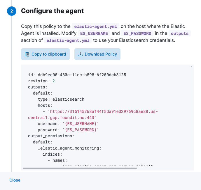

  10. Click Download Policy to download the policy file.
    Add data screen with option to download the default agent policy
The downloaded policy already contains a default Elasticsearch address and port for your setup. You may need to change them if you use a proxy or load balancer. Modify the policy, as required, making sure that you provide credentials for connecting to Elasticsearch
