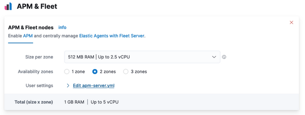

First modify your Fleet deployment settings in Elastic Cloud:
  1. Log in to Elastic Cloud and go to your deployment.
  2. Under Deployments > deployment name, click Edit.
  3. Under APM & Fleet:
    • Modify the compute resources available to the server to accommodate a higher scale of Elastic Agents
    • Modify the availability zones to satisfy fault tolerance requirements
    For recommended settings, refer to Scaling recommendations (Elastic Cloud).

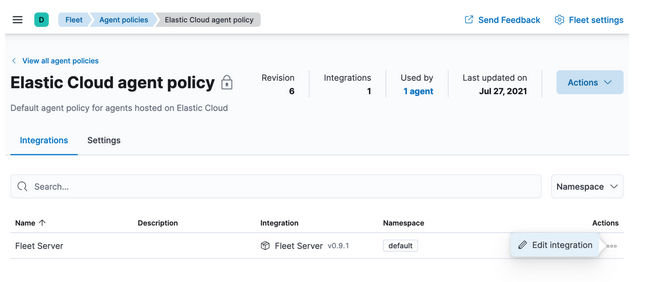

Next modify the Fleet Server configuration by editing the agent policy:
  1. In Fleet, click Agent Policies. Click on the Elastic Cloud agent policy to edit it.
  2. Open the Actions menu and select Edit integration.
    Elastic Cloud policy

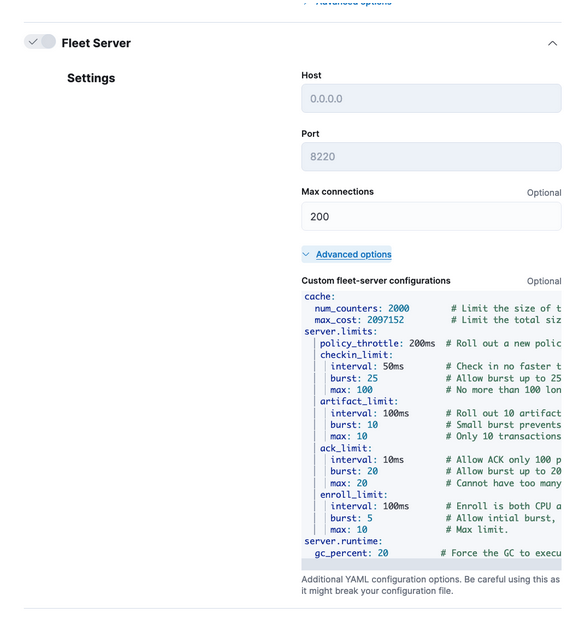

  3. Under Fleet Server, modify Max Connections and other advanced settings as described in Scaling recommendations (Elastic Cloud).
Advanced Fleet Server optionsedit
The following advanced settings are available to fine tune your Fleet Server deployment.
cache
num_counters
Size of the hash table. Best practice is to have this set to 10x max connections.
max_cost
Total size of the cache.
server.limits
policy_throttle
How often a new policy is rolled out to the agents.
checkin_limit.interval
How fast the agents can check in to the Fleet Server.
checkin_limit.burst
Burst of check-ins allowed before falling back to the rate defined by interval.
checkin_limit.max
Maximum number of agents.
artifact_limit.max
Maximum number of agents that can call the artifact API concurrently. It allows the user to avoid overloading the Fleet Server from artifact API calls.
artifact_limit.interval
How often artifacts are rolled out. Default of 100ms allows 10 artifacts to be rolled out per second.
artifact_limit.burst
Number of transactions allowed for a burst, controlling oversubscription on outbound buffer.
ack_limit.max
Maximum number of agents that can call the Ack API concurrently. It allows the user to avoid overloading the Fleet Server from Ack API calls.
ack_limit.interval
How often an acknowledgment (ACK) is sent. Default value of 10ms enables 100 ACKs per second to be sent.
ack_limit.burst
Burst of ACKs to accommodate (default of 20) before falling back to the rate defined in interval.
enroll_limit.max
Maximum number of agents that can call the Enroll API concurrently. This setting allows the user to avoid overloading the Fleet Server from Enrollment API calls.
enroll_limit.interval
Interval between processing enrollment request. Enrollment is both CPU and RAM intensive, so the number of enrollment requests needs to be limited for overall system health. Default value of 100ms allows 10 enrollments per second.
enroll_limit.burst
Burst of enrollments to accept before falling back to the rate defined by interval.
