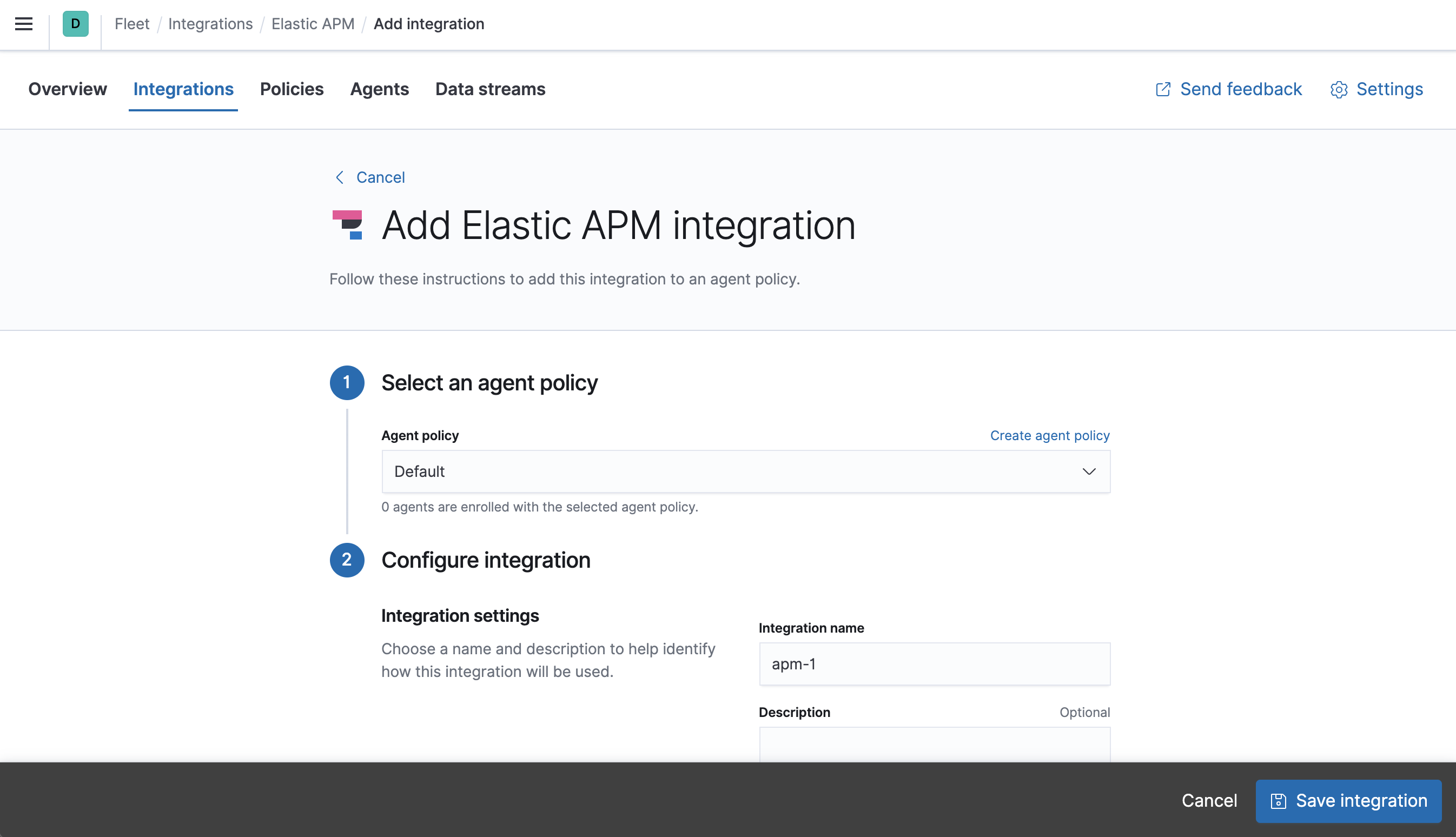

Step 3: Add the APM integration

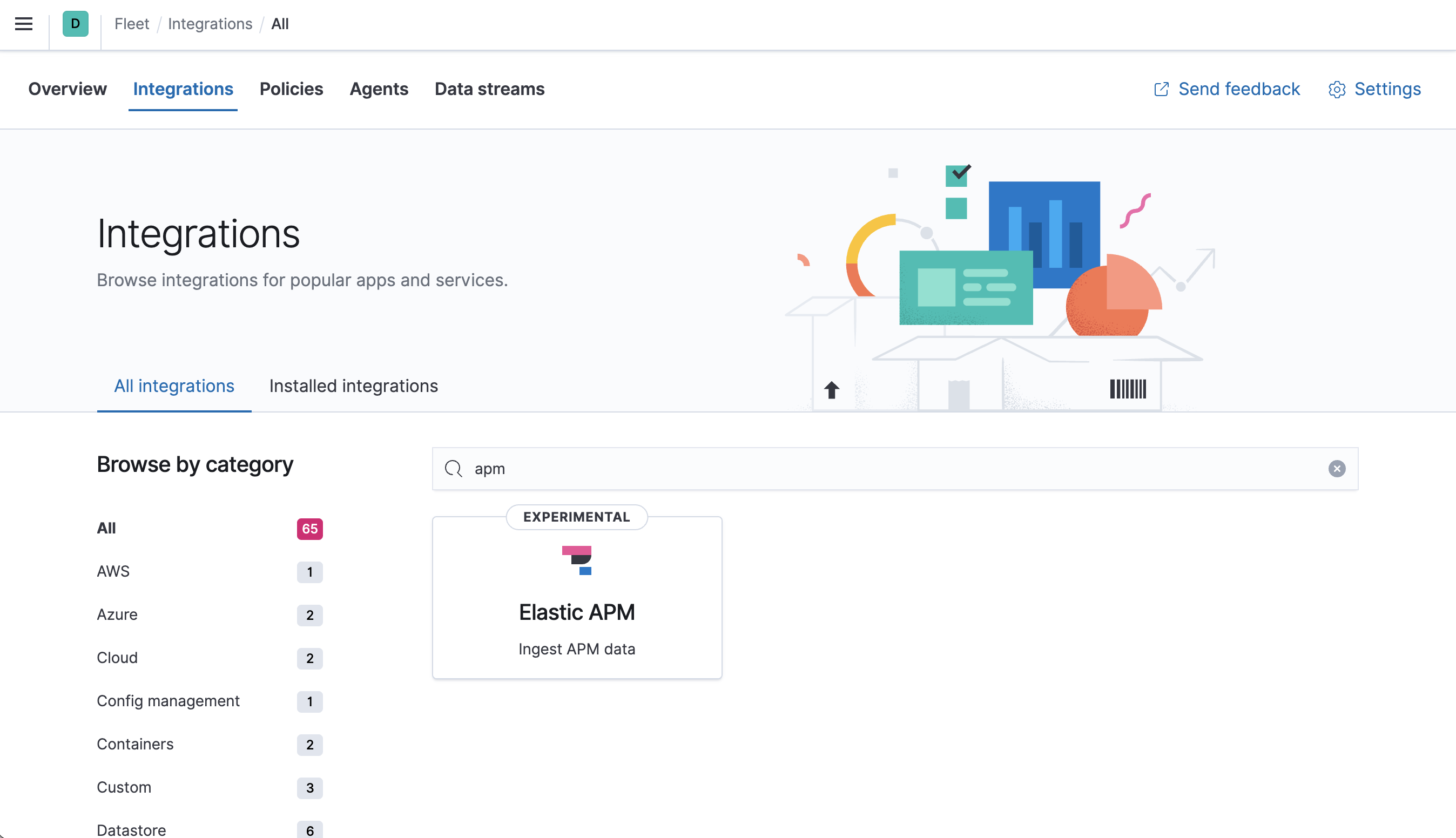

editNext, you’ll browse a catalog of integrations, then add an APM integration to the default policy used by your agent. You use policies to manage settings across a group of agents. An agent policy may contain any number of integrations for collecting observability data from the various services running on your host.
In Kibana, go back to Management > Fleet, and click the Integrations tab. Use the search bar to find the Elastic APM integration.

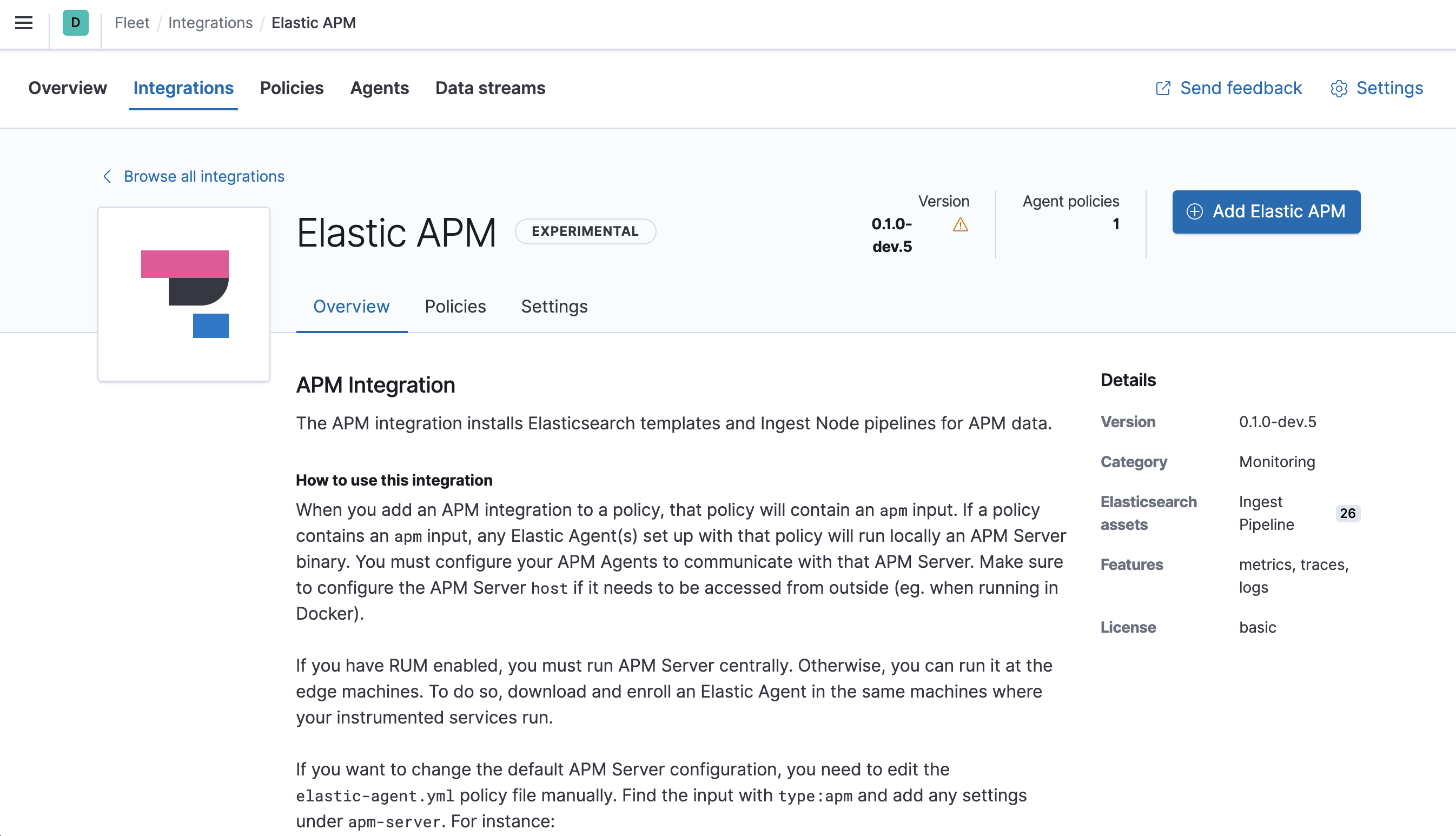

Click the APM integration to see more details about it, then click Add Elastic APM.
On the Add APM integration page, select the default policy.
In this guide, you add integrations to the default policy created by Kibana. After you learn the basics, you can create your own policies and assign them to agents.
- Under Configure integration, click the down arrow next to Collect application traces. Under Host, define the host and port where APM Server will listen. Inspect or change other settings.
When you’re done, save and deploy the changes.
The newly added APM integration should appear under Integrations in the default policy, along with the default
system-1integration.
