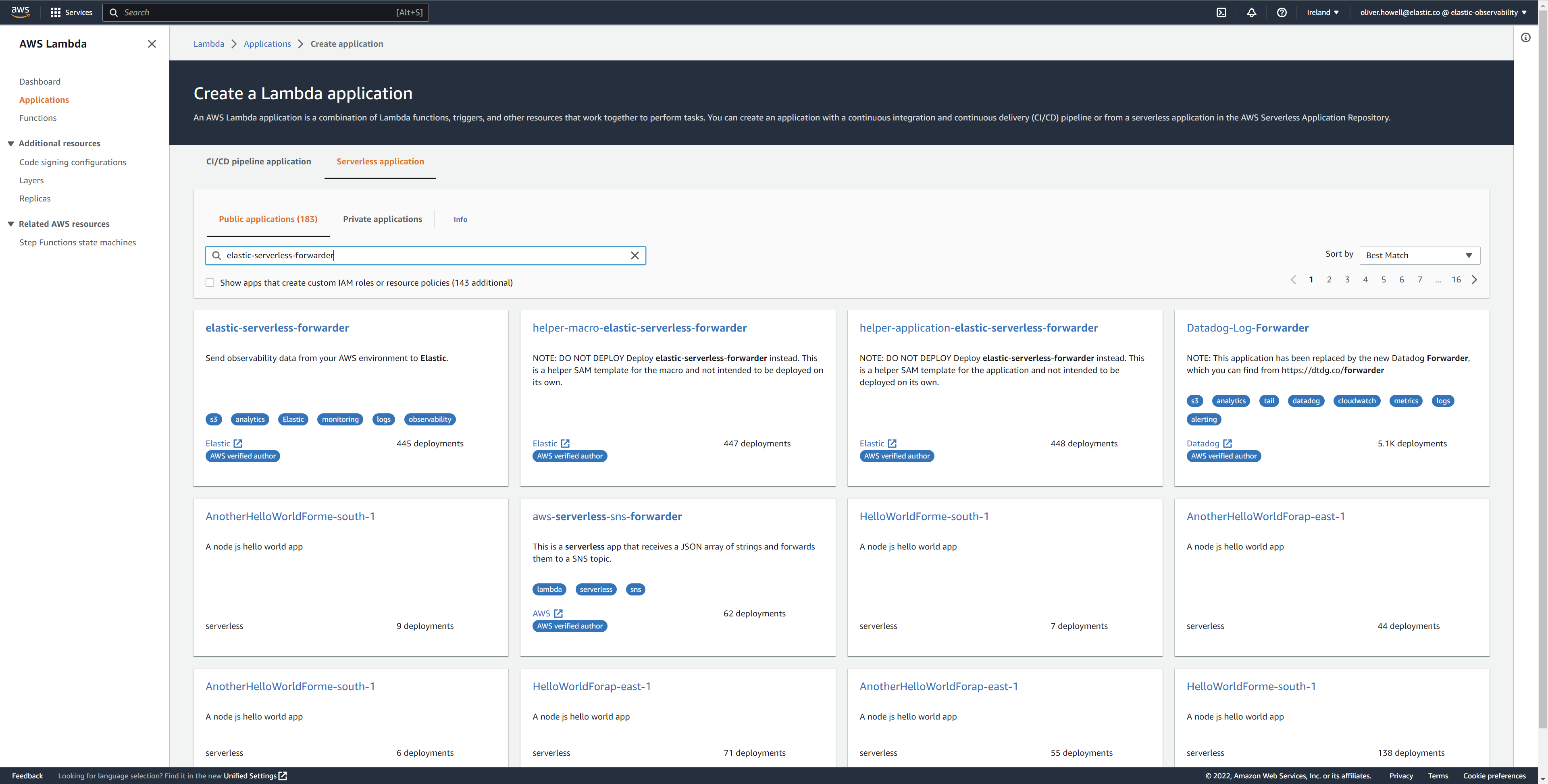

- Log in to AWS console and open Lambda.
- Click Applications and then Create application.
- Click Serverless application and search for elastic-serverless-forwarder.
Select elastic-serverless-forwarder from the search results (ignoring any application beginning helper-).
- Complete the Application settings according to Define deployment parameters.
- After your settings have been added, click Deploy.
- On the Applications page for serverlessrepo-elastic-serverless-forwarder, click Deployments.
