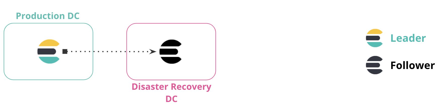

Single disaster recovery datacenteredit
In this configuration, data is replicated from the production datacenter to the disaster recovery datacenter. Because the follower indices replicate the leader index, your application can use the disaster recovery datacenter if the production datacenter is unavailable.

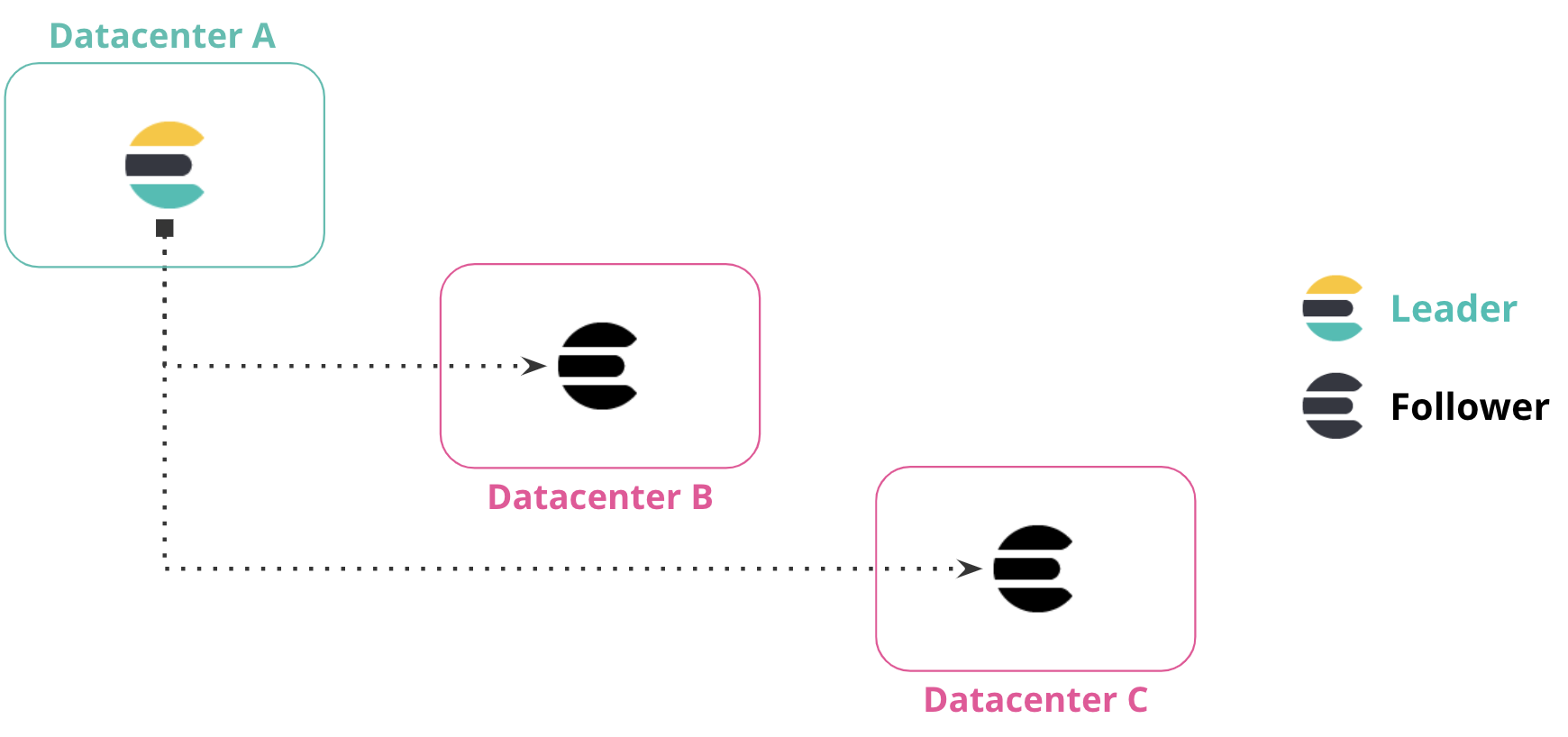

Multiple disaster recovery datacentersedit
You can replicate data from one datacenter to multiple datacenters. This configuration provides both disaster recovery and high availability, ensuring that data is replicated in two datacenters if the primary datacenter is down or unavailable.
In the following diagram, data from Datacenter A is replicated to Datacenter B and Datacenter C, which both have a read-only copy of the leader index from Datacenter A.

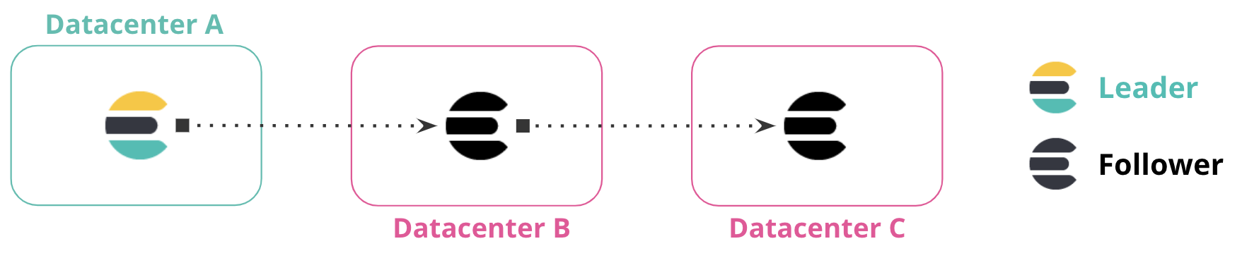

Chained replicationedit
You can replicate data across multiple datacenters to form a replication chain. In the following diagram, Datacenter A contains the leader index. Datacenter B replicates data from Datacenter A, and Datacenter C replicates from the follower indices in Datacenter B. The connection between these datacenters forms a chained replication pattern.

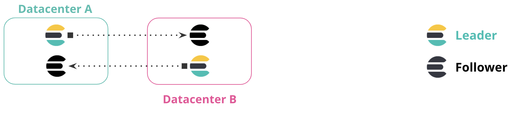

Bi-directional replicationedit
In a bi-directional replication setup, all clusters have access to view all data, and all clusters have an index to write to without manually implementing failover. Applications can write to the local index within each datacenter, and read across multiple indices for a global view of all information.
This configuration requires no manual intervention when a cluster or datacenter is unavailable. In the following diagram, if Datacenter A is unavailable, you can continue using Datacenter B without manual failover. When Datacenter A comes online, replication resumes between the clusters.
This configuration is particularly useful for index-only workloads, where no updates to document values occur. In this configuration, documents indexed by Elasticsearch are immutable. Clients are located in each datacenter alongside the Elasticsearch cluster, and do not communicate with clusters in different datacenters.

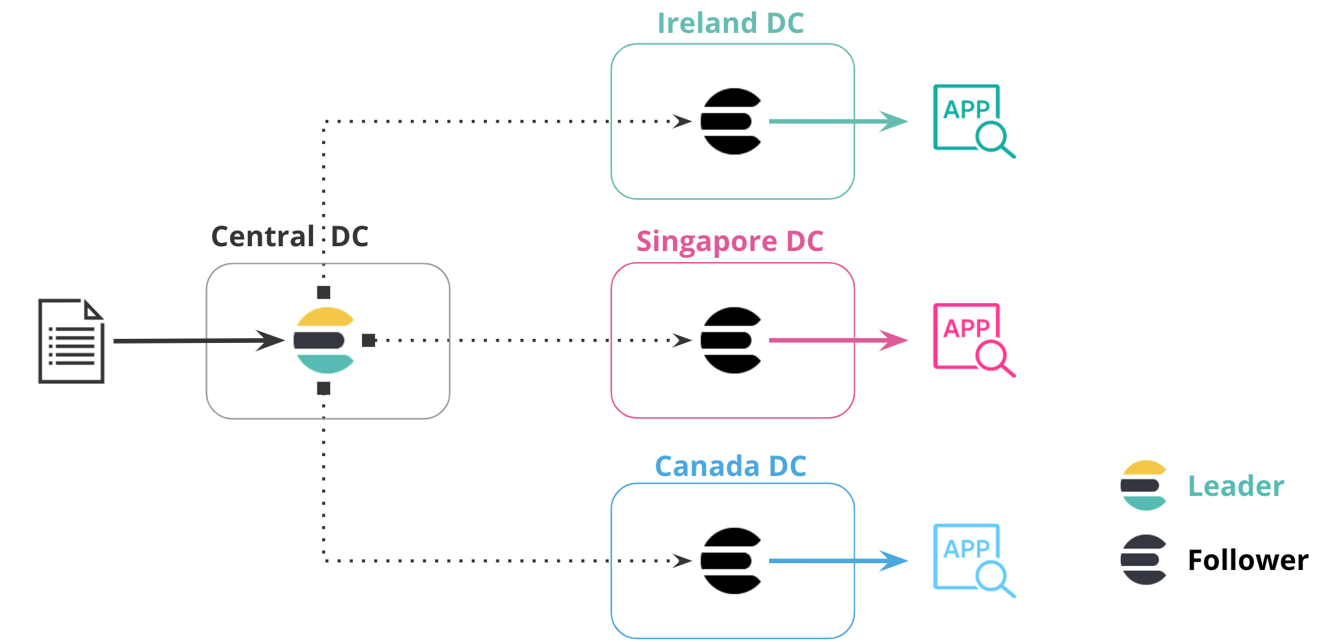

Data localityedit
Bringing data closer to your users or application server can reduce latency and response time. This methodology also applies when replicating data in Elasticsearch. For example, you can replicate a product catalog or reference dataset to 20 or more datacenters around the world to minimize the distance between the data and the application server.
In the following diagram, data is replicated from one datacenter to three additional datacenters, each in their own region. The central datacenter contains the leader index, and the additional datacenters contain follower indices that replicate data in that particular region. This configuration puts data closer to the application accessing it.

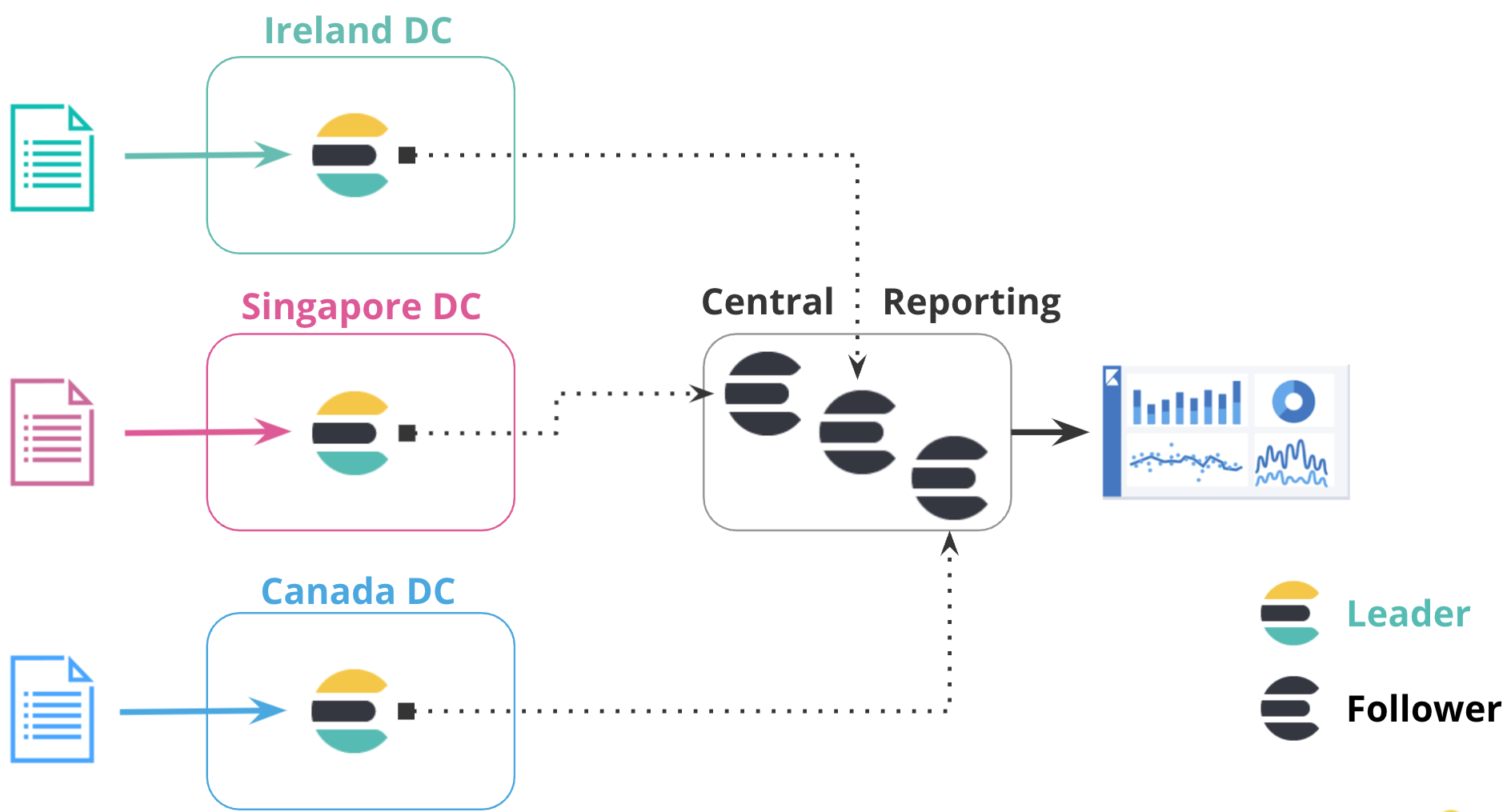

Centralized reportingedit
Using a centralized reporting cluster is useful when querying across a large network is inefficient. In this configuration, you replicate data from many smaller clusters to the centralized reporting cluster.
For example, a large global bank might have 100 Elasticsearch clusters around the world that are distributed across different regions for each bank branch. Using cross-cluster replication, the bank can replicate events from all 100 banks to a central cluster to analyze and aggregate events locally for reporting. Rather than maintaining a mirrored cluster, the bank can use cross-cluster replication to replicate specific indices.
In the following diagram, data from three datacenters in different regions is replicated to a centralized reporting cluster. This configuration enables you to copy data from regional hubs to a central cluster, where you can run all reports locally.
