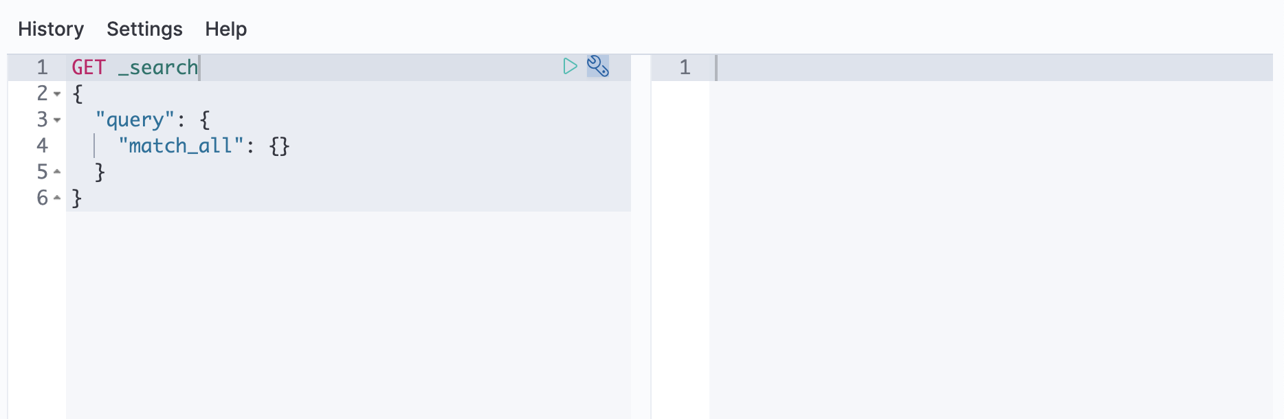

Use Kibana
Open Kibana’s main menu and go to Dev Tools > Console.
Run the following example API request in the console:
$response = $client->info();
resp = client.info() print(resp)
response = client.info puts response
res, err := es.Info() fmt.Println(res, err)
const response = await client.info() console.log(response)
GET /

Use Kibana
GET /
