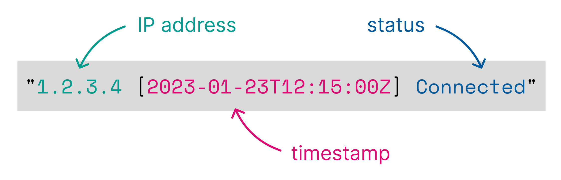

For example, the following pattern:
%{clientip} [%{@timestamp}] %{status}
matches a log line of this format:
1.2.3.4 [2023-01-23T12:15:00.000Z] Connected
and results in adding the following columns to the input table:
| clientip:keyword | @timestamp:keyword | status:keyword |
1.2.3.4 |
2023-01-23T12:15:00.000Z |
Connected |
%{IP:ip} \[%{TIMESTAMP_ISO8601:@timestamp}\] %{GREEDYDATA:status}
