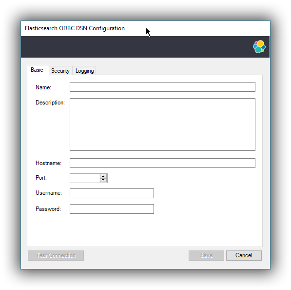

This action closes the previously opened second window and open a new one instead, Elasticsearch SQL ODBC Driver’s DSN Editor:
Elasticsearch SQL ODBC Driver DSN Editordsn editor basic
This new window has three tabs, each responsible for a set of configuration parameters, as follows.
2.2 Connection parametersedit
This tab allows configuration for the following items:
  • Name
    This is the name the DSN will be referred by.
    The characters available for this field are limited to the set permitted for a Registry key.
    Example: localhost
  • Description
    This field allows a arbitrary text; generally used for short notes about the configured connection.
    Example: Clear-text connection to the local [::1]:9200.
  • Hostname
    This field requires an IP address or a resolvable DNS name of the Elasticsearch instance that the driver will connect to.
    Example: ::1
  • Port
    The port on which the Elasticsearch listens on.
    If left empty, the default 9200 port number will be used.
  • Username, Password
    If security is enabled, these fields will need to contain the credentials of the user configured to access the REST SQL endpoint.
At a minimum, the Name and Hostname fields must be provisioned, before the DSN can be saved.
Connection encryption is enabled by default. This will need to be changed if connecting to a SQL API endpoint with no cryptography enabled.

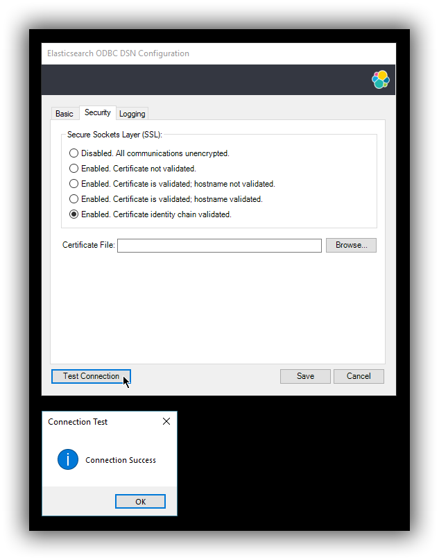

2.3 Cryptography parametersedit
One of the following SSL options can be chosen:
  • Disabled. All communications unencrypted.
    The communication between the driver and the Elasticsearch instance is performed over a clear-text connection.
    This setting can expose the access credentials to a 3rd party intercepting the network traffic and is not recommended.
  • Enabled. Certificate not validated.
    The connection encryption is enabled, but the certificate of the server is not validated.
    This is currently the default setting.
    This setting allows a 3rd party to act with ease as a man-in-the-middle and thus intercept all communications.
  • Enabled. Certificate is validated; hostname not validated.
    The connection encryption is enabled and the driver verifies that server’s certificate is valid, but it does not verify if the certificate is running on the server it was meant for.
    This setting allows a 3rd party that had access to server’s certificate to act as a man-in-the-middle and thus intercept all the communications.
  • Enabled. Certificate is validated; hostname validated.
    The connection encryption is enabled and the driver verifies that both the certificate is valid, as well as that it is being deployed on the server that the certificate was meant for.
  • Enabled. Certificate identity chain validated.
    This setting is equivalent to the previous one, with one additional check against certificate’s revocation. This offers the strongest security option and is the recommended setting for production deployments.
  • Certificate File
    In case the server uses a certificate that is not part of the PKI, for example using a self-signed certificate, you can configure the path to a X.509 certificate file that will be used by the driver to validate server’s offered certificate.
    The driver will only read the contents of the file just before a connection is attempted. See 2.5 Testing the connection section further on how to check the validity of the provided parameters.
    The certificate file can not be bundled or password protected since the driver will not prompt for a password.
    If using the file browser to locate the certificate - by pressing the Browse…​ button - only files with .pem and .der extensions will be considered by default. Choose All Files (*.*) from the drop down, if your file ends with a different extension:
    Certificate file browserdsn editor security cert

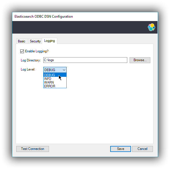

2.4 Logging parametersedit
For troubleshooting purposes, the Elasticsearch SQL ODBC Driver offers functionality to log the API calls that an application makes; this is enabled in the Administrator application:
Enable Application ODBC API loggingadministrator tracing
However, this only logs the ODBC API calls made by the application into the Driver Manager and not those made by the Driver Manager into the driver itself. To enable logging of the calls that the driver receives, as well as internal driver processing events, you can enable driver’s logging on Editor’s Logging tab:
  • Enable Logging?
    Ticking this will enable driver’s logging. A logging directory is also mandatory when this option is enabled (see the next option). However the specified logging directory will be saved in the DSN if provided, even if logging is disabled.
  • Log Directory
    Here is to specify which directory to write the log files in.
    The driver will create one log file per connection, for those connections that generate logging messages.
  • Log Level
    Configure the verbosity of the logs.
    Enable driver loggingdsn editor logging
    When authentication is enabled, the password will be redacted from the logs.
Debug-logging can quickly lead to the creation of many very large files and generate significant processing overhead. Only enable if instructed so and preferably only when fetching low volumes of data.
2.5 Testing the connectionedit
Once the Hostname, the Port (if different from implicit default) and the SSL options are configured, you can test if the provided parameters are correct by pressing the Test Connection button. This will instruct the driver to connect to the Elasticsearch instance and perform a simple SQL test query. (This will thus require a running Elasticsearch instance with the SQL plugin enabled.)
Connection testingdsn editor conntest
When connection testing, all the configured parameters are taken into account, including the logging configuration. This will allow early detection of potential file/directory access rights conflicts.
See Alternative logging configuration section further for an alternative way of configuring the logging.
