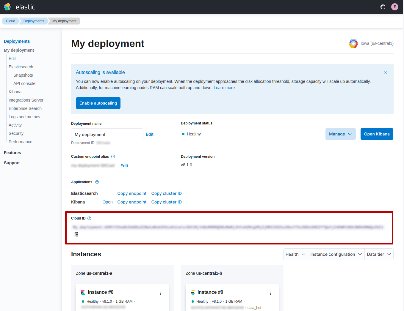

Where <cloud-id> and <api-key> can be retrieved using the Elastic Cloud web UI.
You can get the Cloud ID from the My deployment page of your dashboard (see the red rectangle reported in the screenshot).
Elastic Cloud ID

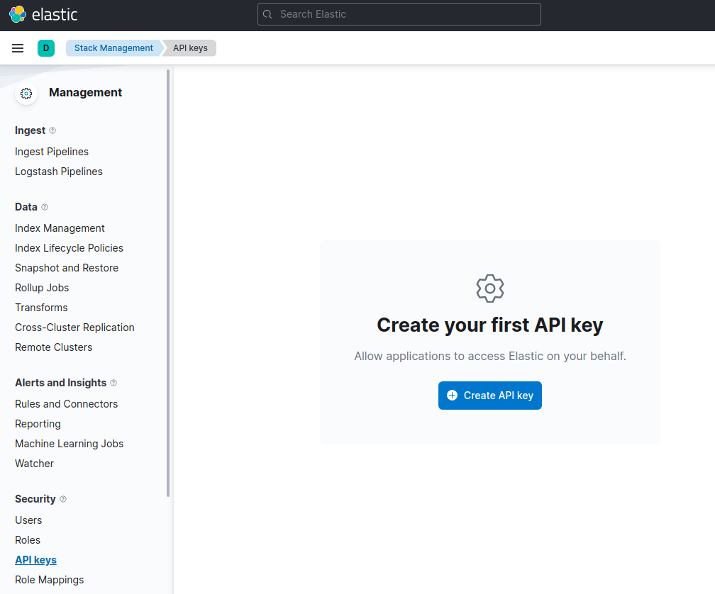

You can generate an API key in the Management page under the section Security.
Create API key

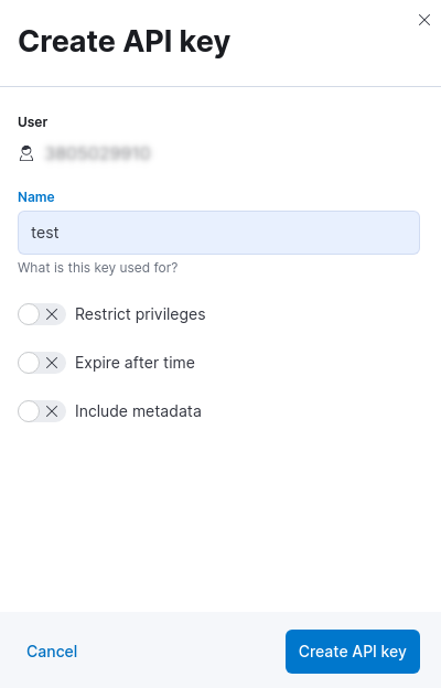

When you click on Create API key button you can choose a name and set the other options (eg. restrict privileges, expire after time, etc).
Choose an API name

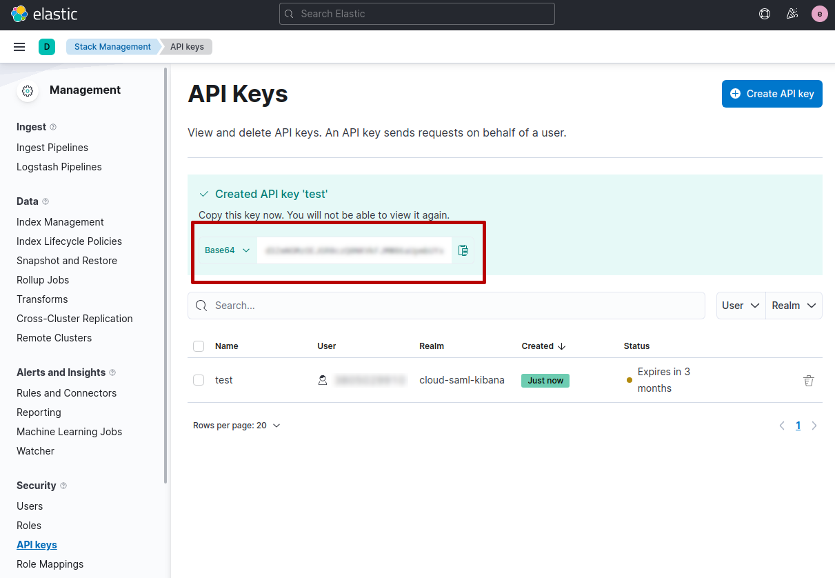

After this step you will get the `API key`in the API keys page.
Cloud API key
IMPORTANT: you need to copy and store the `API key`in a secure place, since you will not be able to view it again in Elastic Cloud.
