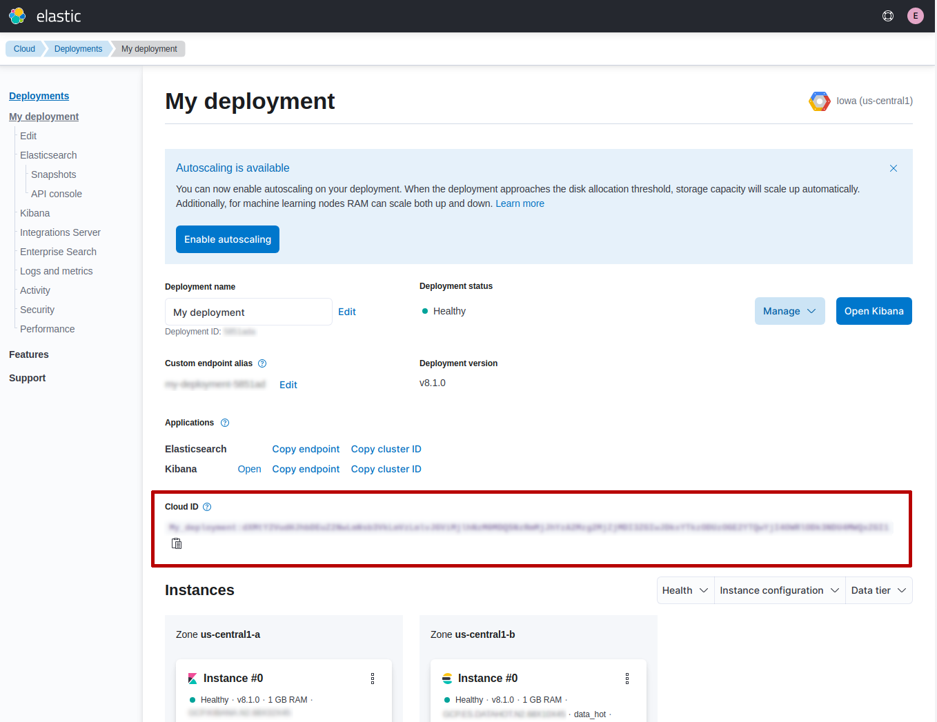

You can get the Cloud ID
from the My deployment
page of your dashboard (see the red
rectangle reported in the screenshot).

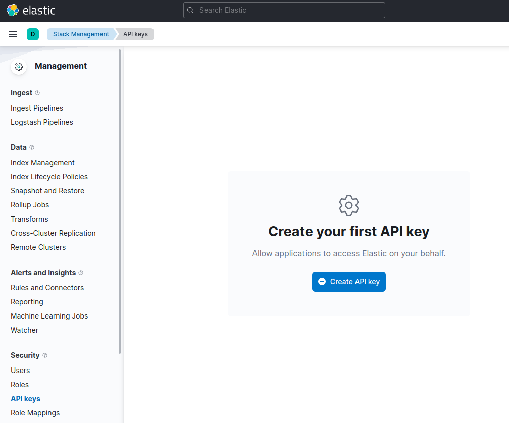

You can generate an API key
in the Management
page under the section Security

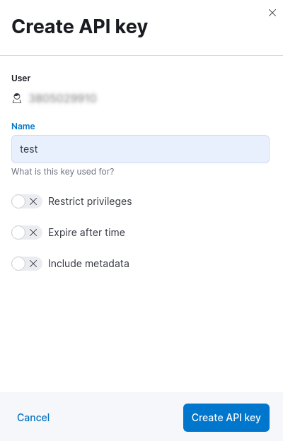

When you click on Create API key
button you can choose a name and set the other
options (eg. restrict privileges, expire after time, etc).

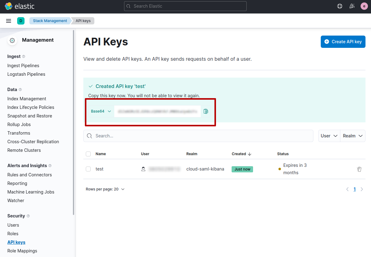

After this step you will get the `API key`in the API keys page.
IMPORTANT: you need to copy and store the `API key`in a secure place, since you will not be able to view it again in Elastic Cloud.
