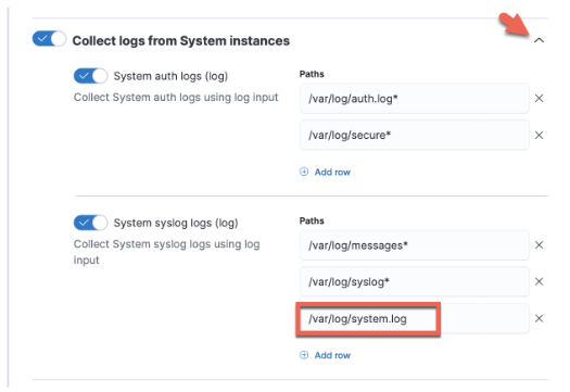

D.2. How to configure
editThere are three ways to configure Elastic Agent integrations:
D.2.1. Using the Kibana UI
editBest option for: Manual configuration and users who prefer using a UI over scripting.
Example: Get started with logs and metrics
Agent policies and integration settings can be managed using the Kibana UI. For example, the following shows the configuration of logging for the System integration in an Elastic Agent policy:
