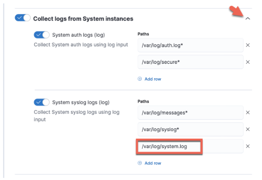

Appendix D - Agent Integration Guideedit
When configuring any integration in Elastic Agent, you need to set up integration settings within whatever policy is ultimately assigned to that agent.

D.2.1. Using the Kibana UIedit
Best option for: Manual configuration and users who prefer using a UI over scripting.
Example: Get started with logs and metrics
Agent policies and integration settings can be managed using the Kibana UI. For example, the following shows the configuration of logging for the System integration in an Elastic Agent policy:
Configuration of a logging integration in an agent policy
