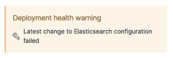

The Elasticsearch Service Deployments page shows the current status of your active deployments. From time to time you may get one or more health warnings, such as the following:
A screen capture of the deployment page showing a typical warning: Deployment health warning: Latest change to Elasticsearch configuration failed.
