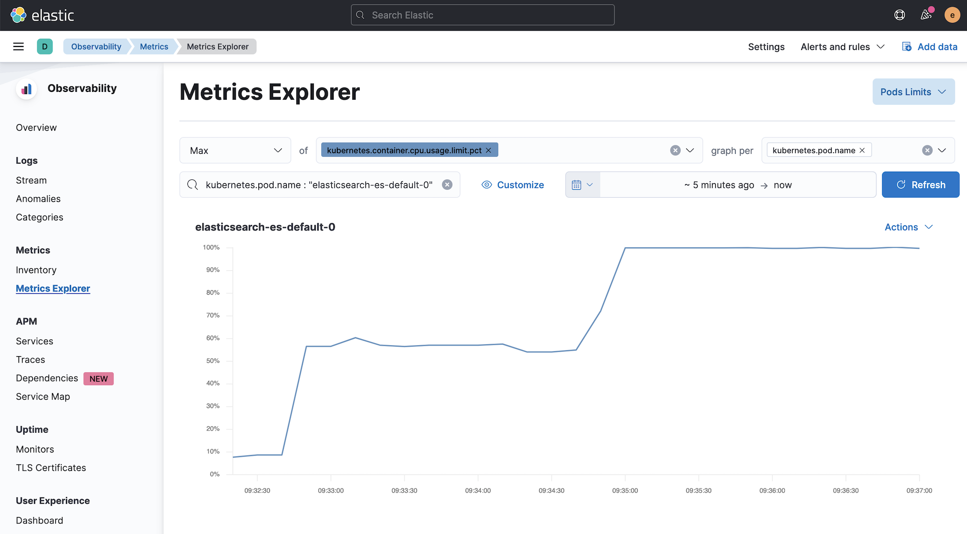

Using Beats
Metricbeat can collect the percentage of both the CPU and the memory limits used by each Pod (or total node allocatable if resource is not limited). The two relevant metrics are kubernetes.pod.cpu.usage.limit.pct for CPU, and kubernetes.pod.memory.usage.node.pct for memory.

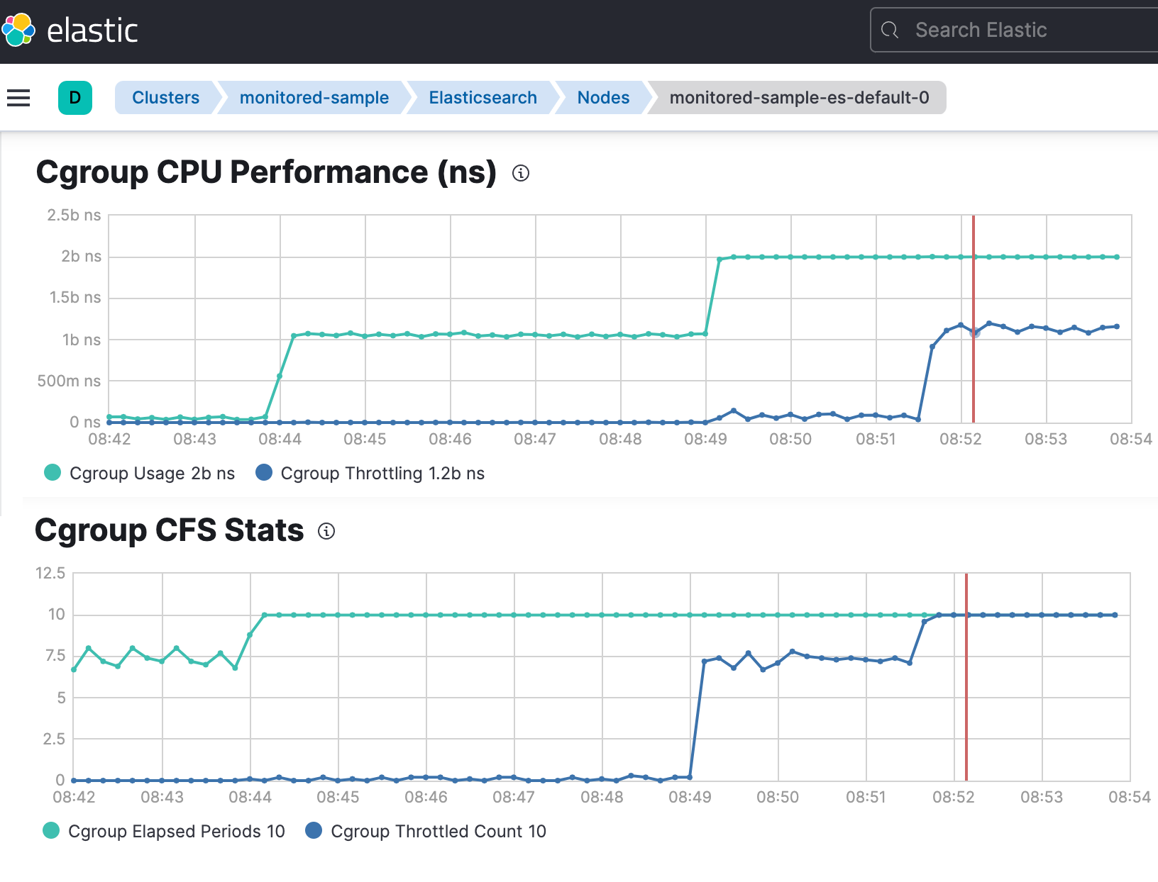

cgroup CPU perforamce chart
Monitoring Elasticsearch CPU using Stack Monitoring
If stack monitoring is enabled, the pressure applied by the CPU cgroup controller to an Elasticsearch node can be evaluated from the Stack Monitoring page in Kibana.

In the example below an Elasticsearch container is limited to 2 cores.
nodeSets:
- name: default
  count: 3
  podTemplate:
    spec:
      containers:
        - name: elasticsearch
          resources:
            limits:
              cpu: 2
The Cgroup usage curve shows that the CPU usage of this container has been steadily increasing up to 2 cores. Then, while the container was still requesting more CPU, the Cgroup Throttling curve shows how much the Elasticsearch container has been throttled:
