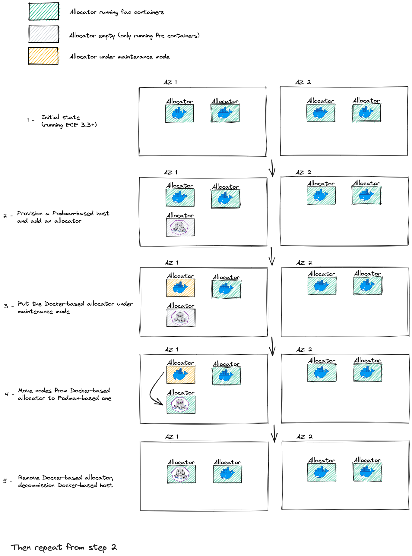

Step 1: Upgrade ECE to version >= 3.3.0 following the Upgrade your installation guidelines. Skip this step if your ECE installation is already running a version >= 3.3.0.
Step 2: Prepare an additional RHEL or Rocky Linux VM. We recommend using one additional VM to perform a rolling grow-and-shrink upgrade.
Step 3: Migrate each host one by one from Docker to Podman. This allows you to move workloads from Docker-based hosts to Podman-based ones without downtime. We highly recommend to allocate the additional Podman allocator to the same zone as the Docker allocator you want to replace. Assuming there is sufficient capacity, you may use existing docker-based hosts as the "new" Podman-based hosts. To reuse a host, you will first follow the steps to delete a host from the ECE deployment followed by the steps to remove ECE software from the host. The following diagram shows the conceptual steps.

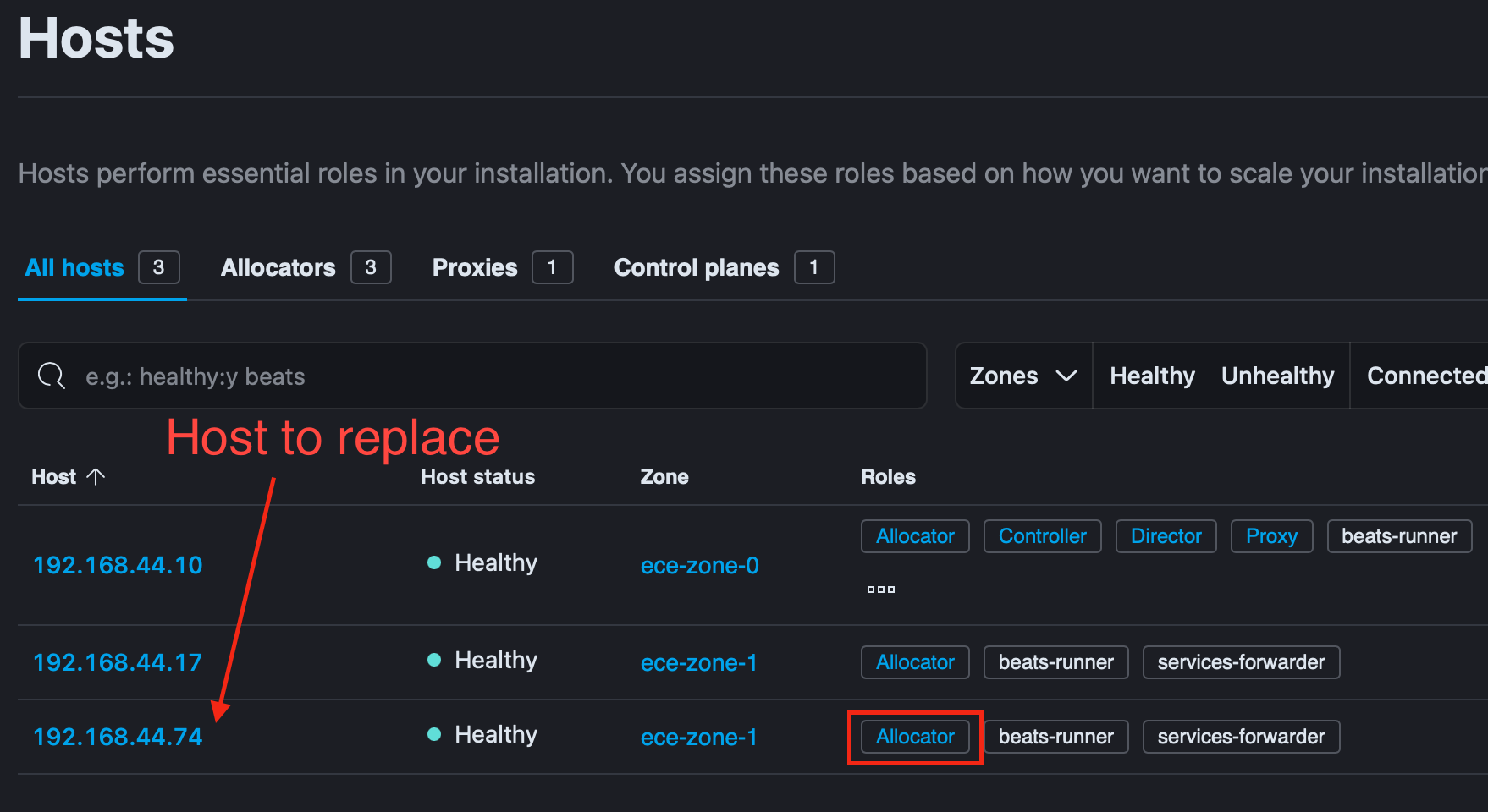

  5. Identify the host you want to replace with a podman-based host and copy the associated roles.
    Example 1 You want to migrate the Docker host 192.168.44.74 with the role Allocator to a podman host. Copy the role allocator.
    Migrate Allocator

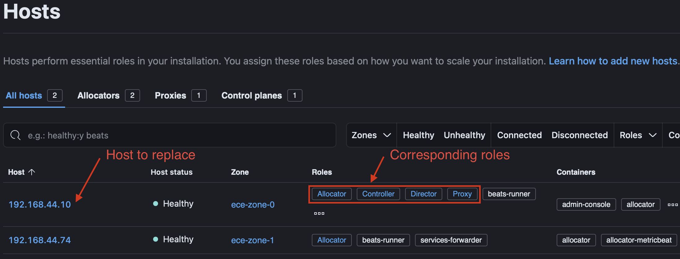

    Example 2 You want to migrate the Docker host 192.168.44.10 with the roles Allocator, Controller, Director, and Proxy to a podman host. Copy the roles allocator, coordinator, director, proxy.
    Migrate Allocator
    The role Controller in the admin console is called coordinator for the elastic-cloud-enterprise.sh script

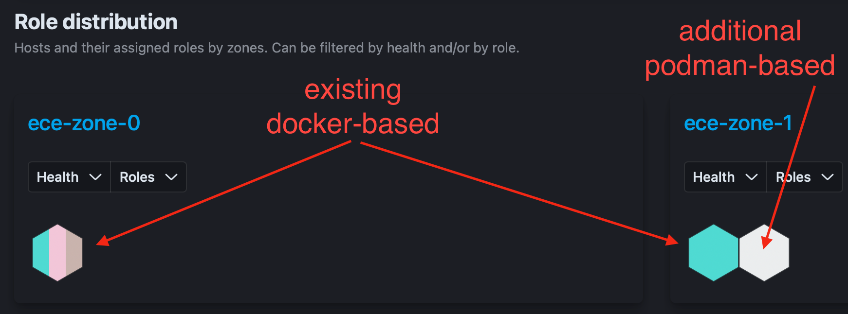

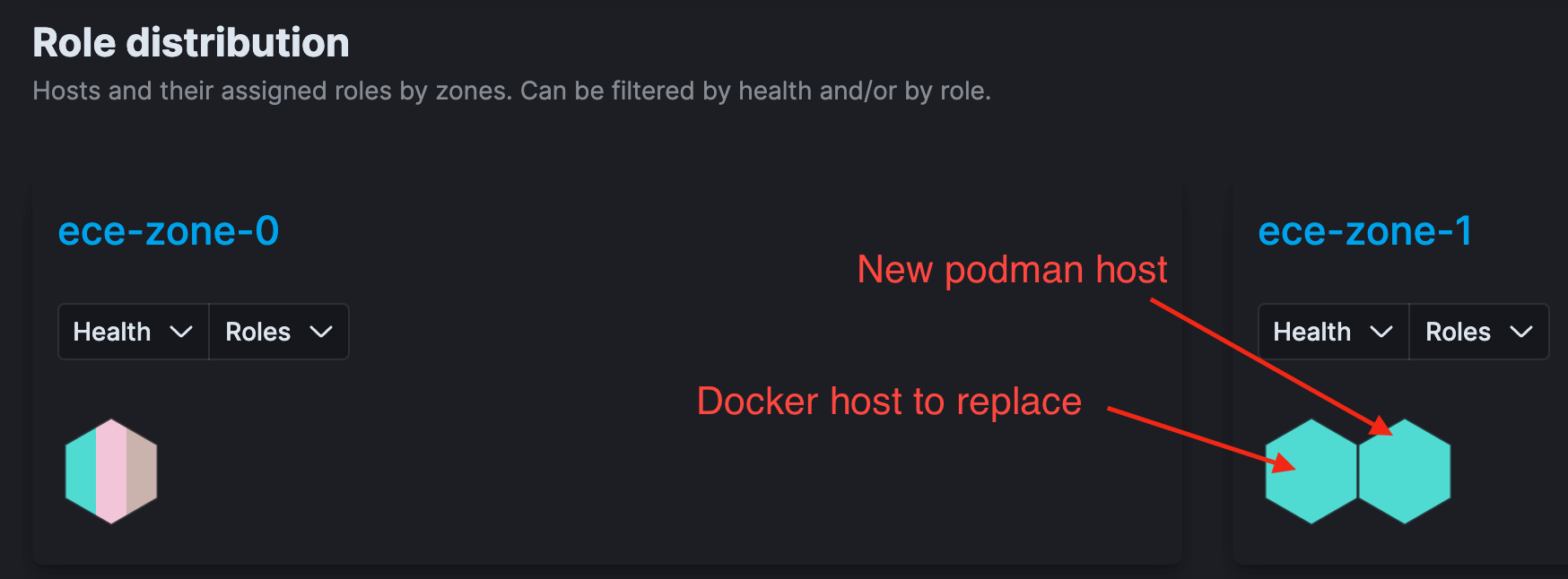

    2. Login to admin console
      Verify that the new podman host has the same roles (same coloring of the hexagon) as the Docker host you want to replace.
      The following screenshot shows the state where the correct roles have been applied. Both hosts in ece-zone-1 have the same color.
      Correct role
      The following screenshot shows the state where incorrect roles have been applied. The hosts in ece-zone-1 do not have the same coloring.
      Wrong role

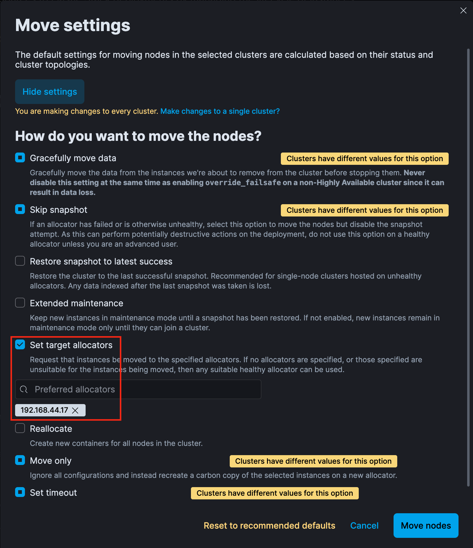

    3. Put the docker-based allocator you want to replace with a podman allocator in maintenance mode by following the Enable Maintenance Mode documentation.

    4. Move all instances from the Docker allocator to the podman allocator by following the Move Nodes From Allocators documentation.
      Make sure to specify the target podman allocator using the option “Set target allocators”.
      If you move admin console instances, you might update the URL in the browser before continuing with step 11.
      Move instances
      As an alternative, use the Move clusters API.
