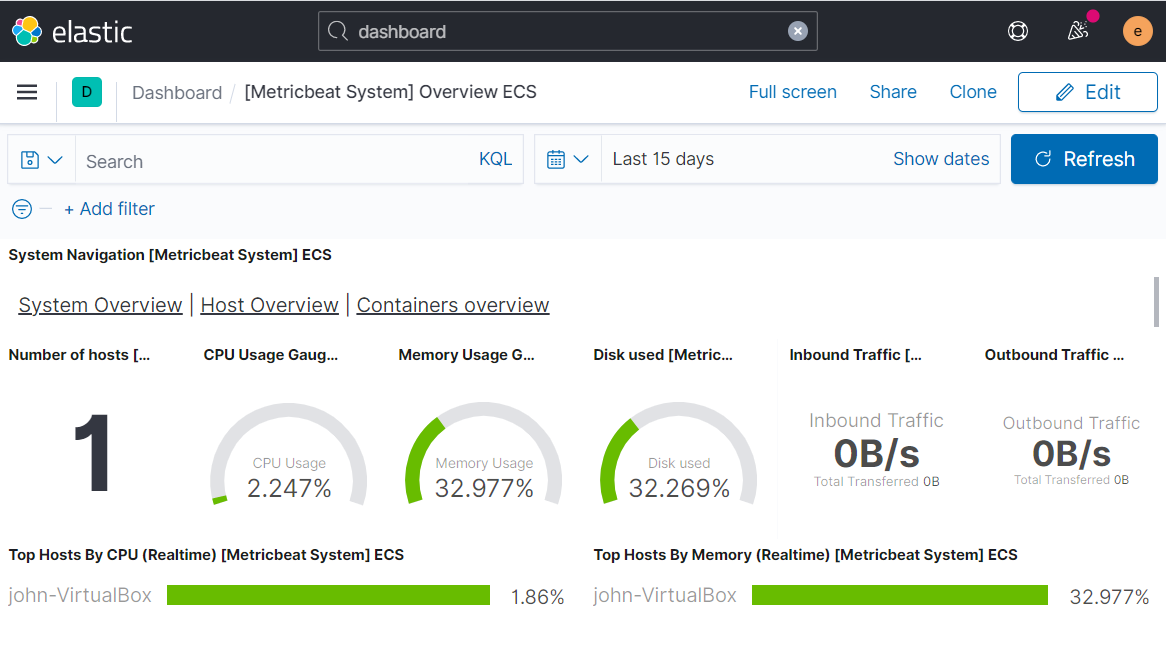

About Metricbeat modules
Metricbeat has many modules available that collect common metrics. You can configure additional modules as needed. For this example we’re using Metricbeat’s default configuration, which has the System module enabled. The System module allows you to monitor servers with the default set of metrics: cpu, load, memory, network, process, process_summary, socket_summary, filesystem, fsstat, and uptime.
Load the Metricbeat Kibana dashboards
Metricbeat comes packaged with example dashboards, visualizations, and searches for visualizing Metricbeat data in Kibana. Before you can use the dashboards, you need to create the data view (formerly index pattern) metricbeat-*, and load the dashboards into Kibana. This needs to be done from a local Beats machine that has access to the Elastic Cloud Enterprise deployment.

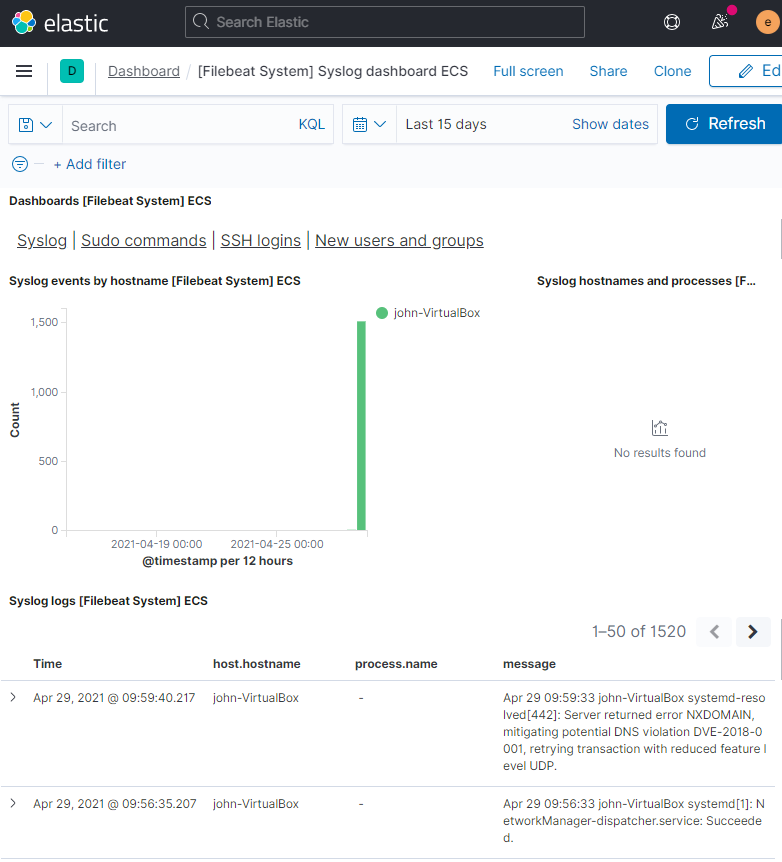

- Exit the CLI.
The data views for filebeat-* and metricbeat-* are now available in Elasticsearch. To verify:
- Login to Kibana.
- Open the Kibana main menu and select Stack Management, then Data views.
- In the search bar, search for data views.
- In the search results, choose Kibana / Data Views Management.

- Logstash now outputs the Filebeat and Metricbeat data to your Elastic Cloud Enterprise instance.

View the Metricbeat dashboard
- Login to Kibana.
- Open the Kibana main menu and select Analytics, then Dashboard.
- In the search box, search for metricbeat system. The search results show several dashboards available for you to explore.
- In the search results, choose [Metricbeat System] Overview ECS. A Metricbeat dashboard opens:
View the Filebeat dashboard
- In the search box, search for filebeat system.
- In the search results, choose [Filebeat System] Syslog dashboard ECS. A Filebeat dashboard displaying your Filebeat data:
