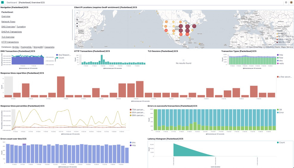

Step 6: View your data in Kibanaedit
Packetbeat comes with pre-built Kibana dashboards and UIs for visualizing log
data. You loaded the dashboards earlier when you ran the setup
command.
To open the dashboards:

In the side navigation, click Discover. To see Packetbeat data, make sure the predefined
packetbeat-*
index pattern is selected.If you don’t see data in Kibana, try changing the time filter to a larger range. By default, Kibana shows the last 15 minutes.
- In the side navigation, click Dashboard, then select the dashboard that you want to open.
To populate the client locations map in the overview dashboard, follow the steps described in Enrich events with geoIP information.
