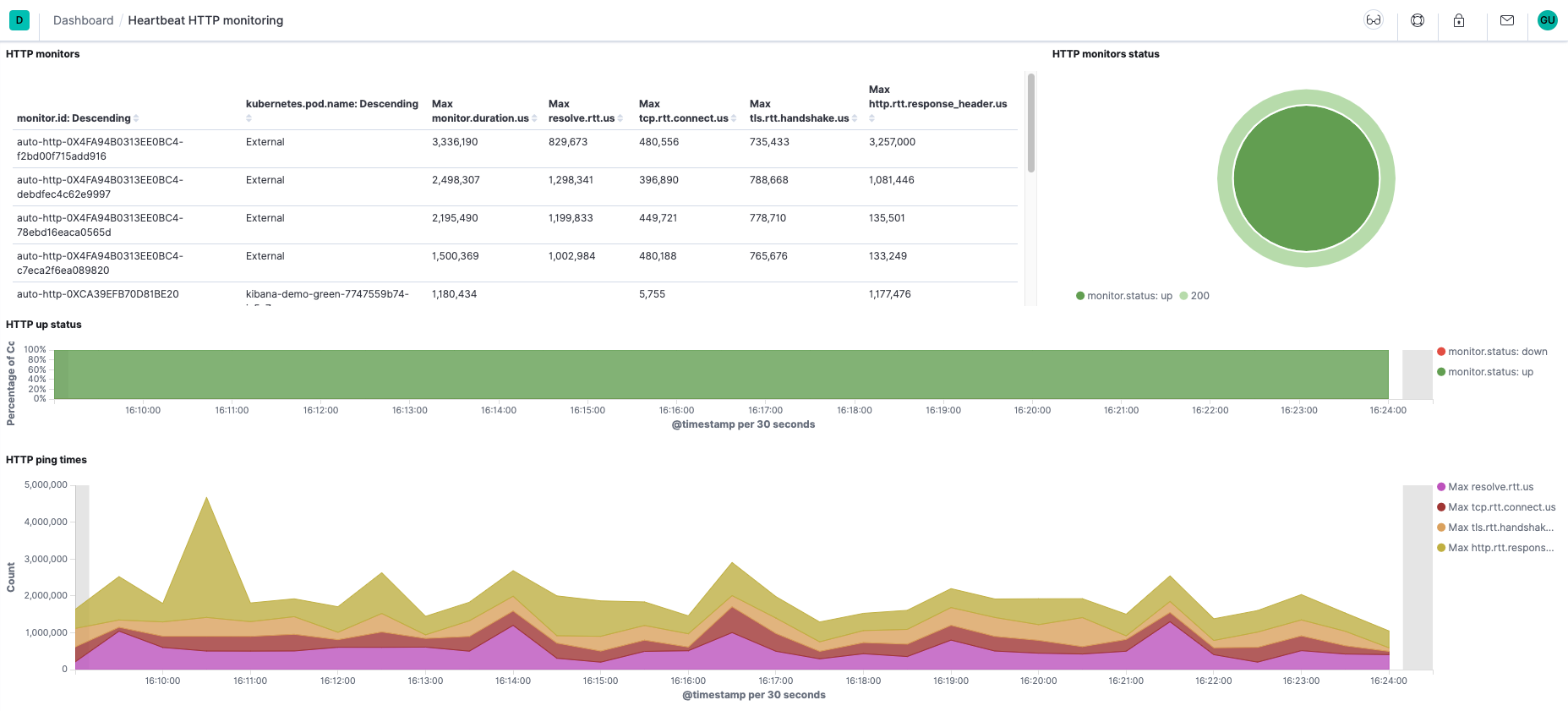

Heartbeat HTTP monitoring dashboard

Step 7: View your data in Kibanaedit
Heartbeat comes with pre-built Kibana dashboards and UIs for visualizing the status of your services. The dashboards are available in the uptime-contrib GitHub repository.
If you loaded the dashboards earlier, open them now.
To open the dashboards:
  1. Launch Kibana:
    1. Log in to your Elastic Cloud account.
    2. Navigate to the Kibana endpoint in your deployment.
  2. In the side navigation, click Discover. To see Heartbeat data, make sure the predefined heartbeat-* index pattern is selected.
    If you don’t see data in Kibana, try changing the time filter to a larger range. By default, Kibana shows the last 15 minutes.
  3. In the side navigation, click Dashboard, then select the dashboard that you want to open.
