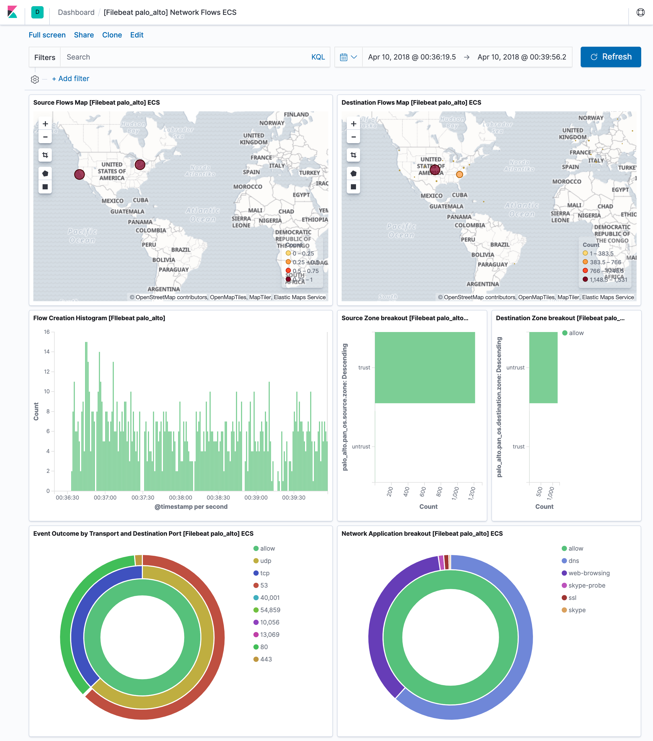

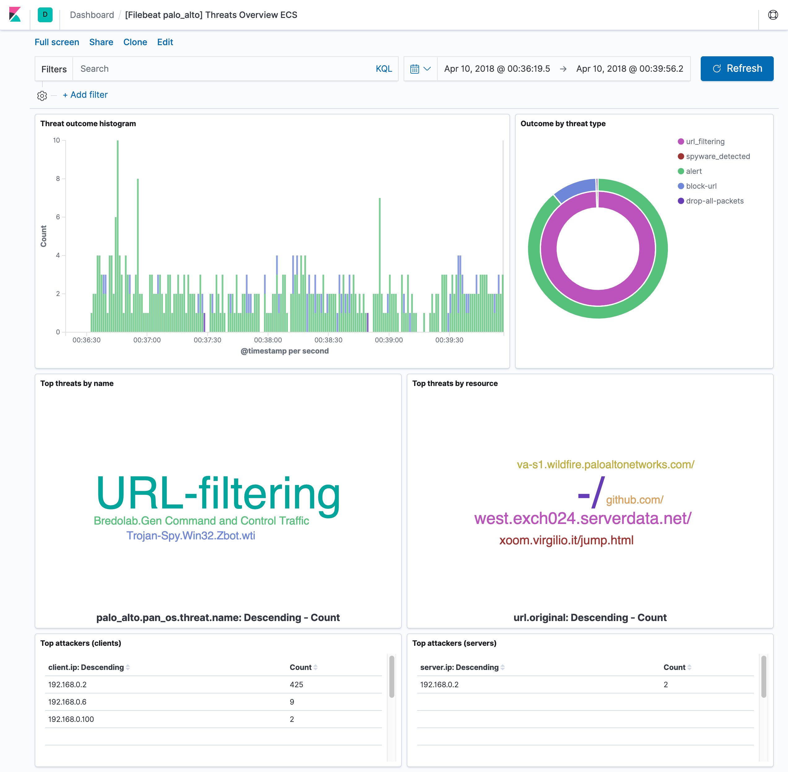

Example dashboard
editThis module comes with two sample dashboards:
