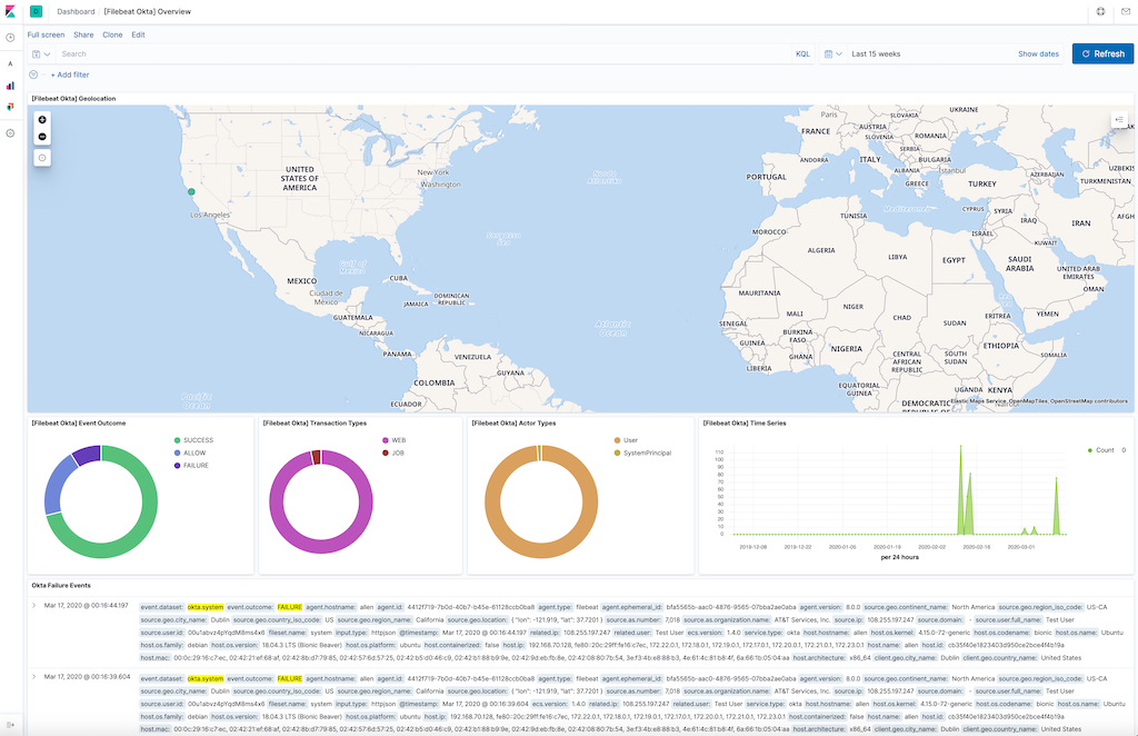

Example dashboard
editThis module comes with a sample dashboard:
