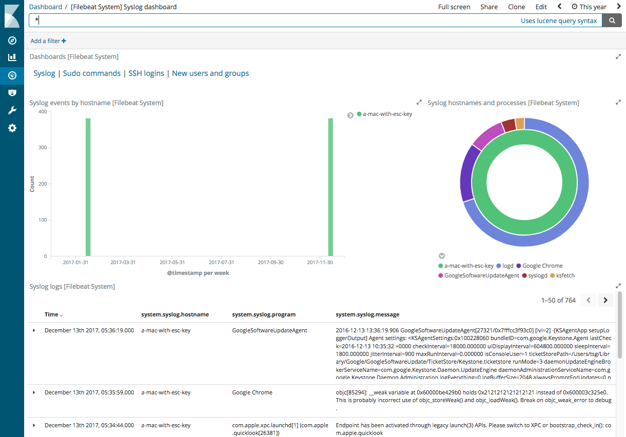

Example dashboards
editThis module comes with sample dashboards. For example:
