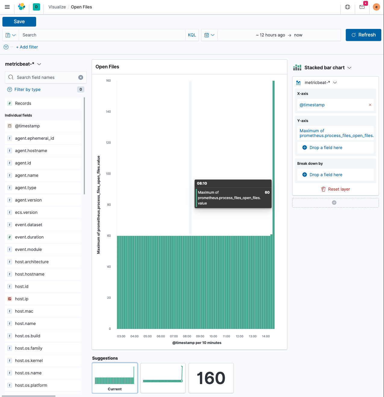

Visualize open files over timeedit
The second visualization is to be a check for the number of open files in our application.
As no one can remember all the field names, let’s again look at the metrics output again first.
curl -s localhost:7000/metrics -u metrics:secret | grep ^process process_files_max_files 10240.0 process_cpu_usage 1.8120711232436825E-4 process_uptime_seconds 72903.726 process_start_time_seconds 1.594048883317E9 process_files_open_files 61.0
Let’s look at the process_files_open_files
metric. This should be a rather static value that rarely changes.
If you run an application which stores data within the JVM or opens and closes network
sockets, this metric increases and decreases depending on the load. With a web application,
this is rather static. Let’s figure out why there are 60 files open on our

Add an endpoint to increase the number of open files by having long-running HTTP connections (each connection is also considered an open file as it requires a file descriptor), and then run
wrk
against it.... import java.util.concurrent.CompletableFuture; import java.util.concurrent.Executor; import java.util.concurrent.TimeUnit; ... public static void main(String[] args) { ... final Executor executor = CompletableFuture.delayedExecutor(20, TimeUnit.SECONDS); app.get("/wait", ctx -> { CompletableFuture<String> future = CompletableFuture.supplyAsync(() -> "done", executor); ctx.result(future); }); ...
Every future gets delayed by 20 seconds, which means that a single HTTP request stays open for 20 seconds.
Let’s run a
wrk
workload.wrk -c 100 -t 20 -d 5m http://localhost:7000/wait
Results show that only twenty requests were sent, which makes sense given the processing time.
Now let’s build a visualization using Lens in Kibana.
Below
Add filter
, select themetricbeat-*
index pattern. This will likely usefilebeat-*
as the default.The x-axis uses the
@timestamp
field - which in turn will create adate_histogram
aggregation again. The y-axis should not be the document count, as that one will always be stable, but the maximum value of the documents in the buckets. Click on the right of the field name on the y-axis and selectMax
. This gives you a similar visualization than shown, with a peak where you ran thewrk
command above. -

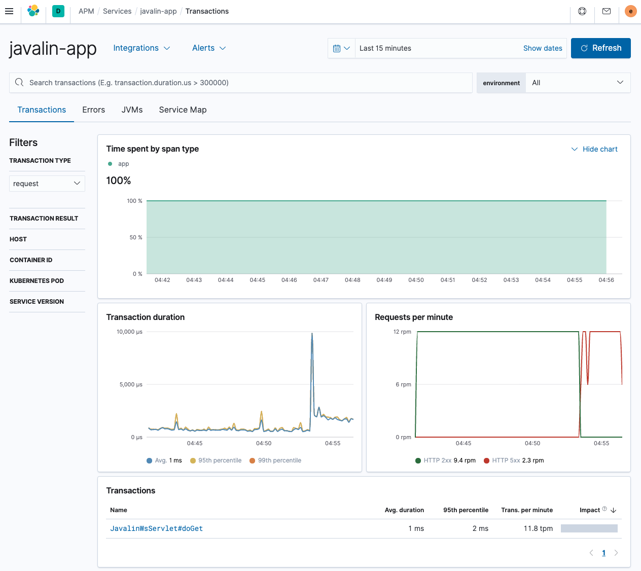

files.Wait a few minutes and let’s finally take a look at the APM app.
As you can see, this is quite the difference to the Spring Boot application shown earlier. The different endpoints are not listed; we can see the requests per minute though including errors.
The only transaction comes from a single servlet, which is not too helpful. Let’s try to fix this by introducing custom programmatic transactions.

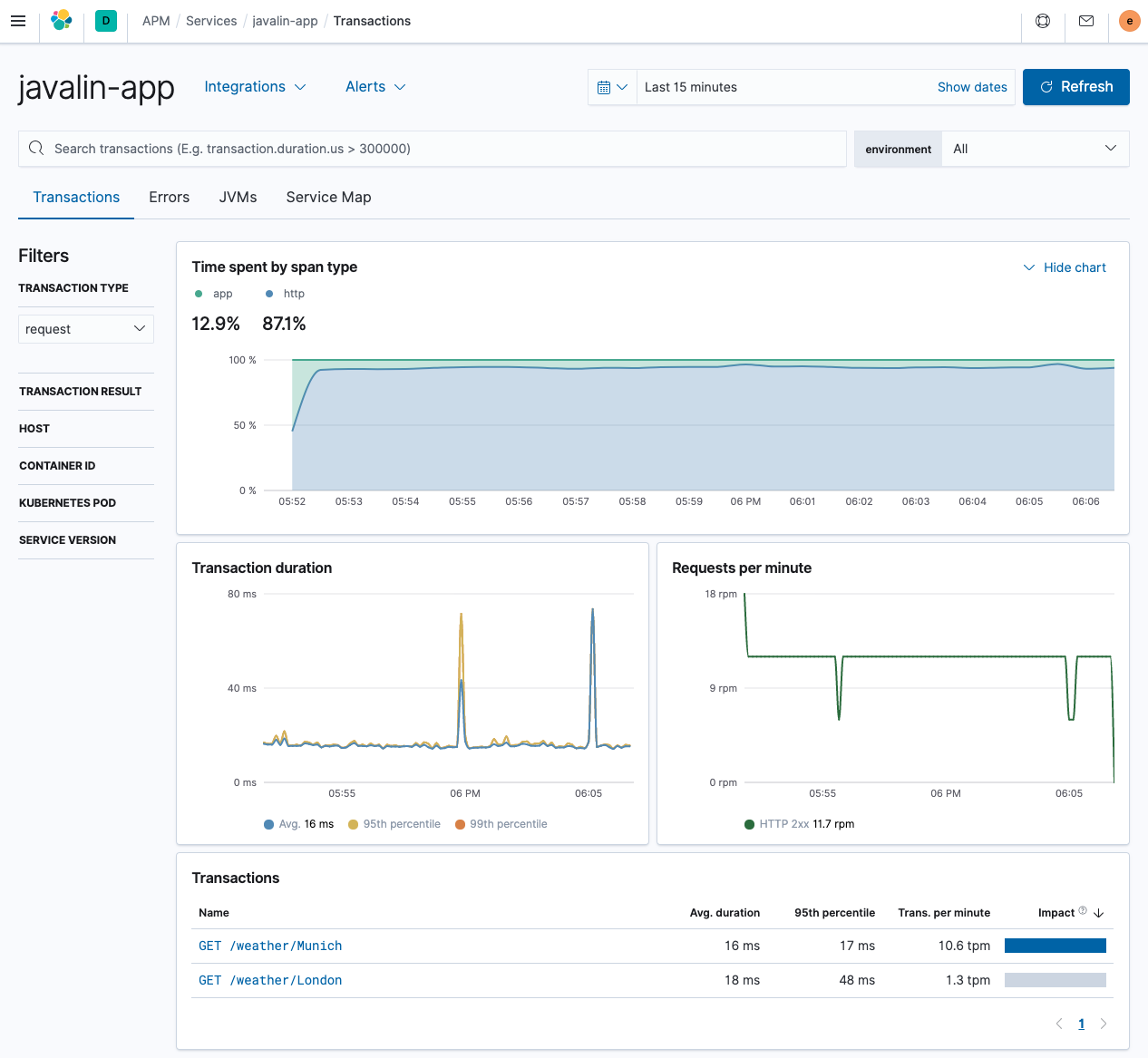

Fix the name of the transactions to include the HTTP method and the request path
app.before(ctx -> ElasticApm.currentTransaction() .setName(ctx.method() + " " + ctx.path()));
Restart your app and see data flowing in. Test a few different endpoints, especially the one that throws exceptions and the one that triggers a 404.
This looks much better, having differences between endpoints.

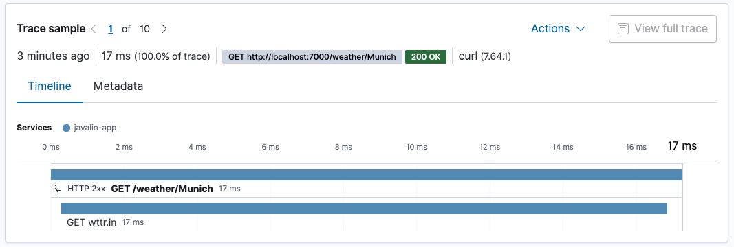

Add another endpoint to see the power of transactions, which polls another HTTP service. You may have heard of wttr.in, a service to poll weather information from. Let’s implement a proxy HTTP method that forwards the request to that endpoint. Let’s use Apache HTTP client, one of the most typical HTTP clients out there.
implementation 'org.apache.httpcomponents:fluent-hc:4.5.12'
This is our new endpoint.
import org.apache.http.client.fluent.Request; ... public static void main(String[] args) { ... app.get("/weather/:city", ctx -> { String city = ctx.pathParam("city"); ctx.result(Request.Get("https://wttr.in/" + city + "?format=3").execute() .returnContent().asBytes()) .contentType("text/plain; charset=utf-8"); }); ...
Curl
http://localhost:7000/weather/Munich
and see a one-line response about the current weather. Let’s check the APM UI.In the overview, you can see that most time is spent in the HTTP client, which is not surprising.
Our transactions for the
/weather/Munich
now contain a span, showing how much time is spent on retrieving the weather data. Because the HTTP client is instrumented automatically, there is no need to do anything.If the
city
parameter if that URL is of high cardinality, this will result in a high amount of URLs mentioned instead of the generic endpoint. If you would like to prevent this, a possibility would be to usectx.matchedPath()
to log every call to the weather API asGET /weather/:city
. This however requires some refactoring by removing theapp.before()
handler and replacing it with aapp.after()
handler.app.after(ctx -> ElasticApm.currentTransaction().setName(ctx.method() + " " + ctx.endpointHandlerPath()));

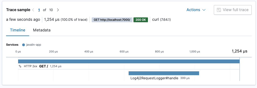

Method tracing via agent configurationedit
Instead of writing code to trace methods, you can also configure the agent to do this. Let’s try to figure out if logging is a bottleneck for our application and trace the request logger statements we added earlier.
The agent can trace methods based on their signature.
The interface to monitor would be the io.javalin.http.RequestLogger
interface with the handle
method. So let’s try
io.javalin.http.RequestLogger#handle
to identify the method to log
and put this in your .env
ELASTIC_APM_TRACE_METHODS="de.spinscale.javalin.Log4j2RequestLogger#handle"
Create a dedicated logger class as well to match the above trace method.
package de.spinscale.javalin; import io.javalin.http.Context; import io.javalin.http.RequestLogger; import org.jetbrains.annotations.NotNull; import org.slf4j.Logger; import org.slf4j.LoggerFactory; public class Log4j2RequestLogger implements RequestLogger { private final Logger logger = LoggerFactory.getLogger(Log4j2RequestLogger.class); @Override public void handle(@NotNull Context ctx, @NotNull Float executionTimeMs) throws Exception { String userAgent = ctx.userAgent() != null ? ctx.userAgent() : "-"; logger.info("{} {} {} {} \"{}\" {}", ctx.method(), ctx.req.getPathInfo(), ctx.res.getStatus(), ctx.req.getRemoteHost(), userAgent, executionTimeMs.longValue()); } }
Fix the call in our
App
class.config.requestLogger(new Log4j2RequestLogger());
Restart your app, and see how much time your logging takes.
The request logger takes roughly 400 microseconds. The whole request takes about 1.3 milliseconds. Approximately a third of the processing of our request goes into logging.
If you are on the quest for a faster service, you may want to rethink logging. However, this logging happens after the result is written to the client, so while the total processing time increases with logging, responding to the client does not (closing the connection however might be). Also note that these tests were conducted without a proper warm-up. I assume that after appropriate JVM warm-up, you will have much faster processing of requests.
