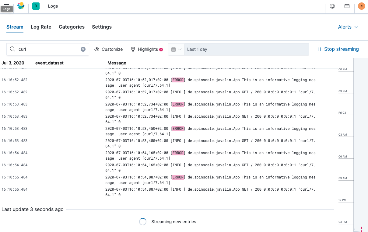

  2. Restart the application and send a request. The logs will be sent to /tmp/javalin/app.log.

  2. Now let’s have a look at the Logs app in Kibana. Select ObservabilityLogs.
    If you want to see the streaming feature at work, run the following curl request in a loop while sleeping.
    while $(sleep 0.7) ; do curl localhost:7000 ; done
  3. To view a continuous stream of log messages, click Stream live. You can also highlight specific terms, as shown here.
    Kibana Logs UI Streaming
    Looking at one of the documents being indexed, you can see that the log message is contained in a single field. Verify this by looking at one of those documents.

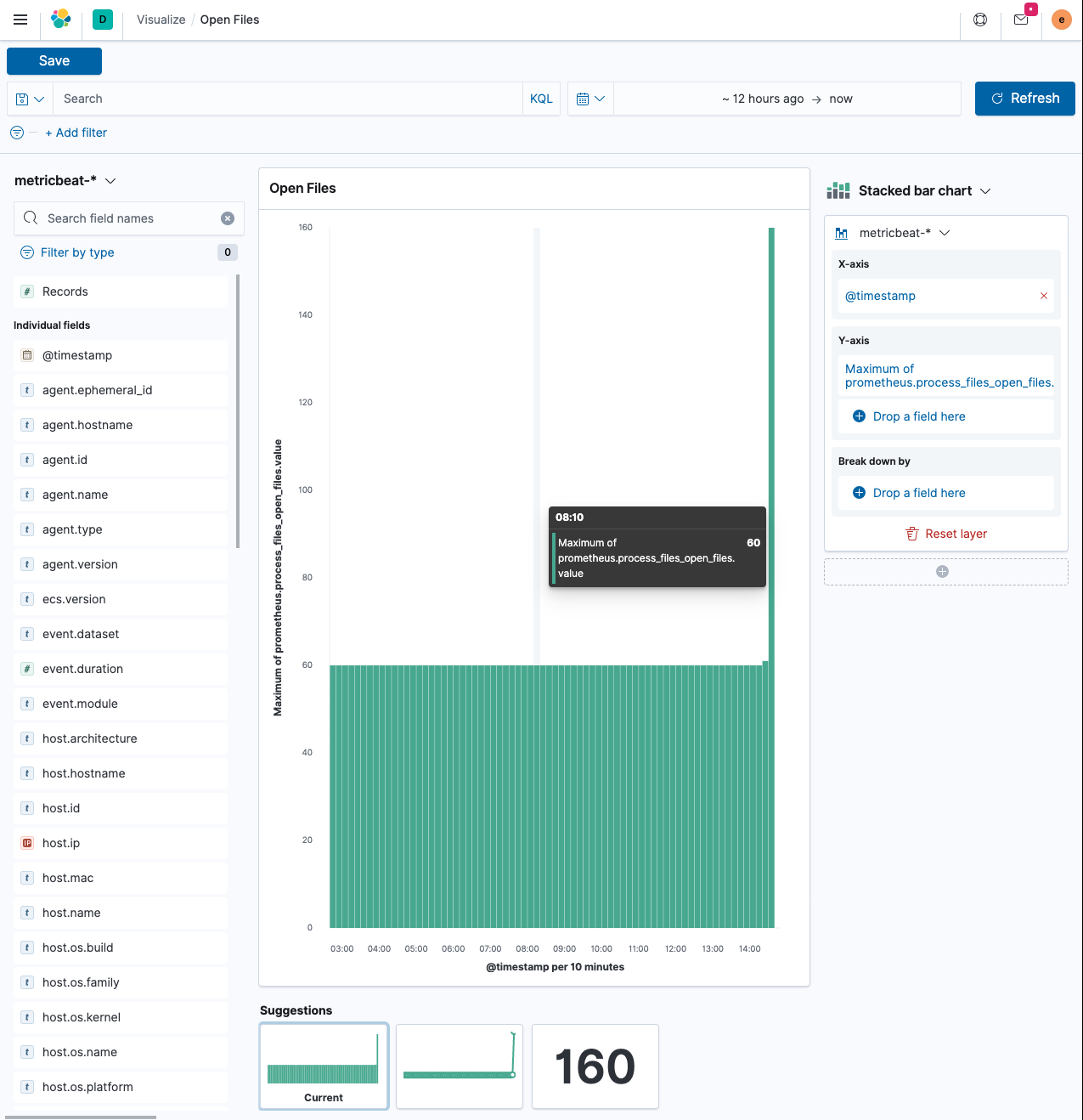

Visualize open files over timeedit
The second visualization is to be a check for the number of open files in our application.
As no one can remember all the field names, let’s again look at the metrics output again first.
curl -s localhost:7000/metrics -u metrics:secret | grep ^process
process_files_max_files 10240.0
process_cpu_usage 1.8120711232436825E-4
process_uptime_seconds 72903.726
process_start_time_seconds 1.594048883317E9
process_files_open_files 61.0
Let’s look at the process_files_open_files metric. This should be a rather static value that rarely changes. If you run an application which stores data within the JVM or opens and closes network sockets, this metric increases and decreases depending on the load. With a web application, this is rather static. Let’s figure out why there are 60 files open on our small web application.

  3. Add an endpoint to increase the number of open files by having long-running HTTP connections (each connection is also considered an open file as it requires a file descriptor), and then run wrk against it.
    import java.util.concurrent.CompletableFuture;
    import java.util.concurrent.Executor;
    import java.util.concurrent.TimeUnit;
    public static void main(String[] args) {
        final Executor executor = CompletableFuture.delayedExecutor(20, TimeUnit.SECONDS);
        app.get("/wait", ctx -> {
            CompletableFuture<String> future = CompletableFuture.supplyAsync(() -> "done", executor);
            ctx.result(future);
    Every future gets delayed by 20 seconds, which means that a single HTTP request stays open for 20 seconds.
  4. Let’s run a wrk workload.
    wrk -c 100 -t 20 -d 5m http://localhost:7000/wait
    Results show that only twenty requests were sent, which makes sense given the processing time.
    Now let’s build a visualization using Lens in Kibana.
    Lens visualization
  5. Below Add filter, select the metricbeat-* index pattern. This will likely use filebeat-* as the default.
    The x-axis uses the @timestamp field - which in turn will create a date_histogram aggregation again. The y-axis should not be the document count, as that one will always be stable, but the maximum value of the documents in the buckets. Click on the right of the field name on the y-axis and select Max. This gives you a similar visualization than shown, with a peak where you ran the wrk command above.

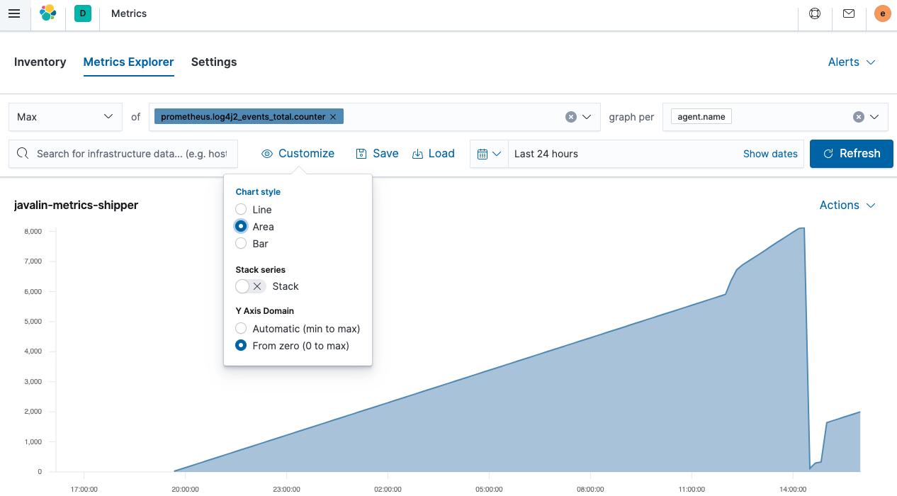

  7. Click Metrics Explorer, you can start exploring your data for specific hosts or the CPU usage across your nodes.
    Metrics UI Log Counter
    This is an area chart of the total events counter the Javalin app emits. It’s rising because there is a component polling an endpoint that, in turn, produces another log message. The steeper peek was due to sending more requests. But where is the sudden drop-off coming from? A JVM restart. As those metrics are not persisted, they reset on a JVM restart. With that in mind, it’s often better to log the rate instead of the counter field.

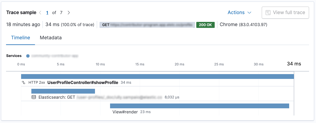

Despite a heavily fragmented APM landscape, the terminology often is similar. The two most important terms are Spans and Transactions.
A transaction encapsulates a series of spans, which contain information about the execution of a piece of code. Let’s take a look at this screenshot from the Kibana APM app.
A transaction with spans
This is a Spring Boot application. The UserProfileController.showProfile() method is called, which is marked as the transaction. There are two spans within. First, a request is sent to Elasticsearch using the Elasticsearch REST client, and after the response is rendered using Thymeleaf. The request to Elasticsearch is faster than the rendering in this case.
The Java APM agent can instrument specific frameworks automatically. Spring and Spring Boot are supported well, and the above data was created by adding the agent to the Spring Boot application; there is no configuration necessary.

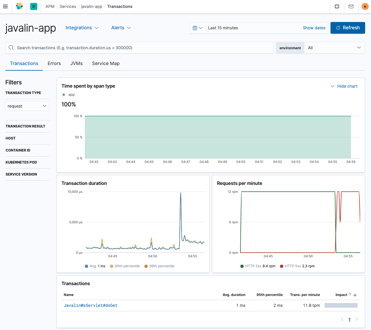

    Wait a few minutes and let’s finally take a look at the APM app.
    Javalin App APM UI
    As you can see, this is quite the difference to the Spring Boot application shown earlier. The different endpoints are not listed; we can see the requests per minute though including errors.
    The only transaction comes from a single servlet, which is not too helpful. Let’s try to fix this by introducing custom programmatic transactions.

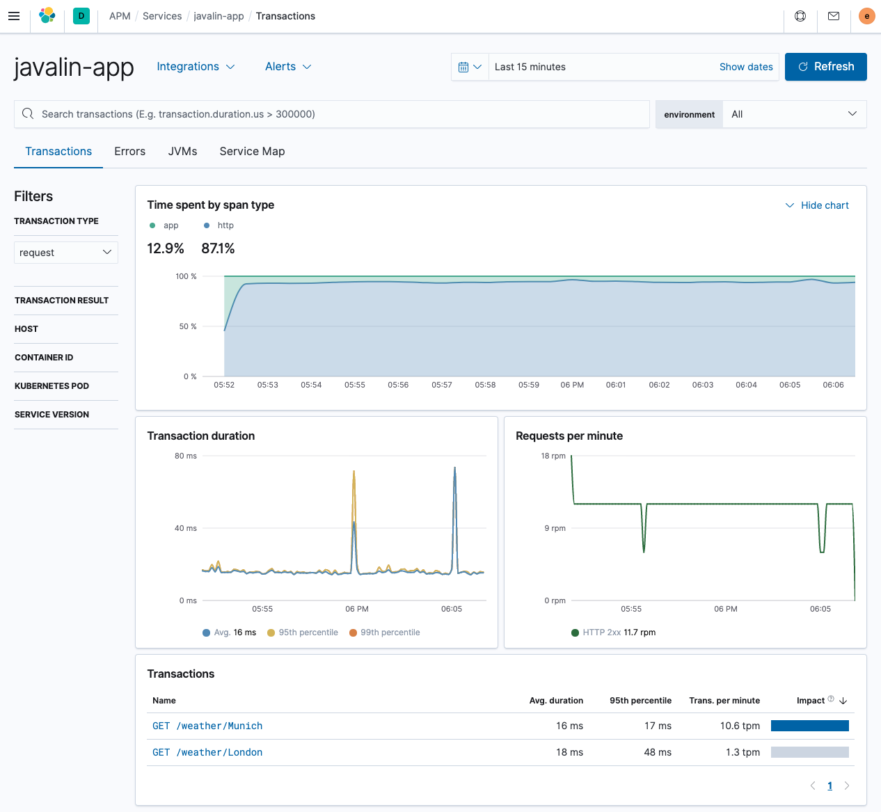

  3. Restart your app and see data flowing in. Test a few different endpoints, especially the one that throws exceptions and the one that triggers a 404.
    APM UI with correct transaction names
    This looks much better, having differences between endpoints.

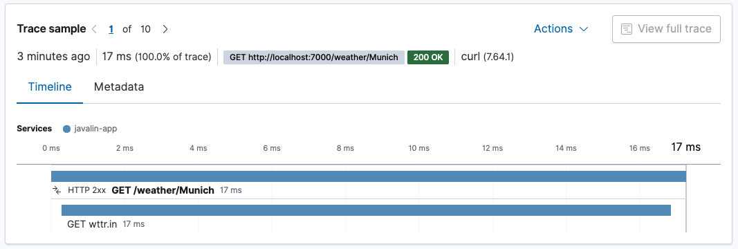

  5. Curl http://localhost:7000/weather/Munich and see a one-line response about the current weather. Let’s check the APM UI.
    In the overview, you can see that most time is spent in the HTTP client, which is not surprising.
    Overview
    Our transactions for the /weather/Munich now contain a span, showing how much time is spent on retrieving the weather data. Because the HTTP client is instrumented automatically, there is no need to do anything.
    Transaction with span
