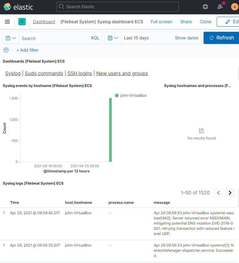

Load the Filebeat Kibana dashboards
Filebeat comes packaged with example Kibana dashboards, visualizations, and searches for visualizing Filebeat data in Kibana. Before you can use the dashboards, you need to create the data view filebeat-*, and load the dashboards into Kibana. This needs to be done from a Beats machine that has access to the Internet.
- Open a command line instance and then go to <localpath>/filebeat-<version>/
- Run the following command:
sudo ./filebeat setup \ -E cloud.id=<cloudID> \ -E cloud.auth=<username>:<password> -E setup.kibana.ssl.certificate_authorities=['/path/to/the/elastic-ece-ca-cert.pem'] \ -E setup.kibana.ssl.verification_mode='certificate' \ -E output.elasticsearch.ssl.certificate_authorities=['/path/to/the/elastic-ece-ca-cert.pem'] \ -E output.elasticsearch.ssl.verification_mode='certificate'
Specify the Cloud ID of your Elastic Cloud Enterprise deployment. You can include or omit the |
Specify the username and password provided to you when creating the deployment. Make sure to keep the colon between <username> and <password>. |
The four lines related to Depending on variables including the installation location, environment, and local permissions, you might need to change the ownership of the filebeat.yml. |
Your results should be similar to the following:
Index setup finished. Loading dashboards (Kibana must be running and reachable) Loaded dashboards Setting up ML using setup --machine-learning is going to be removed in 8.0.0. Please use the ML app instead. See more: https://www.elastic.co/guide/en/machine-learning/current/index.html Loaded machine learning job configurations Loaded Ingest pipelines
- Exit the CLI.
The data views for filebeat-* and metricbeat-* are now available in Elasticsearch. To verify:

View the Filebeat dashboard
- Open the Kibana main menu and select Analytics, then Dashboard.
- In the search box, search for filebeat system.
- In the search results, choose [Filebeat System] Syslog dashboard ECS. A Filebeat dashboard displaying your Filebeat data:
