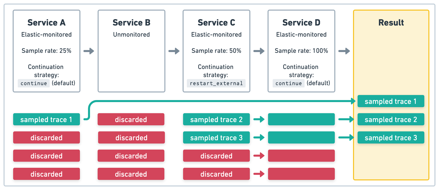

Distributed tracing with head-based sampling
In a distributed trace, the sampling decision is still made when the trace is initiated. Each subsequent service respects the initial service’s sampling decision, regardless of its configured sample rate; the result is a sampling percentage that matches the initiating service.
In this example, Service A
initiates four transactions and has sample rate of .5
(50%
The sample rates of Service B
and Service C
are ignored.
initiates four transactions and has a sample rate of 1
(100%
Again, the sample rates of Service B
and Service C
are ignored.
