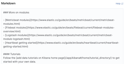

Add context to panels
editTo provide context to your dashboard panels, add Text panels that display important information, instructions, images, and more. You create Text panels using GitHub-flavored Markdown text.
On the dashboard, click
- In the Markdown field, enter the text, then click Update.

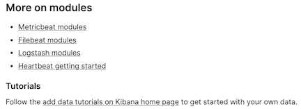

For example, when you enter:
![Markdown text with links](images/markdown_example_1.png)
The following instructions are displayed:
![Panel with markdown link text](images/markdown_example_2.png)

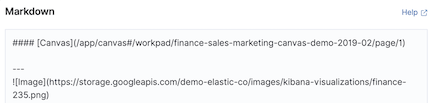

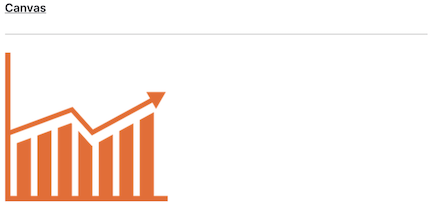

Or when you enter:
![Markdown text with image file](images/markdown_example_3.png)
The following image is displayed:
![Panel with markdown image](images/markdown_example_4.png)

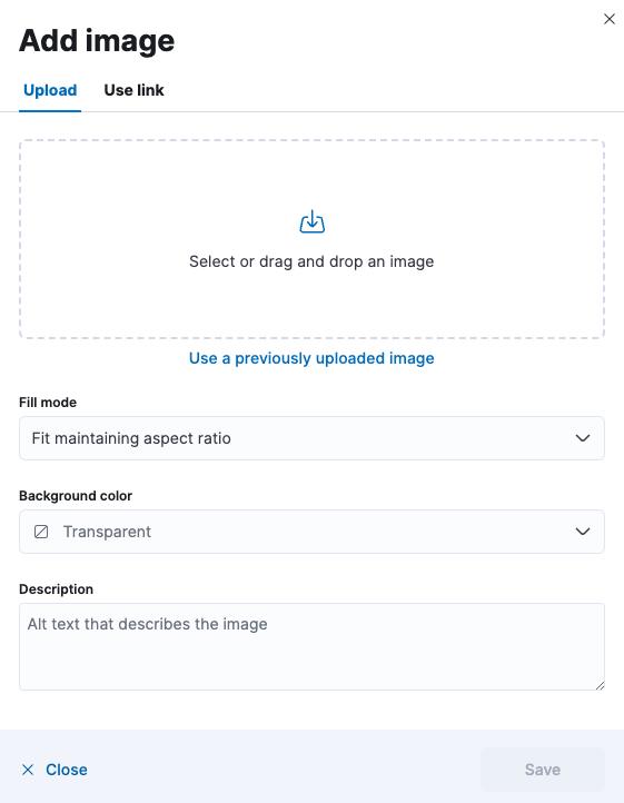

Add image panels
editTo personalize your dashboards, add your own logos and graphics with the Image panel. You can upload images from your computer, select previously uploaded images, or add images from an external link.
- Use the editor to add an image.
![Add image editor](images/dashboard_addImageEditor_8.7.0.png)
To manage your uploaded image files, open the main menu, then click Stack Management > Kibana > Files.
When you export a dashboard, the uploaded image files are not exported.
When importing a dashboard with an image panel, and the image file is unavailable, the image panel displays a not found
warning. Such panels have to be fixed manually by re-uploading the image using the panel’s image editor.
