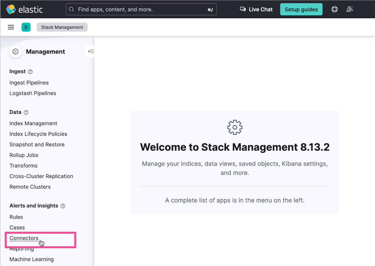

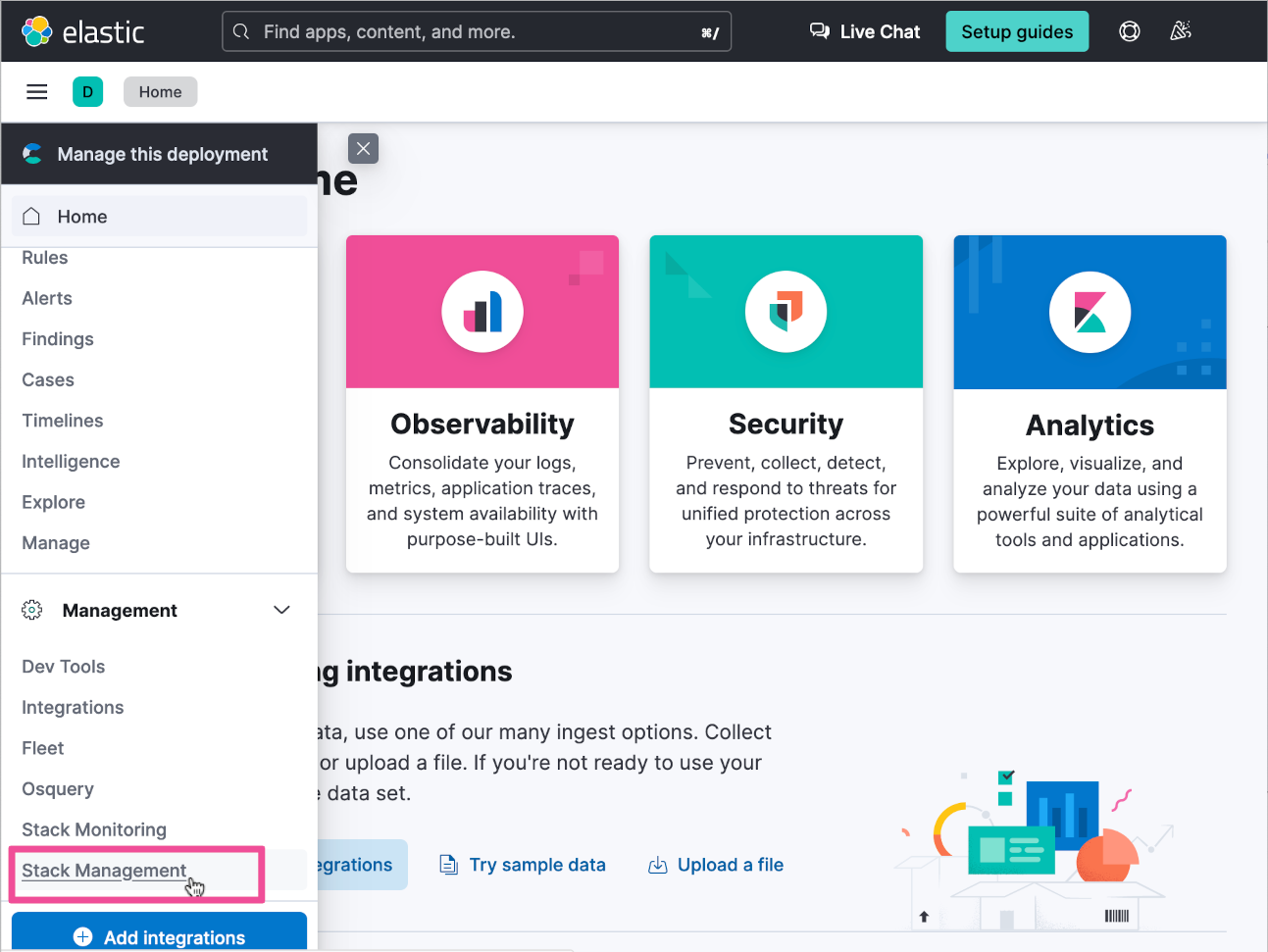

Sign in to the Elastic Cloud deployment you’ve created. From the top level menu, select Stack Management.

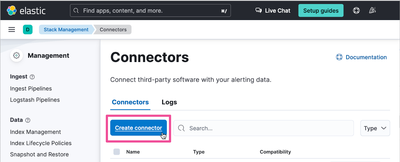

Select Connectors.
Click the Create connector button.

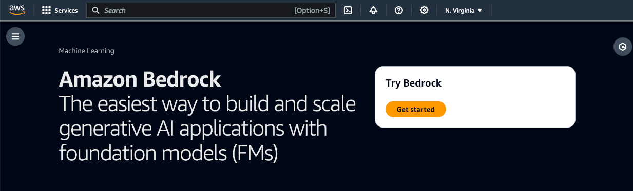

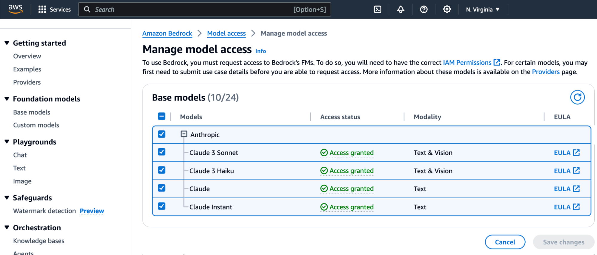

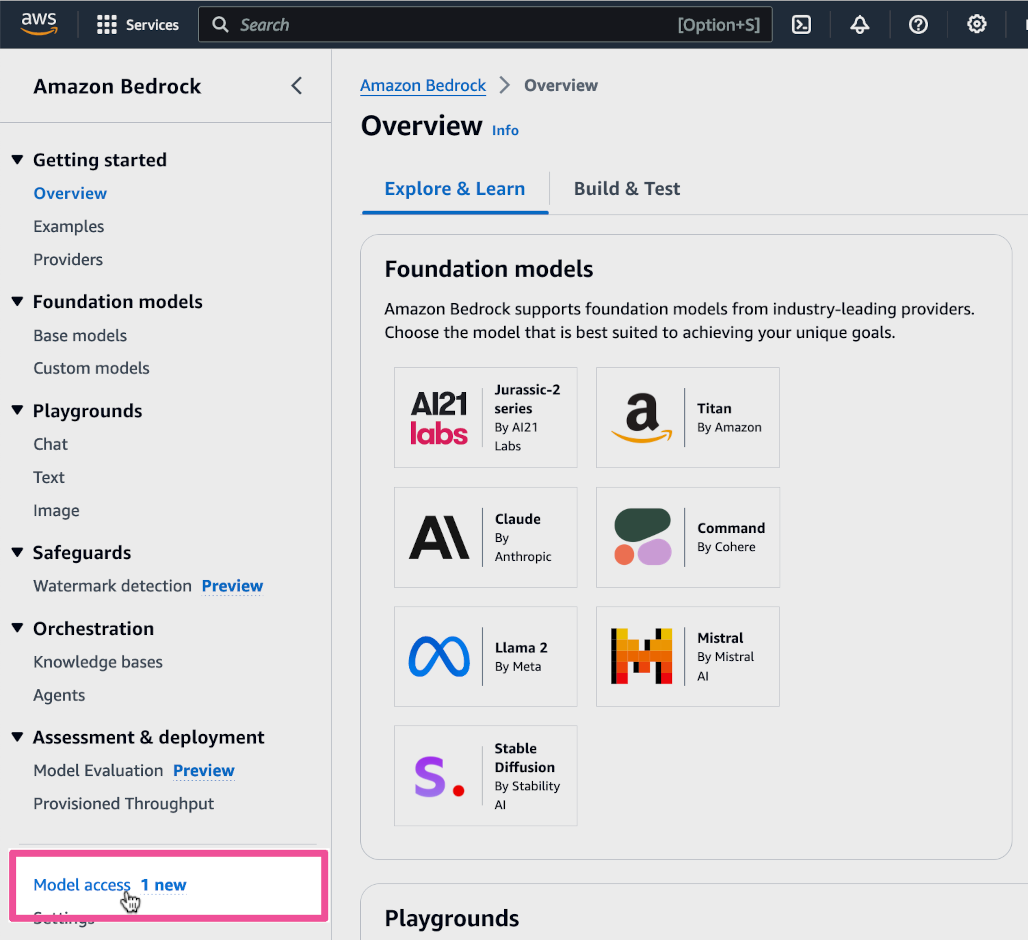

In a new browser tab, open Amazon Bedrock and click the Get started button.

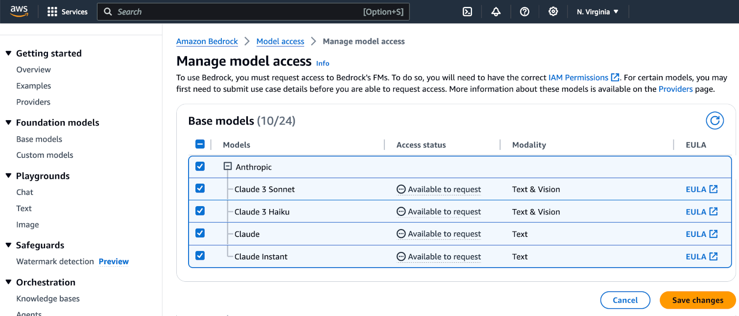

Currently, access to the Amazon Bedrock foundation models is granted by requesting access using the Bedrock Model access section in the AWS console.
Select Model access from the navigation menu.
To request access, select the foundation models that you want to access and click the Save Changes button. For this blog post, we will choose the Anthropic Claude models.
Once access is granted, the Manage model access settings will indicate that access has been granted.

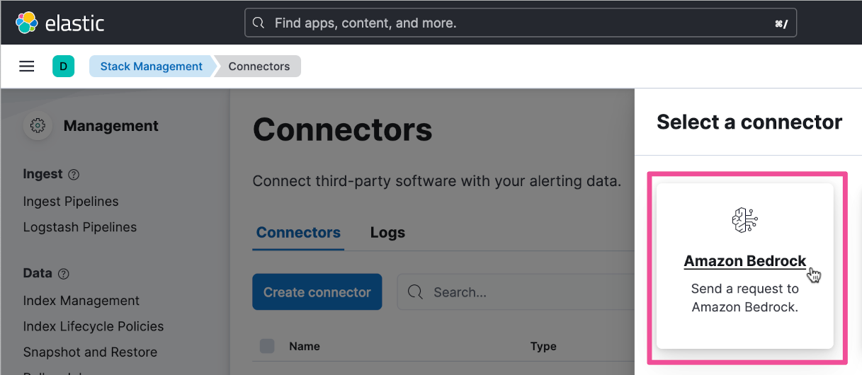

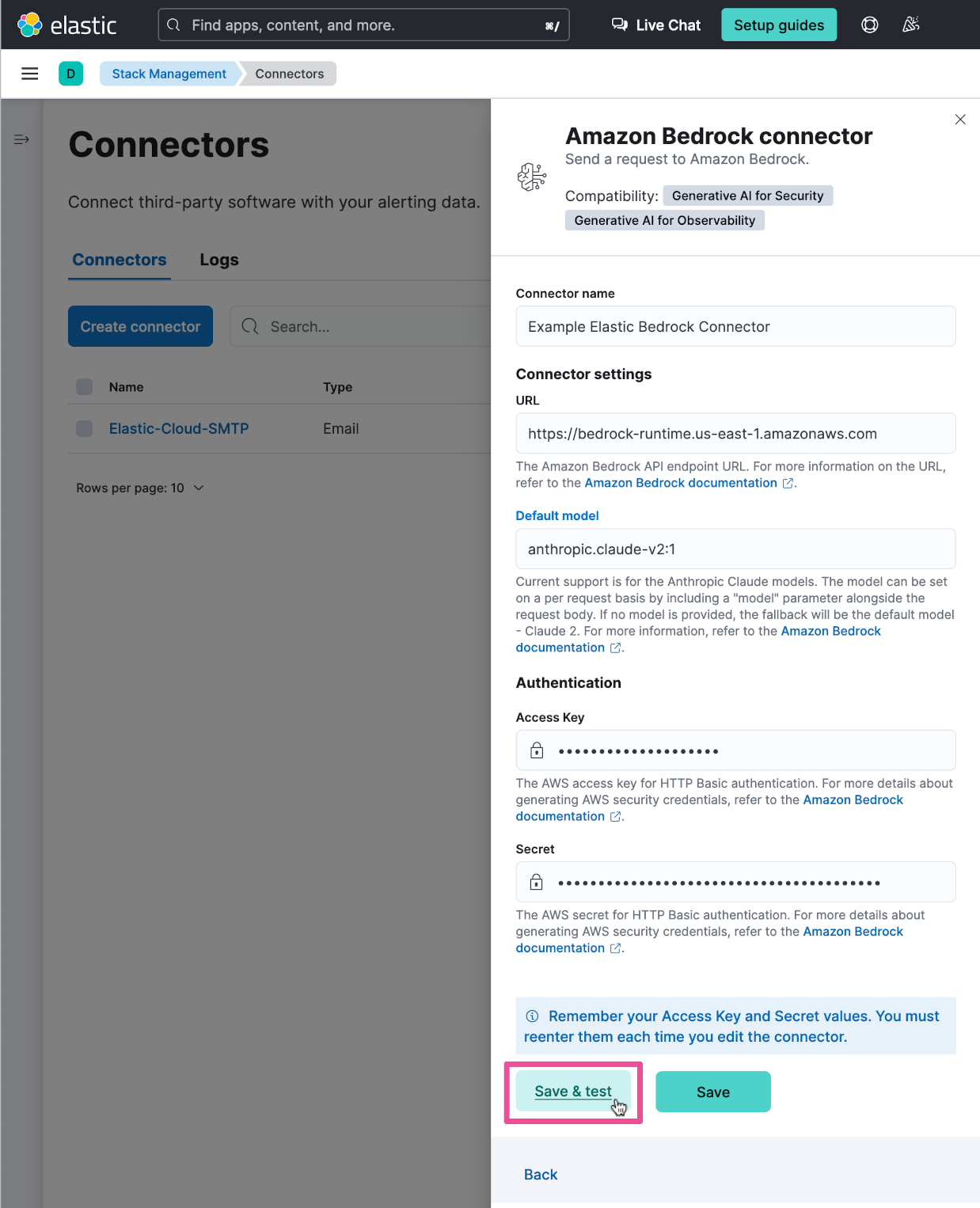

Back in the Elastic Cloud deployment create connector flyout, select the connector for Amazon Bedrock.
Enter a Name of your choice for the connector. Also, enter the Access Key and Key Secret that you copied in a previous step. Click the Save & test button to create the connector.

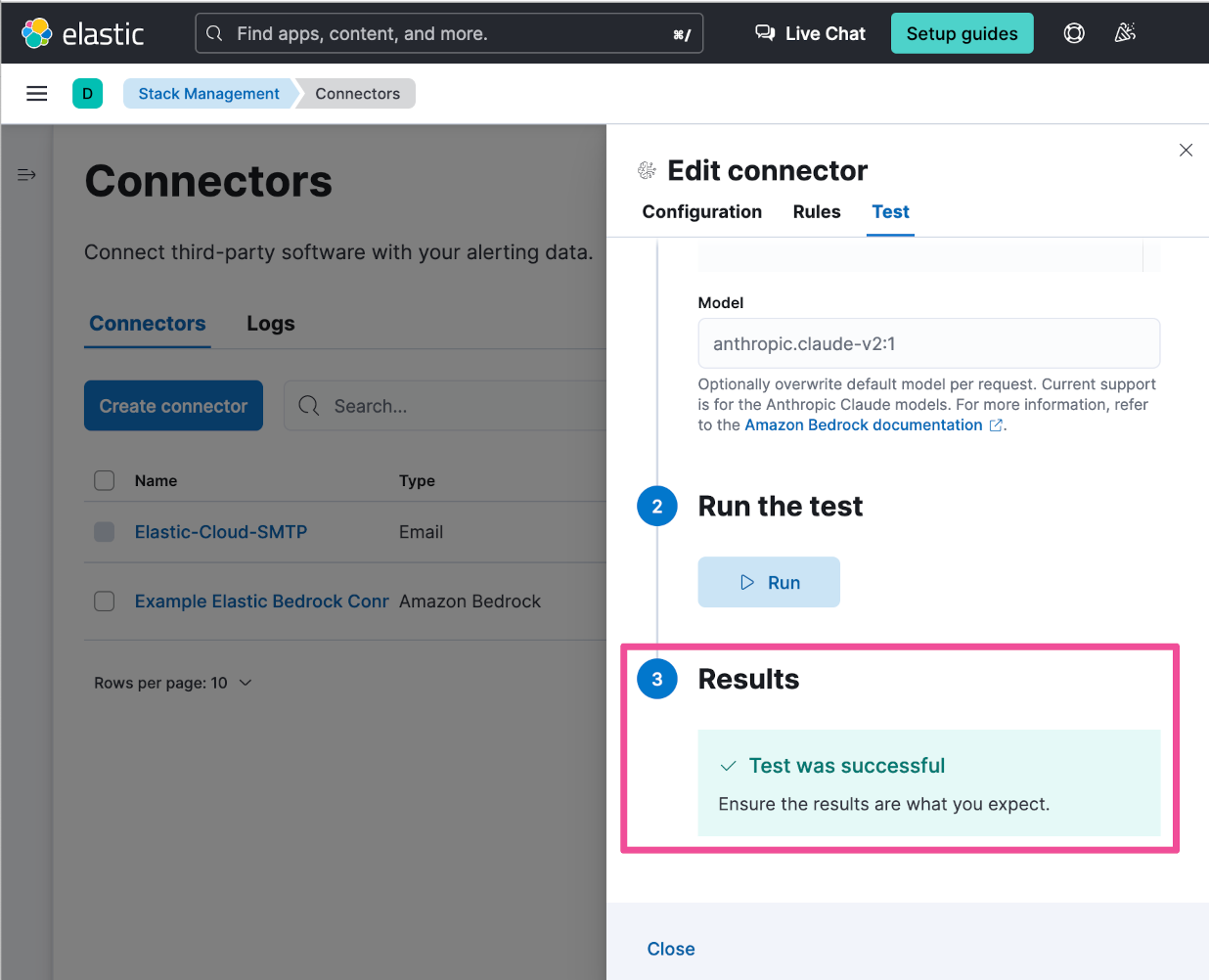

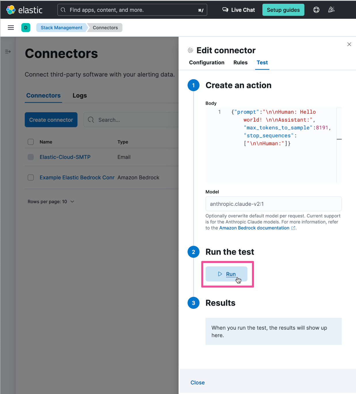

Within the Edit Connector flyout window, click the Run button to confirm that the connector configuration is valid and can successfully connect to your Amazon Bedrock instance.
You should see confirmation that the connector test was successful.

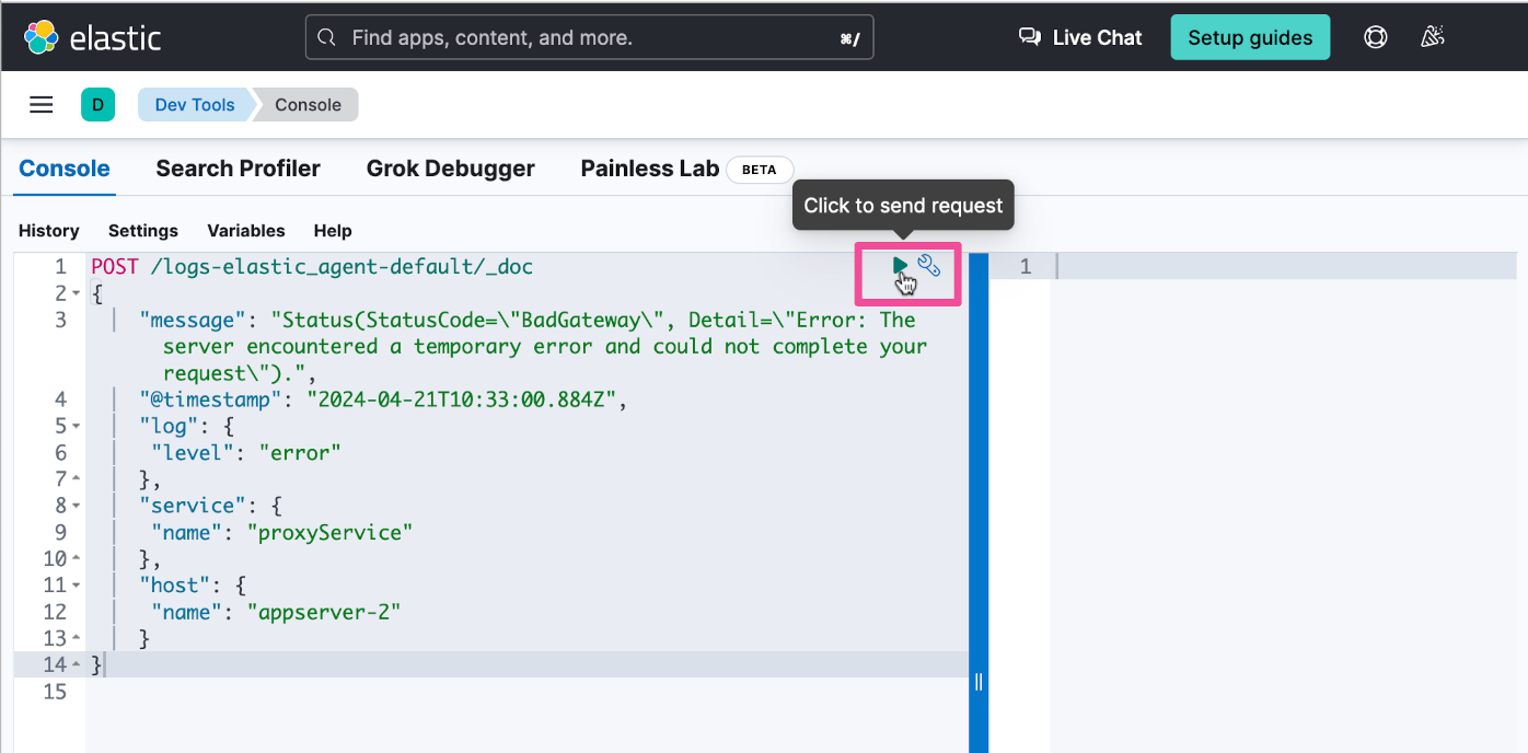

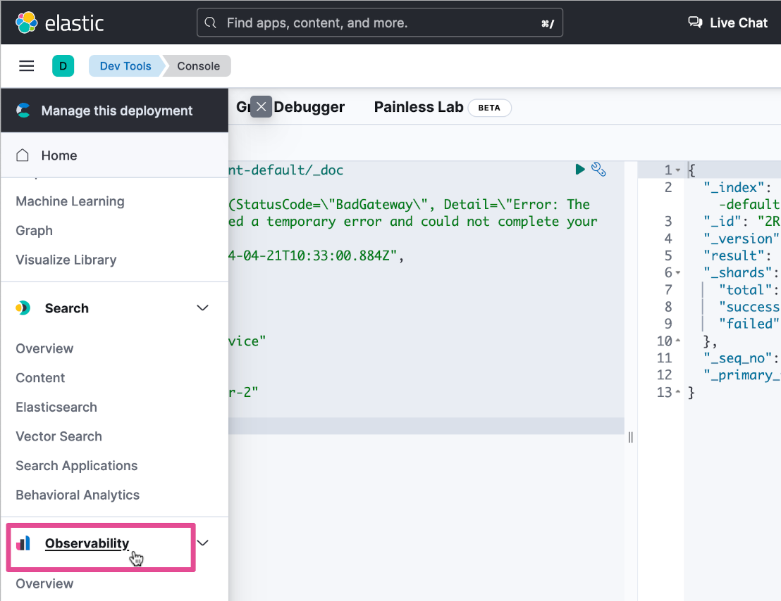

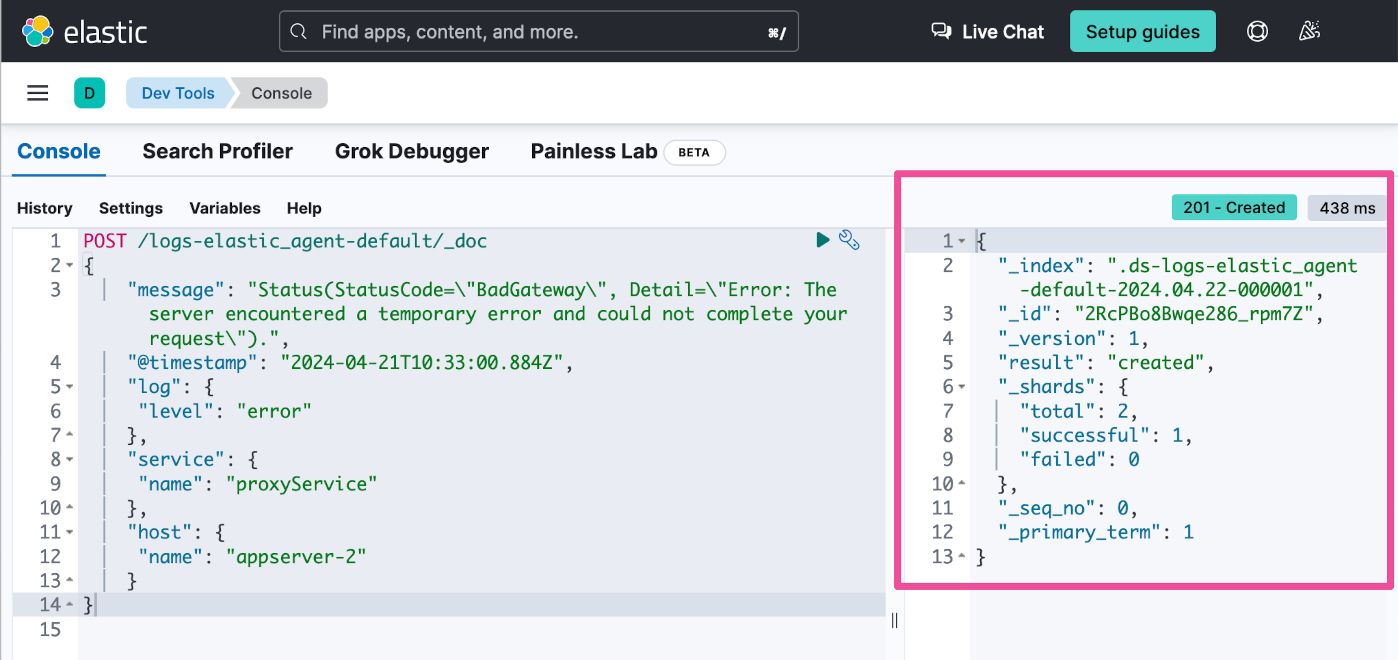

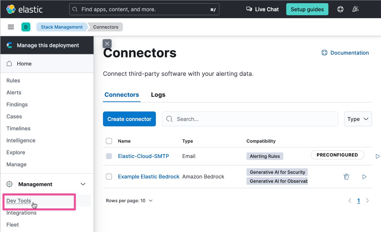

Use the Elastic Dev Tools to add a single logs record. Click the top-level menu and select Dev Tools.
Within the console area of Dev Tools, enter the following POST statement:
POST /logs-elastic_agent-default/_doc
    "message": "Status(StatusCode=\"BadGateway\", Detail=\"Error: The server encountered a temporary error and could not complete your request\").",
    "@timestamp": "2024-04-21T10:33:00.884Z",
    "log": {
   	 "level": "error"
    "service": {
   	 "name": "proxyService"
    "host": {
   	 "name": "appserver-2"
Then run the POST command by clicking the green Run button.
You should see a 201 response confirming that the example logs record was successfully created.
Use the Elastic AI Assistant
Now that you have a log entry, let’s use the AI Assistant to see how it interacts with logs data. Click the top-level menu and select Observability.

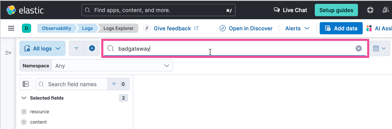

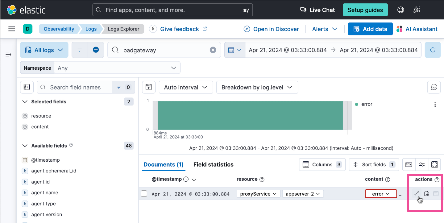

Select Logs Explorer under Observability.

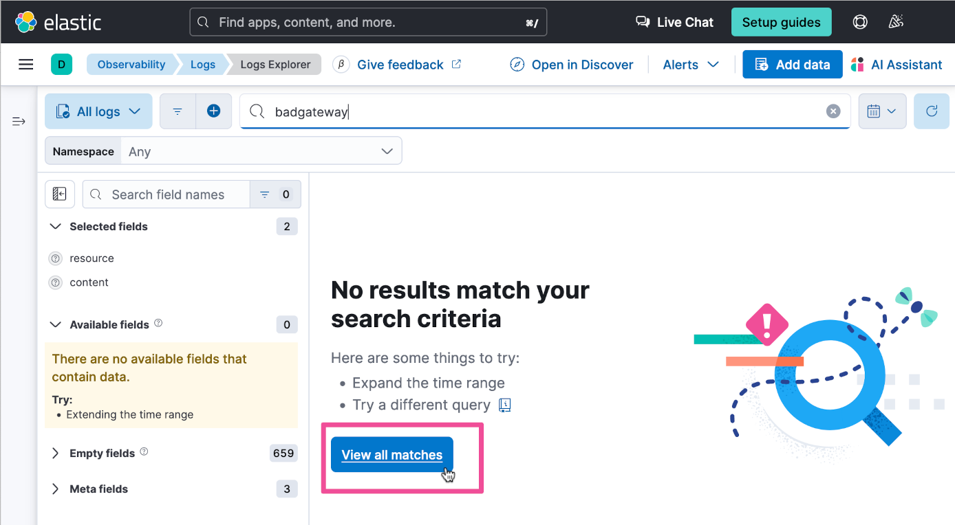

In the Logs Explorer search box, enter the text “badgateway” and press the Enter key to perform the search.
Click the View all matches button to include all search results.

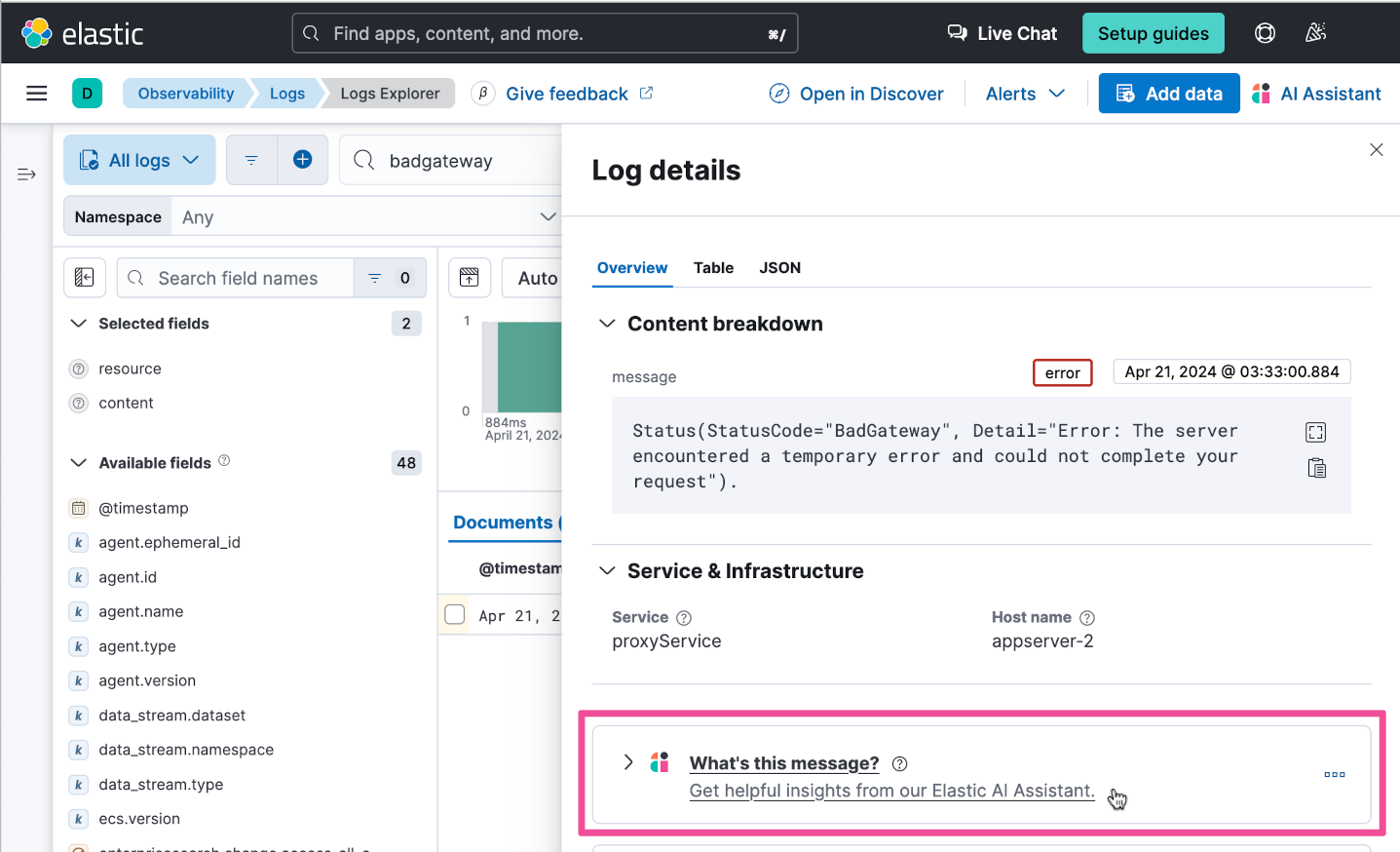

You should see the one log record that you previously inserted via Dev Tools. Click the expand icon in the actions column to see the log record’s details.

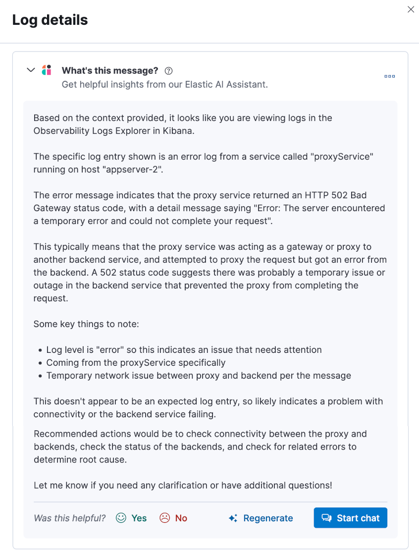

You should see the expanded view of the logs record. Let’s use the AI Assistant to summarize it. Click on the What's this message? button.
We get a fairly generic answer back. Depending on the exception or error we're trying to analyze, this can still be really useful, but we can improve this response by adding additional documentation to the AI Assistant knowledge base.

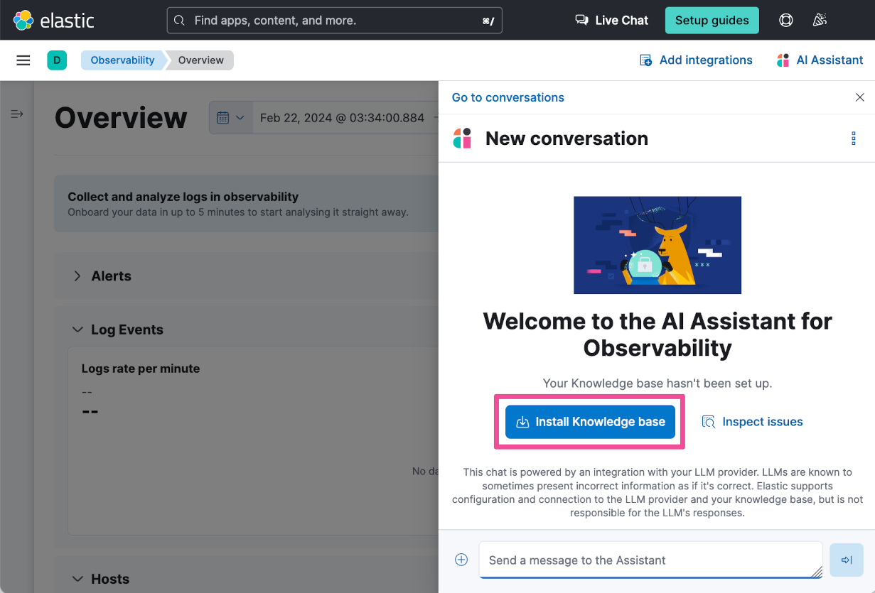

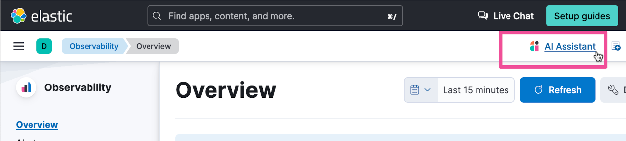

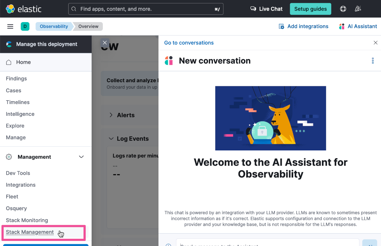

Click the AI Assistant button at the top right of the window.
Click the Install Knowledge base button.

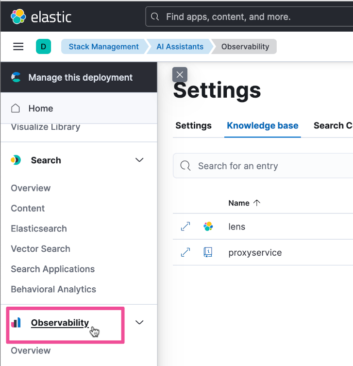

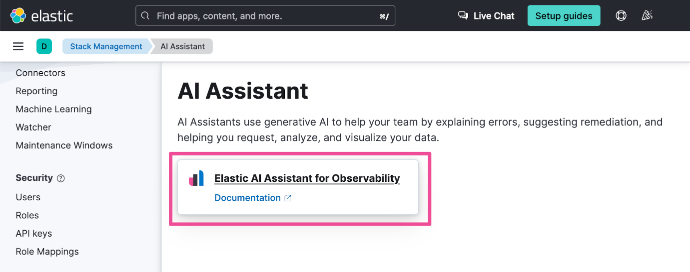

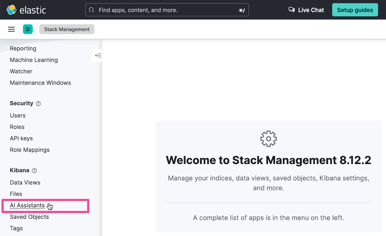

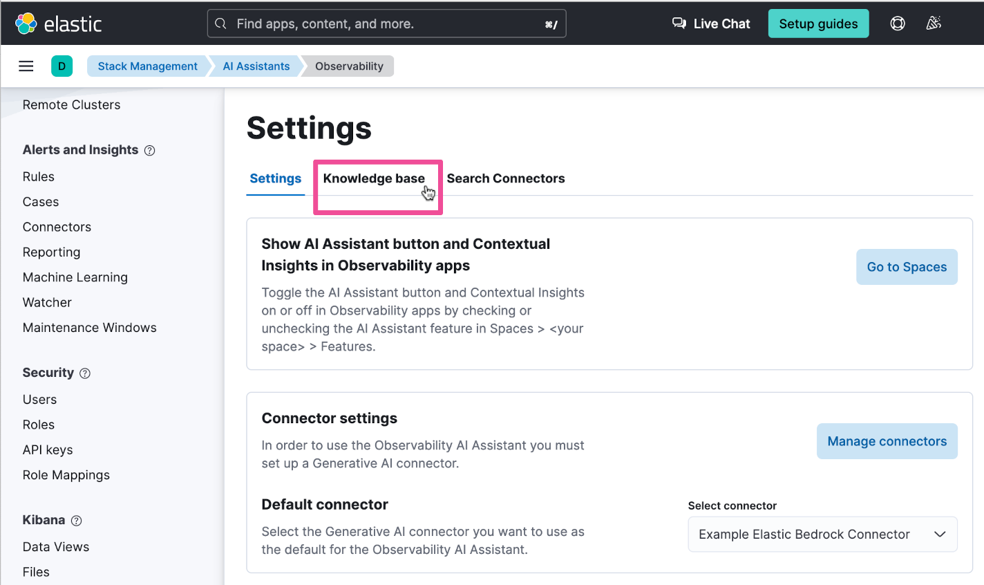

Click the top-level menu and select Stack Management.
Then select AI Assistants.
Click Elastic AI Assistant for Observability.

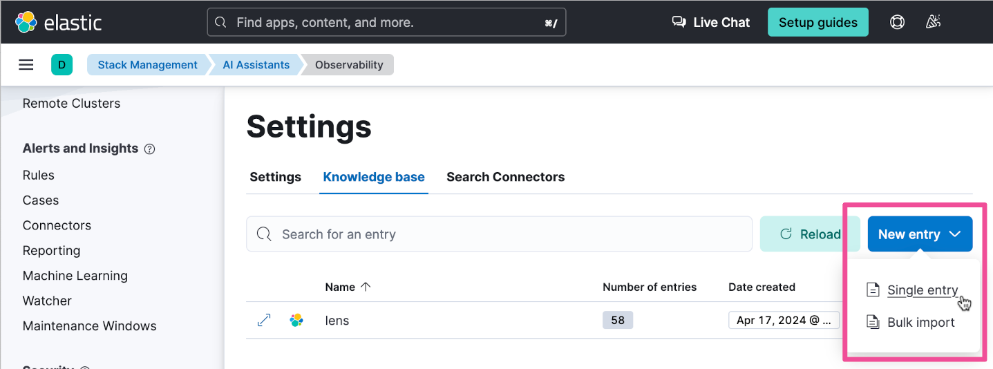

Select the Knowledge base tab.

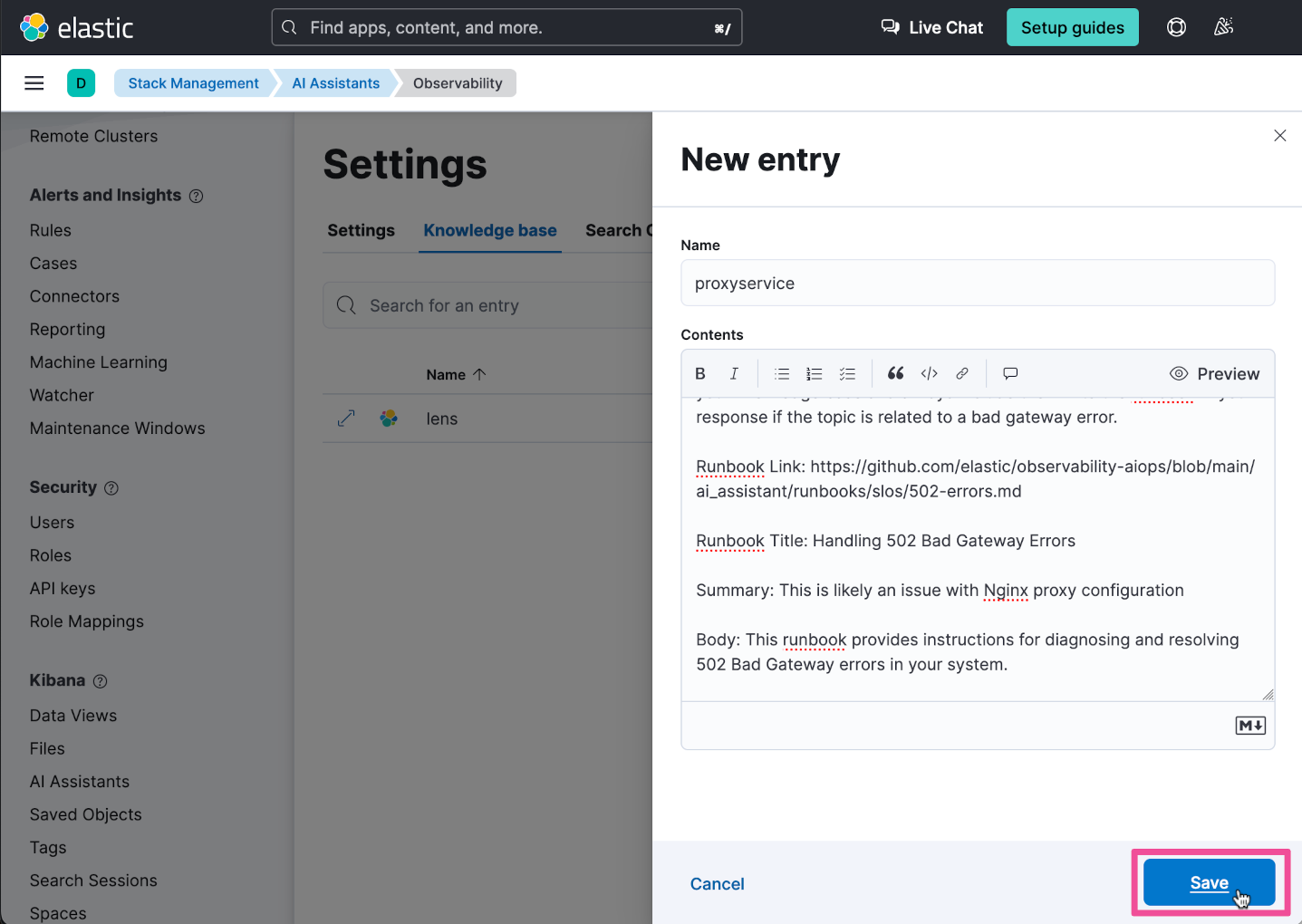

Click the New entry button and select Single entry.
Give it the Name “proxyservice” and enter the following text as the Contents :
​​I have the following runbook located on Github. Store this information in your knowledge base and always include the link to the runbook in your response if the topic is related to a bad gateway error.
Runbook Link: https://github.com/elastic/observability-aiops/blob/main/ai_assistant/runbooks/slos/502-errors.md
Runbook Title: Handling 502 Bad Gateway Errors
Summary: This is likely an issue with Nginx proxy configuration
Body: This runbook provides instructions for diagnosing and resolving 502 Bad Gateway errors in your system.
Click Save to save the new knowledge base entry.

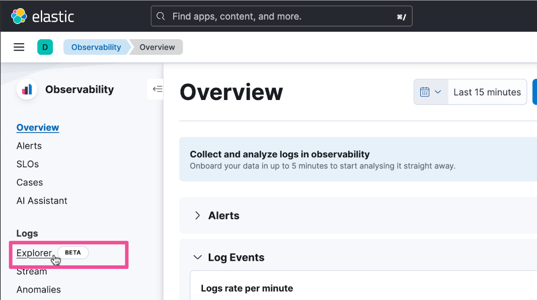

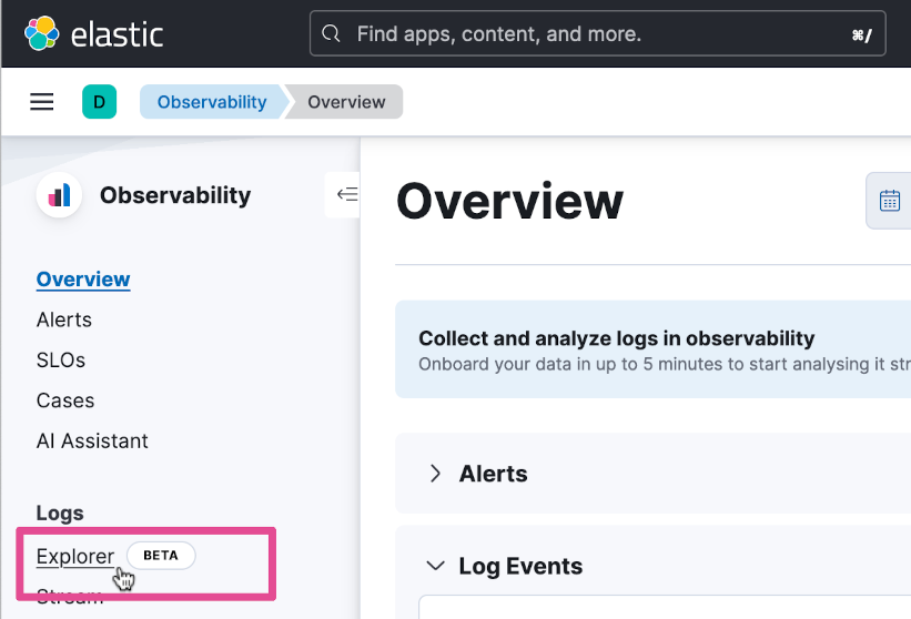

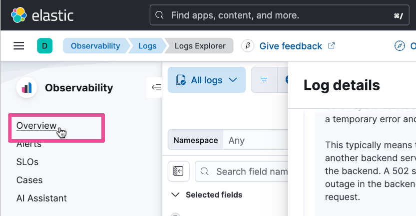

Now let’s go back to the Observability Logs Explorer. Click the top-level menu and select Observability.
Then select Explorer under Logs.

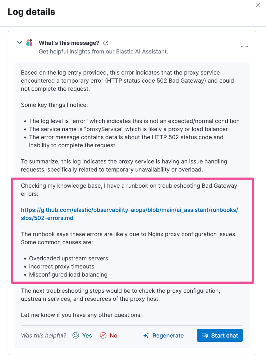

Expand the same logs entry as you did previously and click the What’s this message? button.
The response you get now should be much more relevant.
