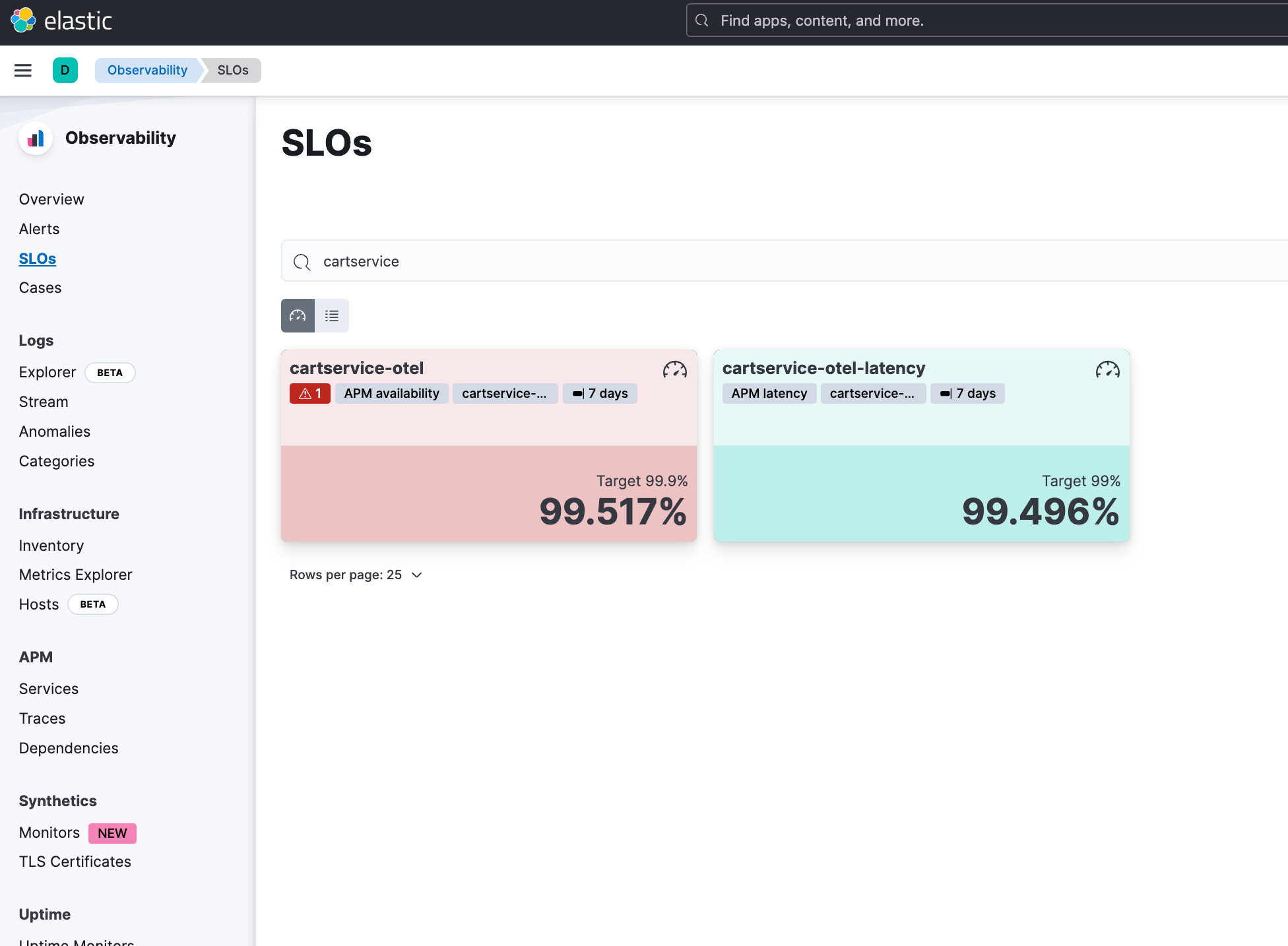

We set up two SLOs for cart service:

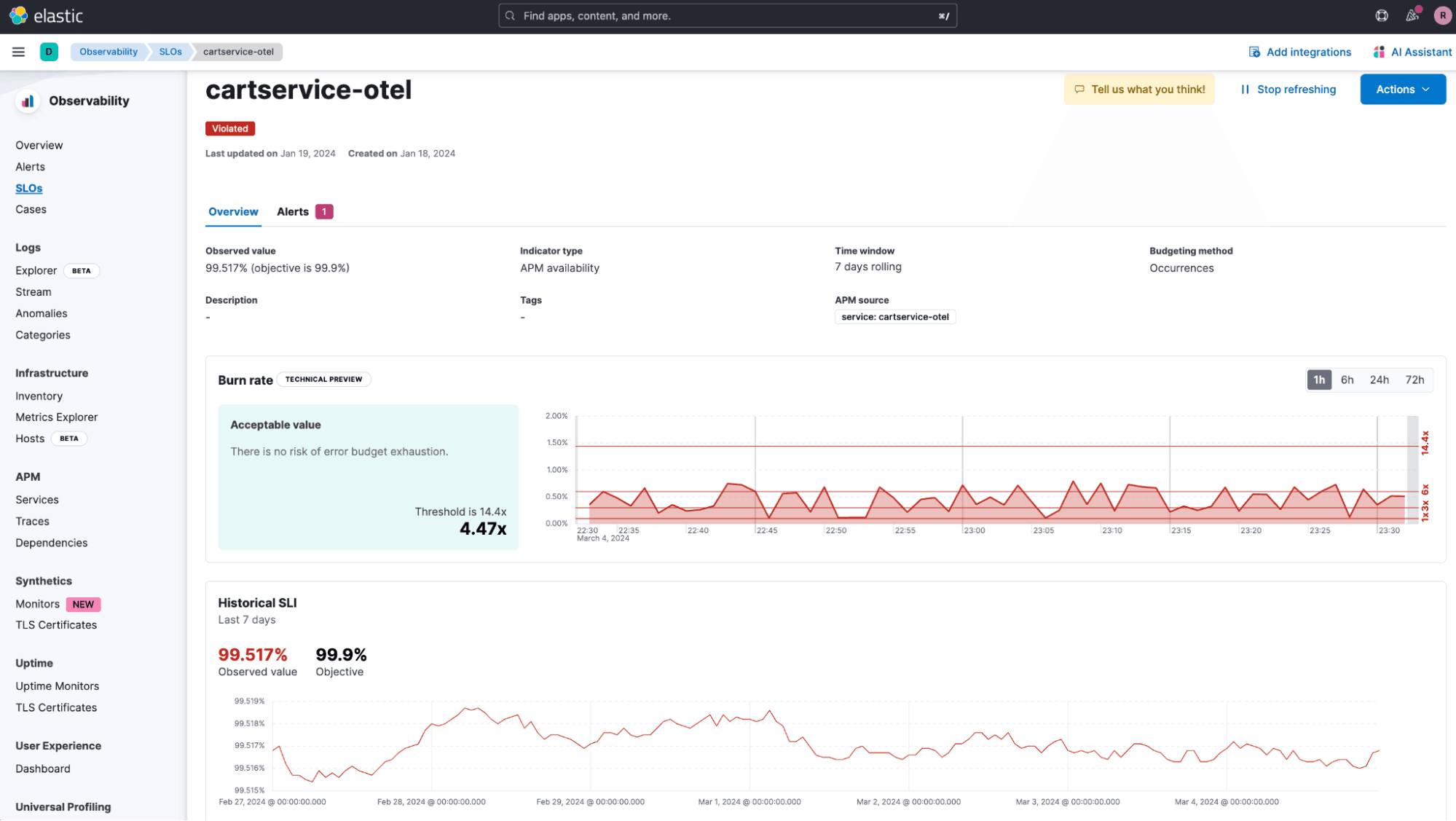

  • Availability SLO , which monitors its availability by ensuring that transactions succeed. We set up the feature flag in the OpenTelemetry application, which generates an error for EmptyCart transactions 10% of the time.
  • Latency SLO to ensure transactions are not going below a specific latency, which will reduce customer experiences.
Because of the OTel cartservice feature flag, the availability SLO is triggered, and within the SLO details, we see that over a seven-day period the availability is well below our target of 99.9, at 95.5. Additionally all the error budget that was available is also exhausted.
With SLO, you can easily identify when issues with customer experience occur, or when potential issues with services arise before they become potentially worse.
