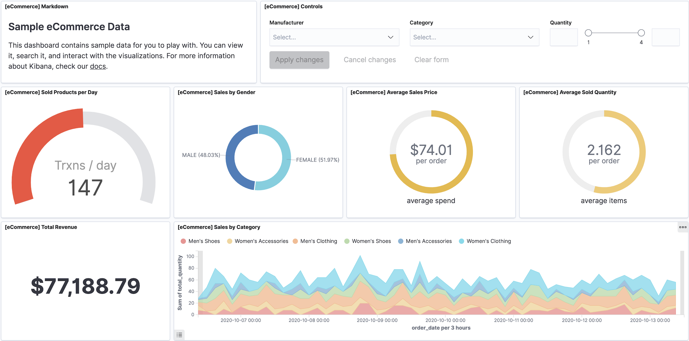

The best way to understand your data is to visualize it. With dashboards, you can turn your data from one or more index patterns into a collection of panels that bring clarity to your data, tell a story about your data, and allow you to focus on only the data that’s important to you.
Panels display your data in charts, tables, maps, and more, which allow you to compare your data side-by-side to identify patterns and connections. Dashboards support several editors you can use to create panels, and support many types of panels to display your data.
Use the Lens, TSVB, Vega, and Timelion editors to create visualizations of your data, or create Aggregation based visualizations using Elasticsearch aggregations. Lens is the recommended editor. |

To provide context to your dashboard panels, add Text panels that display important information, instructions, images, and more.
You create Text panels using GitHub-flavored Markdown text. For information about GitHub-flavored Markdown text, click Help.
- From the dashboard, click All types, then select Text.
- In the Markdown field, enter the text, then click Update.
For example, when you enter:
The following instructions are displayed:
Or when you enter:
The following image is displayed:

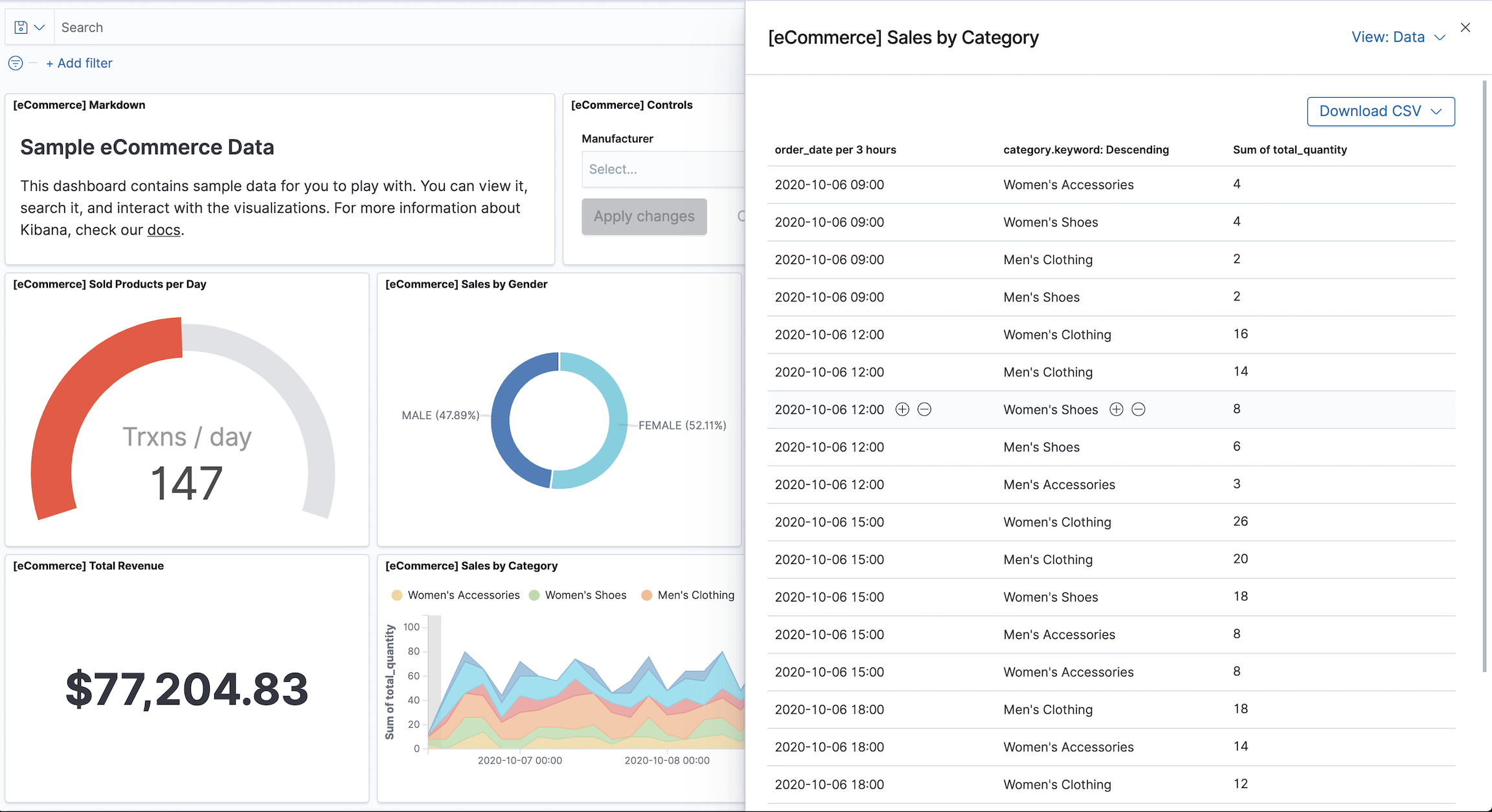

Download panel dataedit
Download panel data in a CSV file. You can download most panels in a CSV file, but there is a shortcut available for Lens panels.
Download Lens dataedit
When you download Lens panel data, each layer produces a single CSV file with columns. When you download multiple layers, the file names combine the visualization and layer index names.
- Open the Lens panel menu
- Select More > Download as CSV.
Download all other panel dataedit
Download the data for non-Lens panels.
- Open the panel menu, then select Inspect.
Click Download CSV, then select the CSV type from the dropdown:
- Formatted CSV — Contains human-readable dates and numbers.
Unformatted — Best used for computer use.
Lens panels do not support Inspect.
