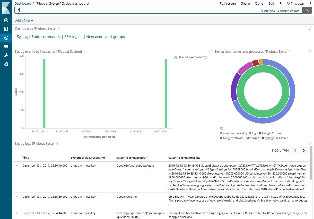

After you’ve confirmed that Filebeat is sending events to Elasticsearch, launch the Kibana web interface by pointing your browser to port 5601. For example, http://127.0.0.1:5601.
Open the dashboard and explore the visualizations for your parsed logs.
Here’s an example of the syslog dashboard:
