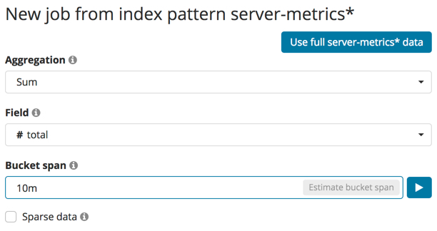

  6. Configure the job by providing the following information:
    Create a new job from the server-metrics index
    1. For the Aggregation, select Sum. This value specifies the analysis function that is used.
      Some of the analytical functions look for single anomalous data points. For example, max identifies the maximum value that is seen within a bucket. Others perform some aggregation over the length of the bucket. For example, mean calculates the mean of all the data points seen within the bucket. Similarly, count calculates the total number of data points within the bucket. In this tutorial, you are using the sum function, which calculates the sum of the specified field’s values within the bucket. For descriptions of all the functions, see Function Reference.
    2. For the Field, select total. This value specifies the field that the detector uses in the function.
      Some functions such as count and rare do not require fields.
    3. For the Bucket span, enter 10m. This value specifies the size of the interval that the analysis is aggregated into.
      The X-Pack machine learning features use the concept of a bucket to divide up the time series into batches for processing. For example, if you are monitoring the total number of requests in the system, using a bucket span of 1 hour would mean that at the end of each hour, it calculates the sum of the requests for the last hour and computes the anomalousness of that value compared to previous hours.
      The bucket span has two purposes: it dictates over what time span to look for anomalous features in data, and also determines how quickly anomalies can be detected. Choosing a shorter bucket span enables anomalies to be detected more quickly. However, there is a risk of being too sensitive to natural variations or noise in the input data. Choosing too long a bucket span can mean that interesting anomalies are averaged away. There is also the possibility that the aggregation might smooth out some anomalies based on when the bucket starts in time.
      The bucket span has a significant impact on the analysis. When you’re trying to determine what value to use, take into account the granularity at which you want to perform the analysis, the frequency of the input data, the duration of typical anomalies, and the frequency at which alerting is required.

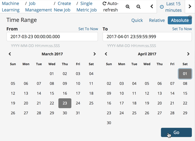

  7. Determine whether you want to process all of the data or only part of it. If you want to analyze all of the existing data, click Use full server-metrics* data. If you want to see what happens when you stop and start datafeeds and process additional data over time, click the time picker in the Kibana toolbar. Since the sample data spans a period of time between March 23, 2017 and April 22, 2017, click Absolute. Set the start time to March 23, 2017 and the end time to April 1, 2017, for example. Once you’ve got the time range set up, click the Go button.
    Setting the time range for the datafeed

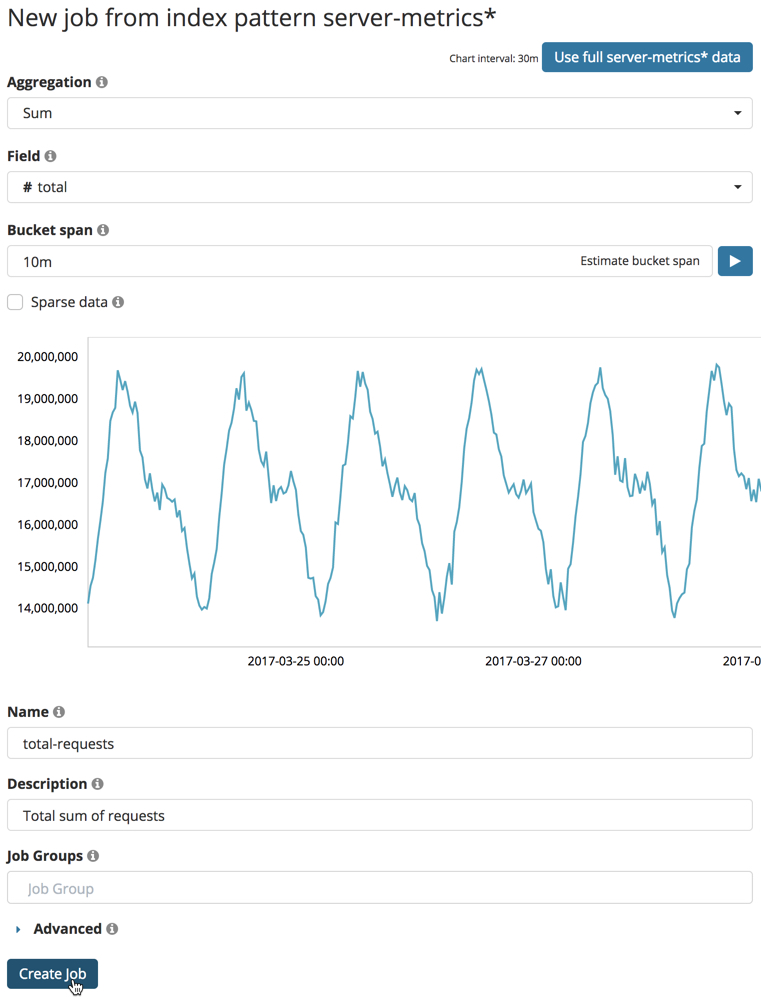

    A graph is generated, which represents the total number of requests over time.
    Note that the Estimate bucket span option is no longer greyed out in the Buck span field. This is an experimental feature that you can use to help determine an appropriate bucket span for your data. For the purposes of this tutorial, we will leave the bucket span at 10 minutes.
  8. Provide a name for the job, for example total-requests. The job name must be unique in your cluster. You can also optionally provide a description of the job and create a job group.
  9. Click Create Job.
    A graph of the total number of requests over time
As the job is created, the graph is updated to give a visual representation of the progress of machine learning as the data is processed. This view is only available whilst the job is running.
