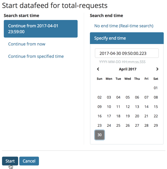

Managing Datafeeds
editA datafeed can be started and stopped multiple times throughout its lifecycle. If you want to retrieve more data from Elasticsearch and the datafeed is stopped, you must restart it.
For example, if you did not use the full data when you created the job, you can now process the remaining data by restarting the datafeed:
In the Machine Learning / Job Management tab, click the following
button to start the datafeed:
Choose a start time and end time. For example, click Continue from 2017-04-01 23:59:00 and select 2017-04-30 as the search end time. Then click Start. The date picker defaults to the latest timestamp of processed data. Be careful not to leave any gaps in the analysis, otherwise you might miss anomalies.
The datafeed state changes to started, the job state changes to opened,
and the number of processed records increases as the new data is analyzed. The
latest timestamp information also increases.
If your data is being loaded continuously, you can continue running the job in real time. For this, start your datafeed and select No end time.
